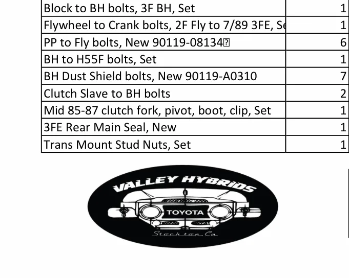

More 5 speed stuff aqquired. Updates soon.

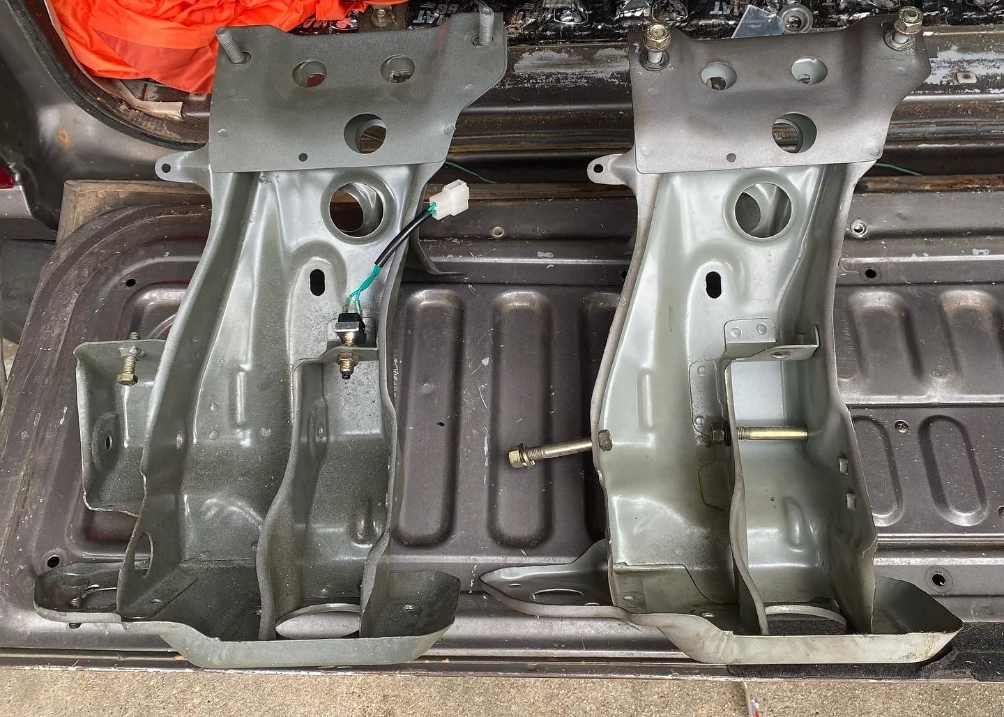

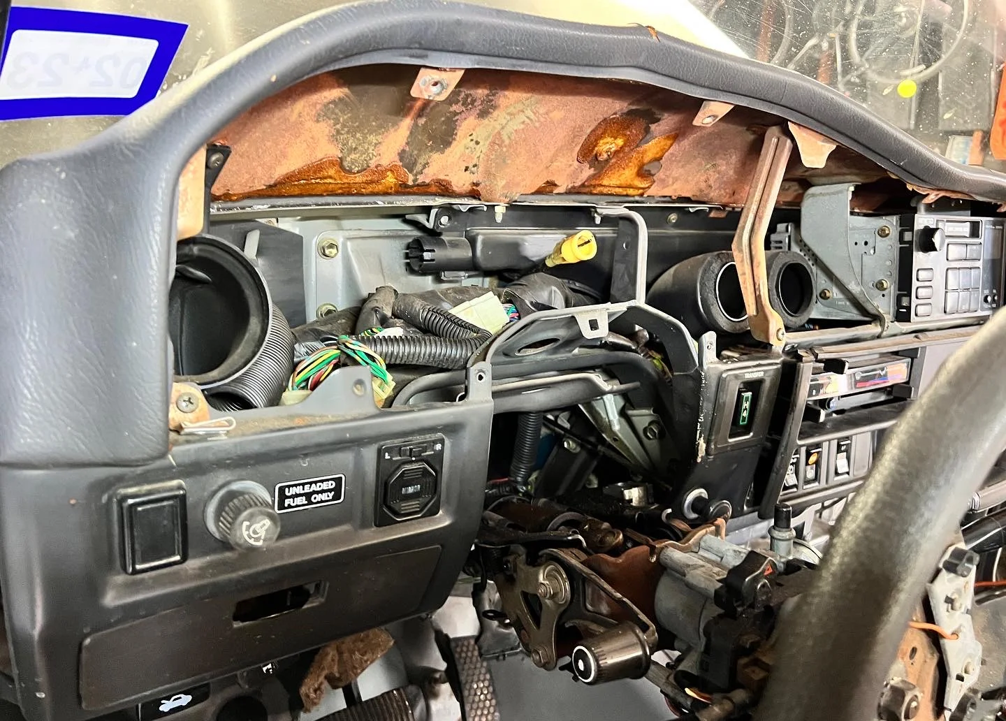

Pedal box is in. Couldn’t have done it without @FJ62DadWagon
Also figured out why my tune and exhaust leak are completely related. More on that later.
Nice, that step is a treat. It's still all uphill from here. :hillbilly: :flipoff2:

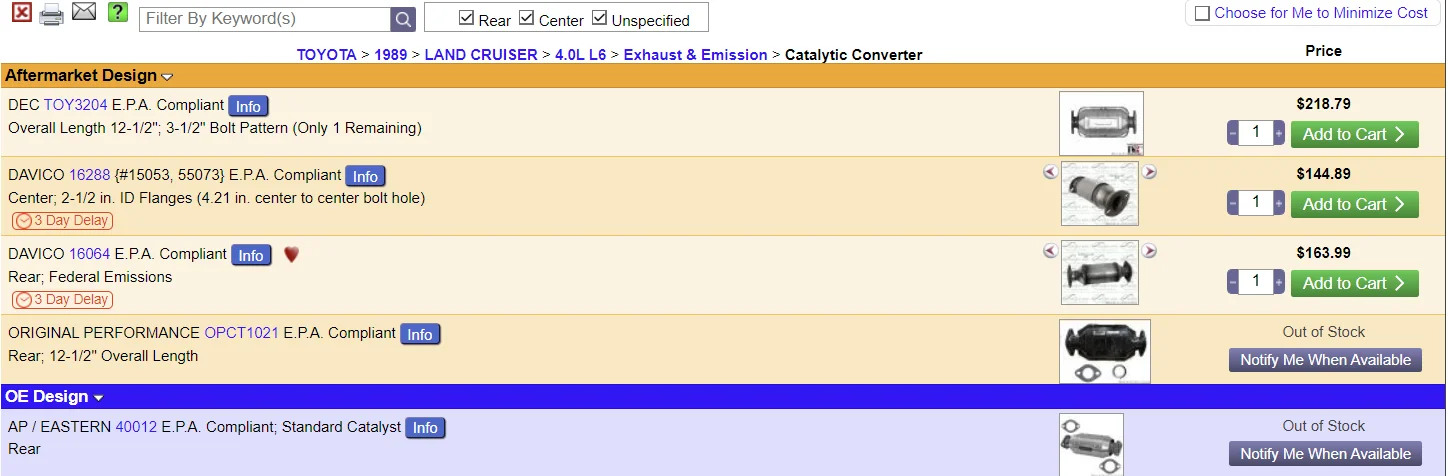

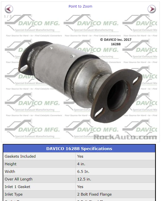

This is my wifes truck, not mine. We want max efficiency, improved drivability and zero smell from it. I went on rock auto and ordered two catalytic converters for it. I measured both catalytic converters and they are both 12.5 inches long. This means they are identical side to side. The Toyota EPC says they are both the same size, so this conflicted what I read on rockauto. They list two locations and one has a slightly different length.
I went with two of the Davico 16288 units. A bit over $300 to my door. Currently waiting for them to ship.
I thought long and hard about just making up test pipes, but to get the correct flanges was a pain. I was going to be easily $50 into each test pipe and it would likely smell like my 60 does with no converter. That wouldn't do. My hopes for the replacement of the converters is to balance the flow between both manifolds, reduce heat on the floor board since they have their own heatshield built in and keep the smell down.

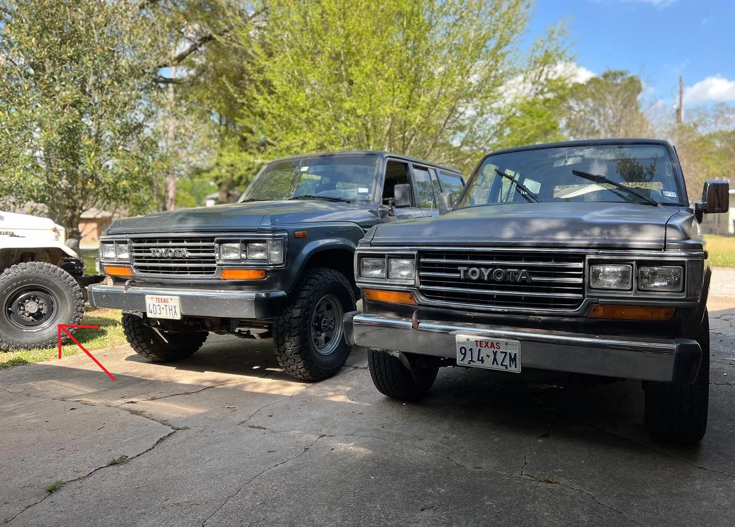

Stock 40 Steelies. Nothing special. 33x10.5’s.
He also had a set of aluminum 16x6 Fj company wheels with 285’s floating between both trucks.
