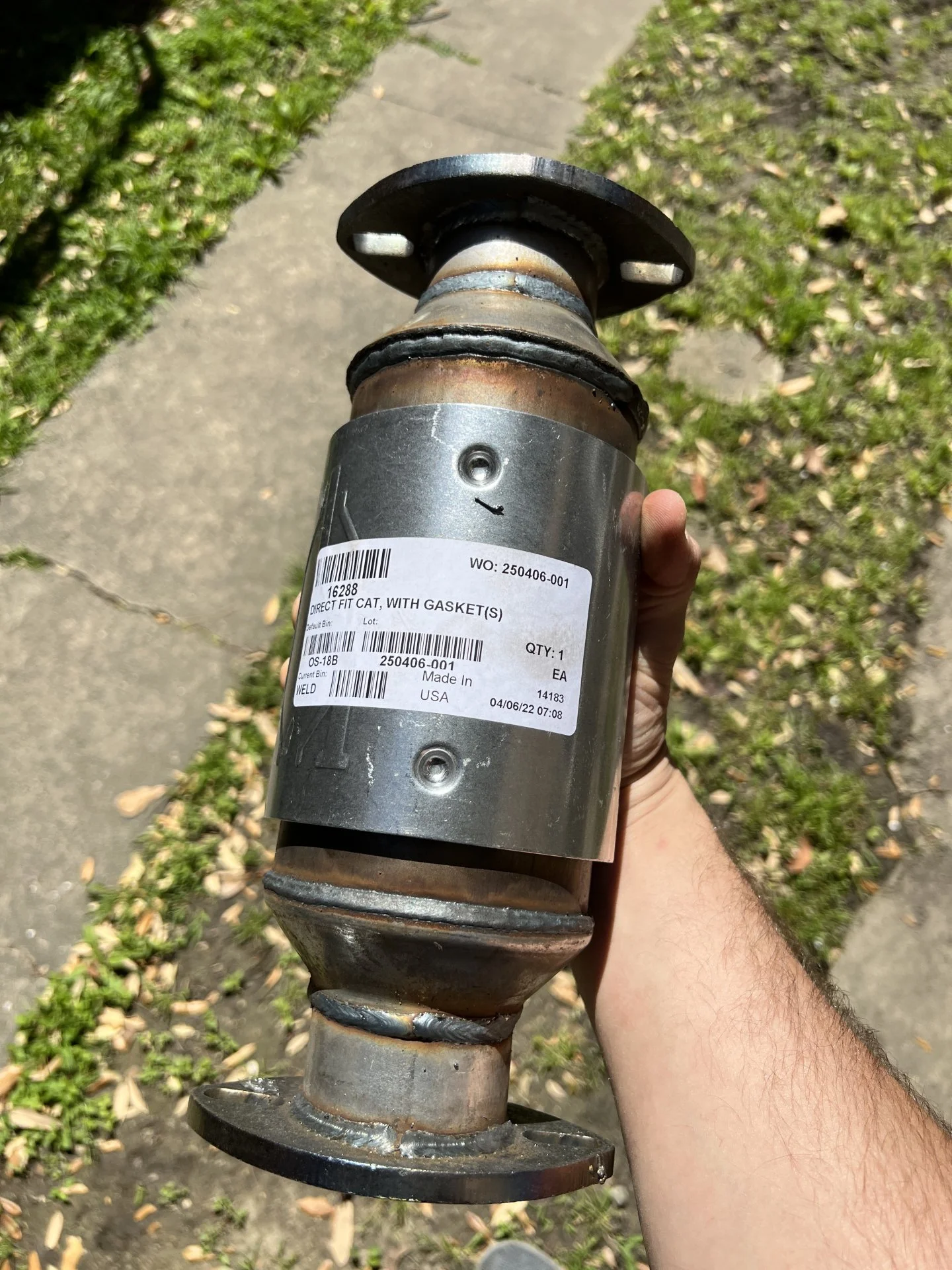

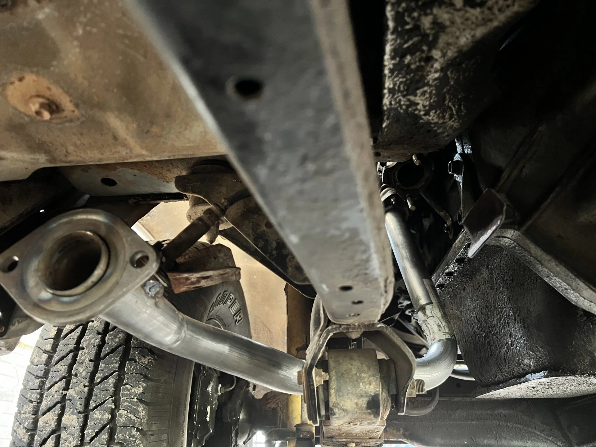

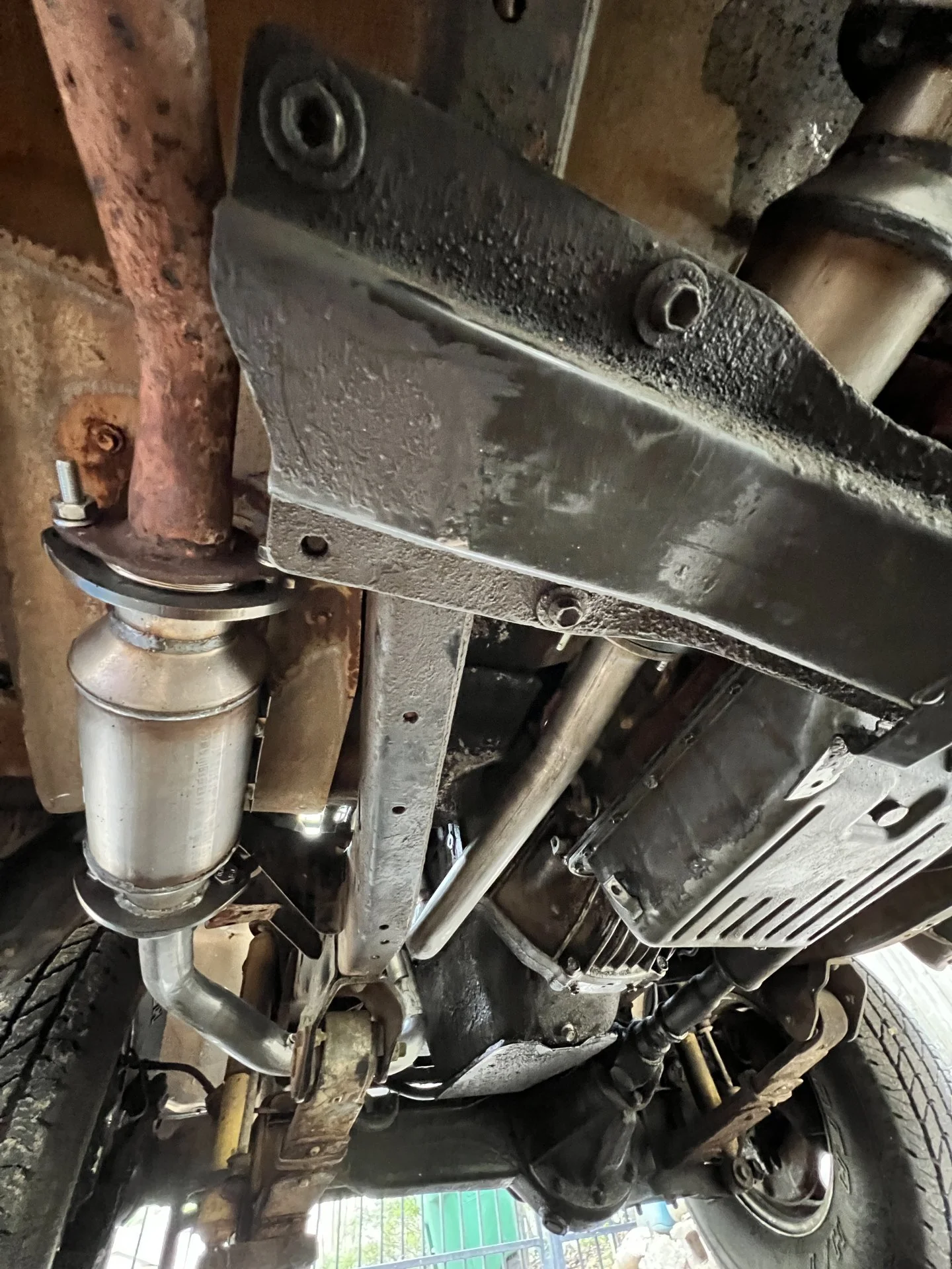

Tomorrow will be a day of grinding bolts off non stop.
I expect all 8 catalytic converter bolts to have to be cut off one by one. They’re all corroded.
None of that went as expected.
I thought I could just grind and cut down the bolt heads on all 8 catalytic converter bolts.
No luck. In scoring the bolts off I sliced into a head pipe with the grinder. Just went ahead and replaced the head pipes. Getting exhaust manifold bolts off was a pain, and trying to preserve the heat shield bolts on the oxygen sensors was hard.
All of the mounts and hangers for the head pipes were broken. I think fixing this stuff will a ton of rattles.

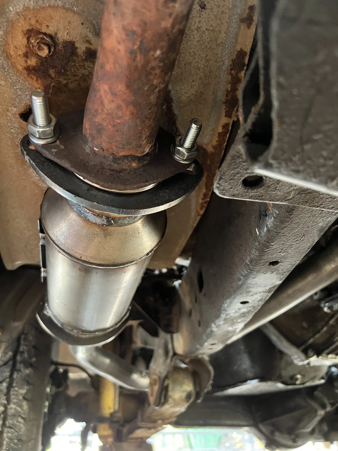

The outer head pipe is fixed and ready for the cat. The inner will be done tomorrow morning.
All done!
I had to use hardware store bolts, but it’s all tighter and leak free going to the stock y pipe.

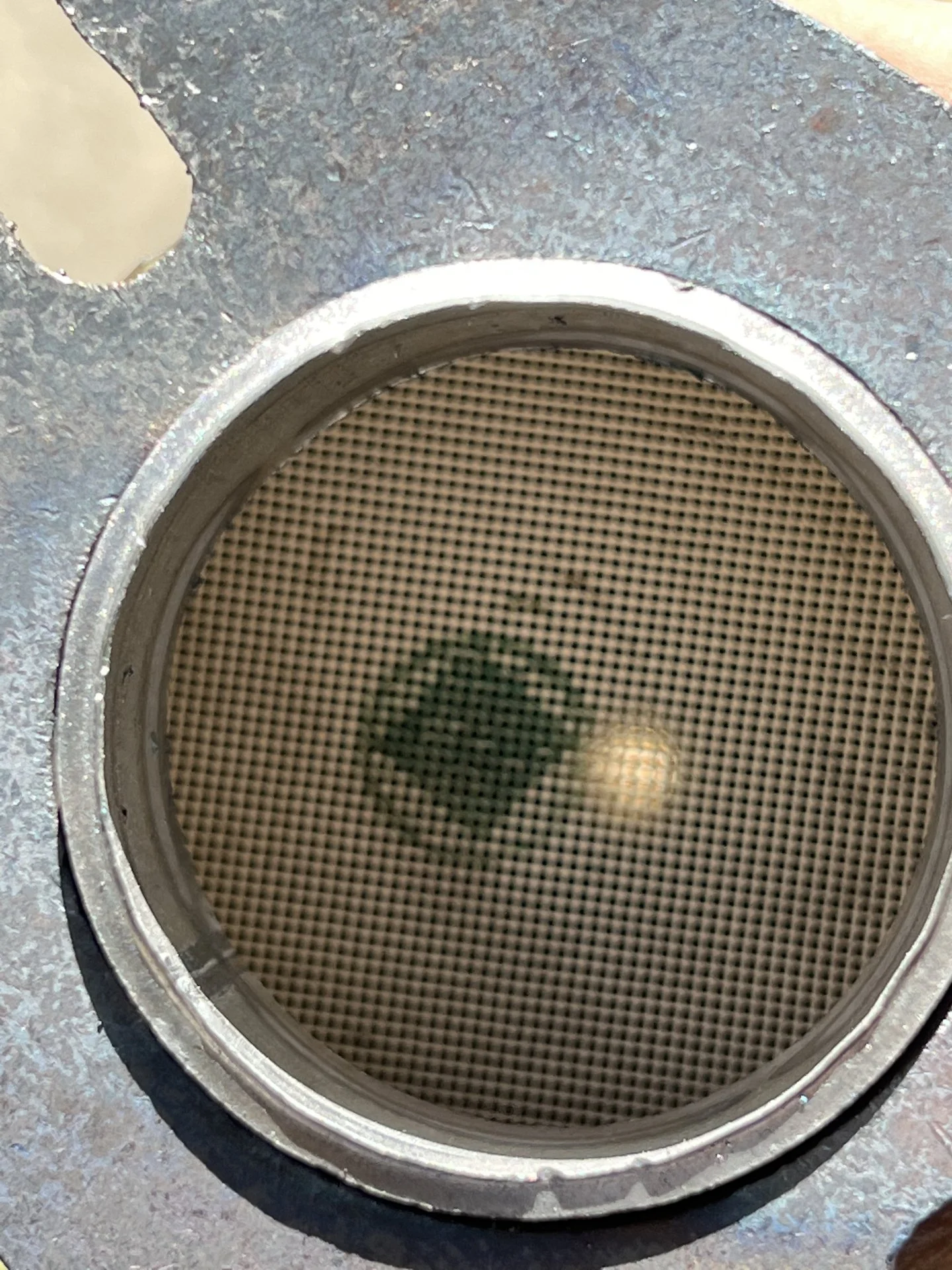

It’s running so much smoother. It finally settled into a 650rpm idle and doesn’t shake any more due to the blocked cat.
I’ll test drive it and let it cool then tighten it all back up.

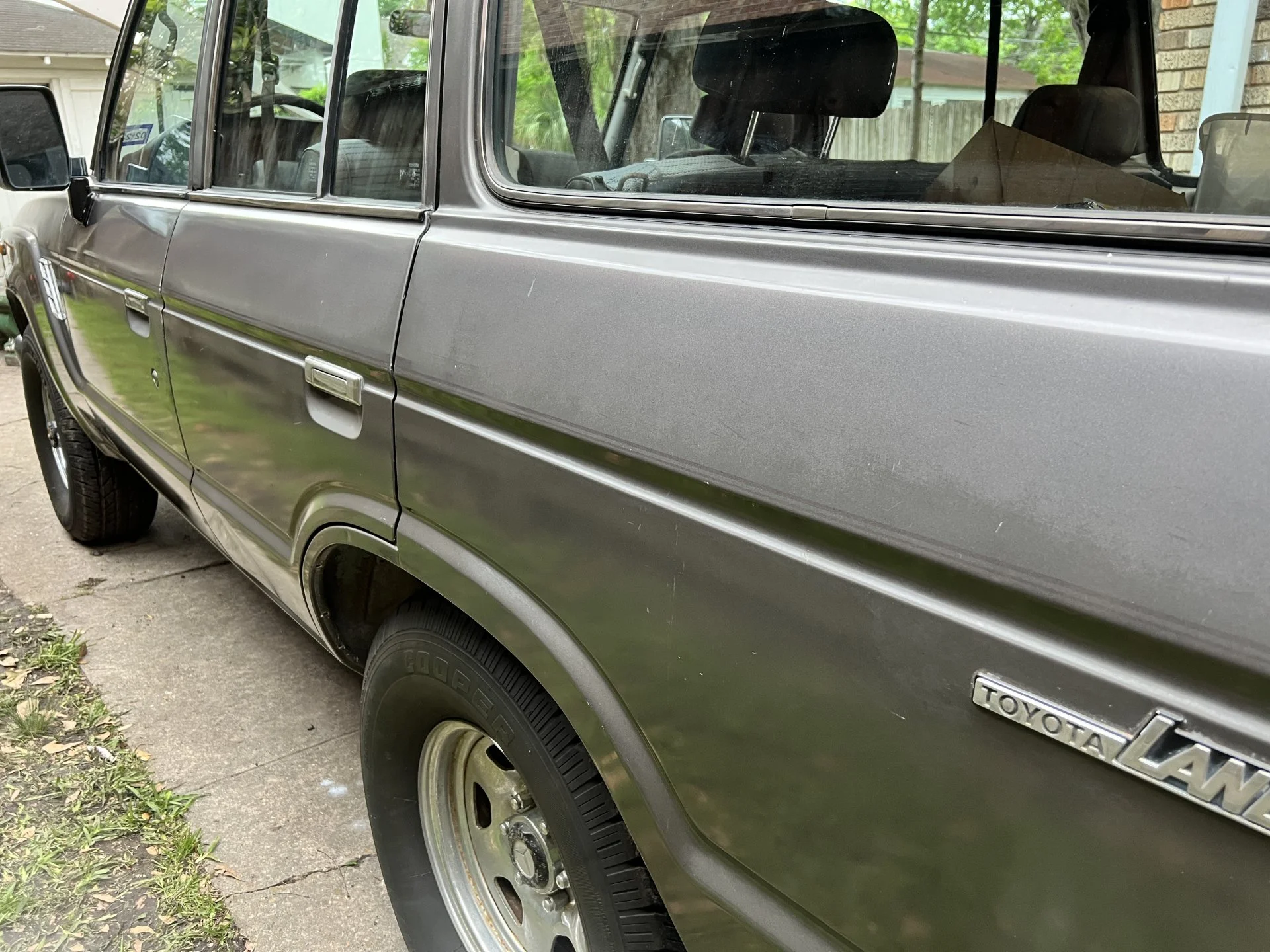

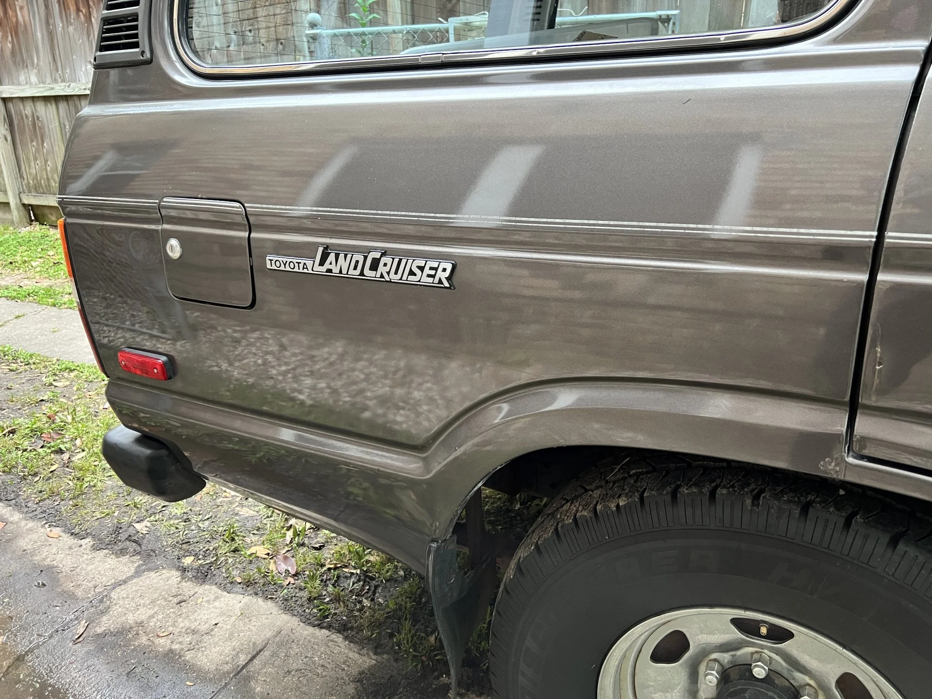

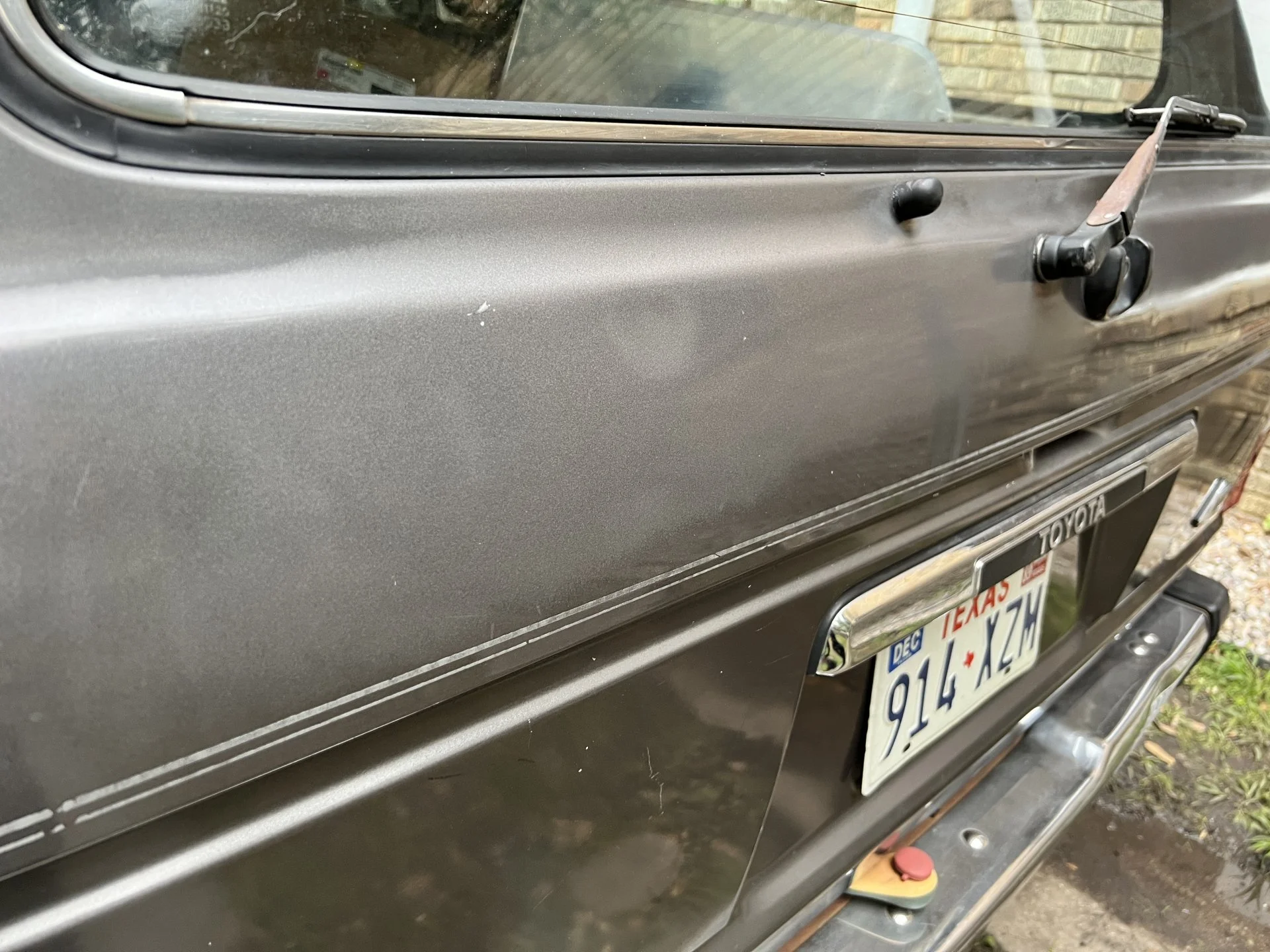

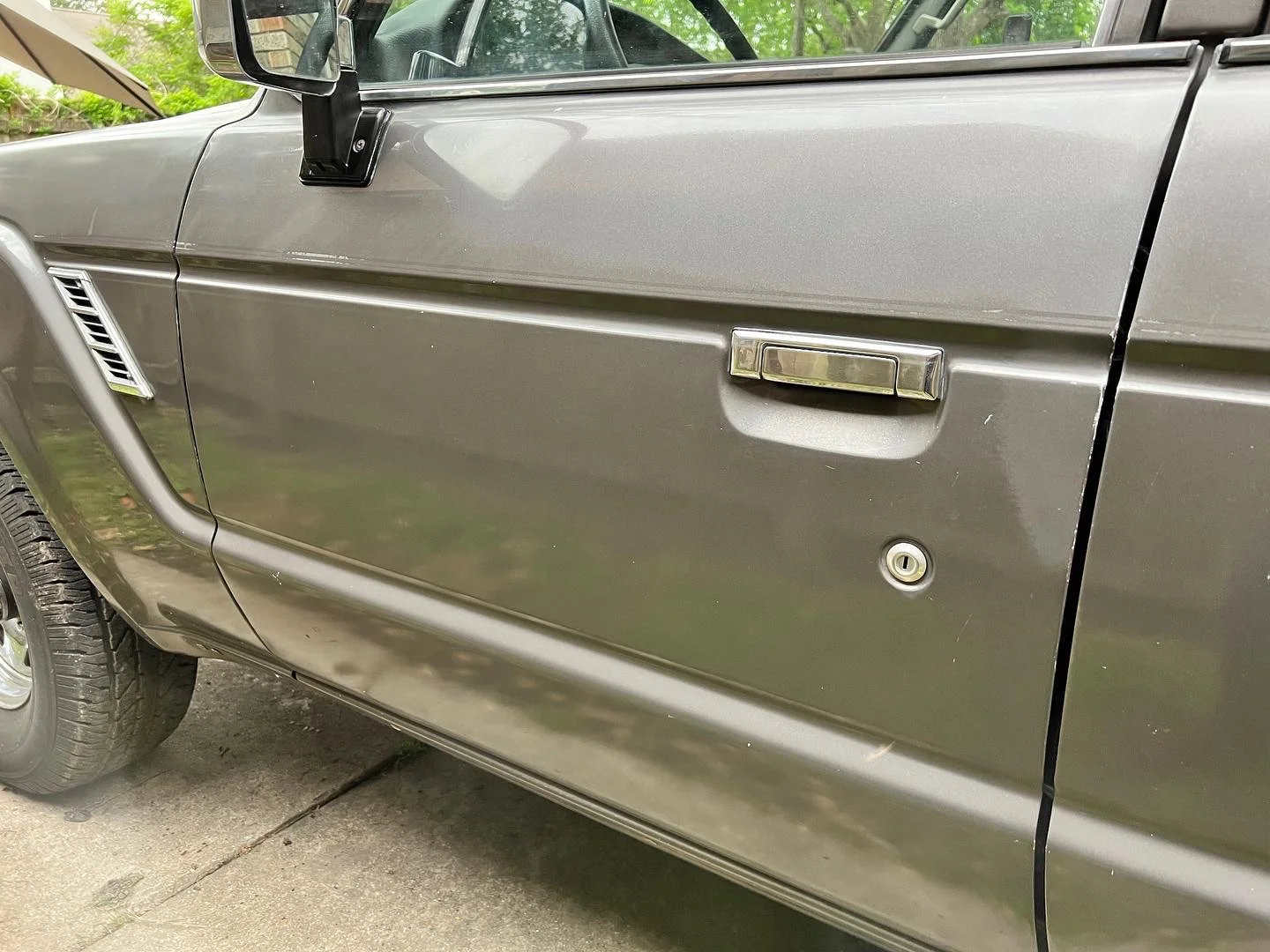

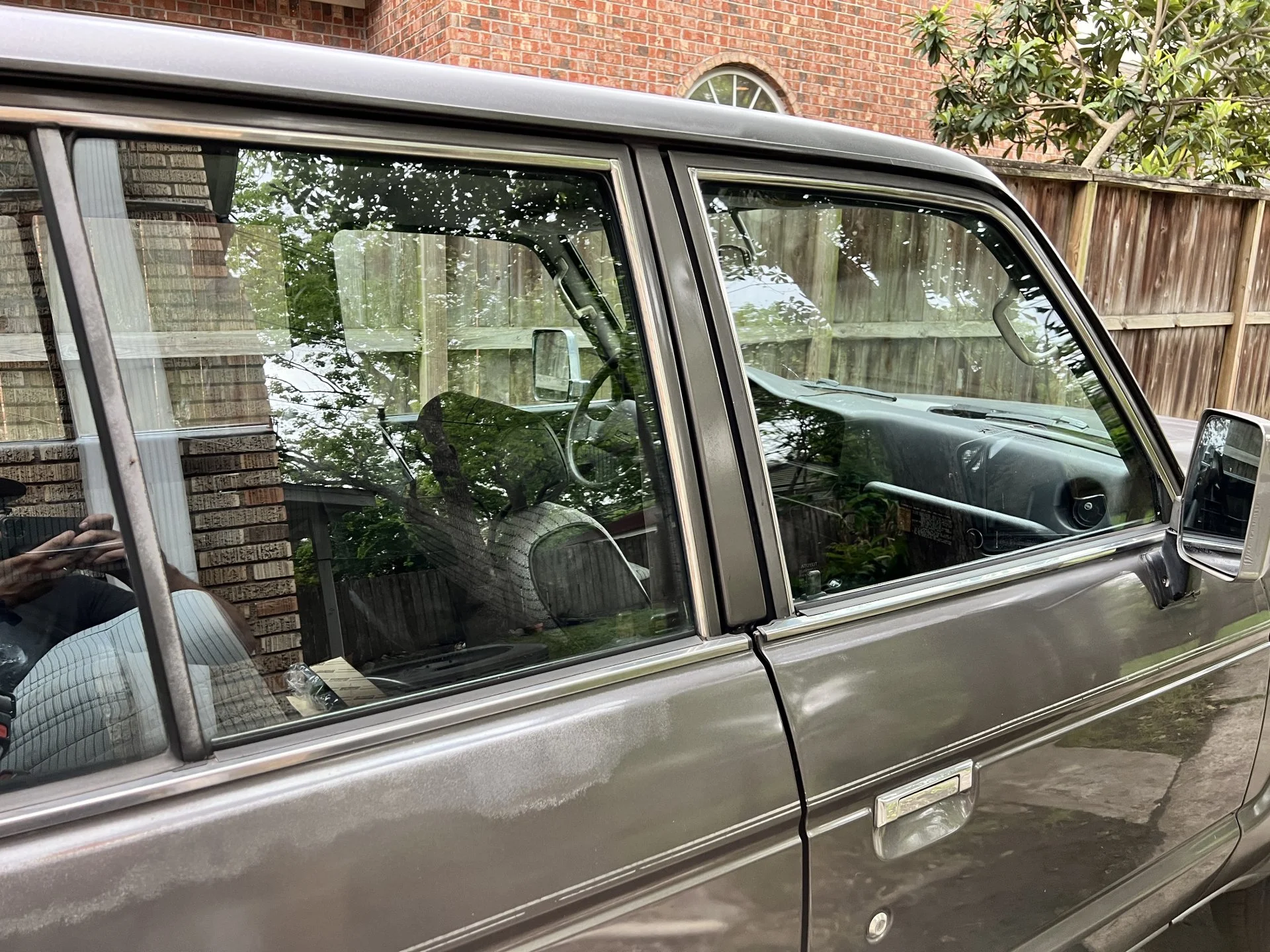

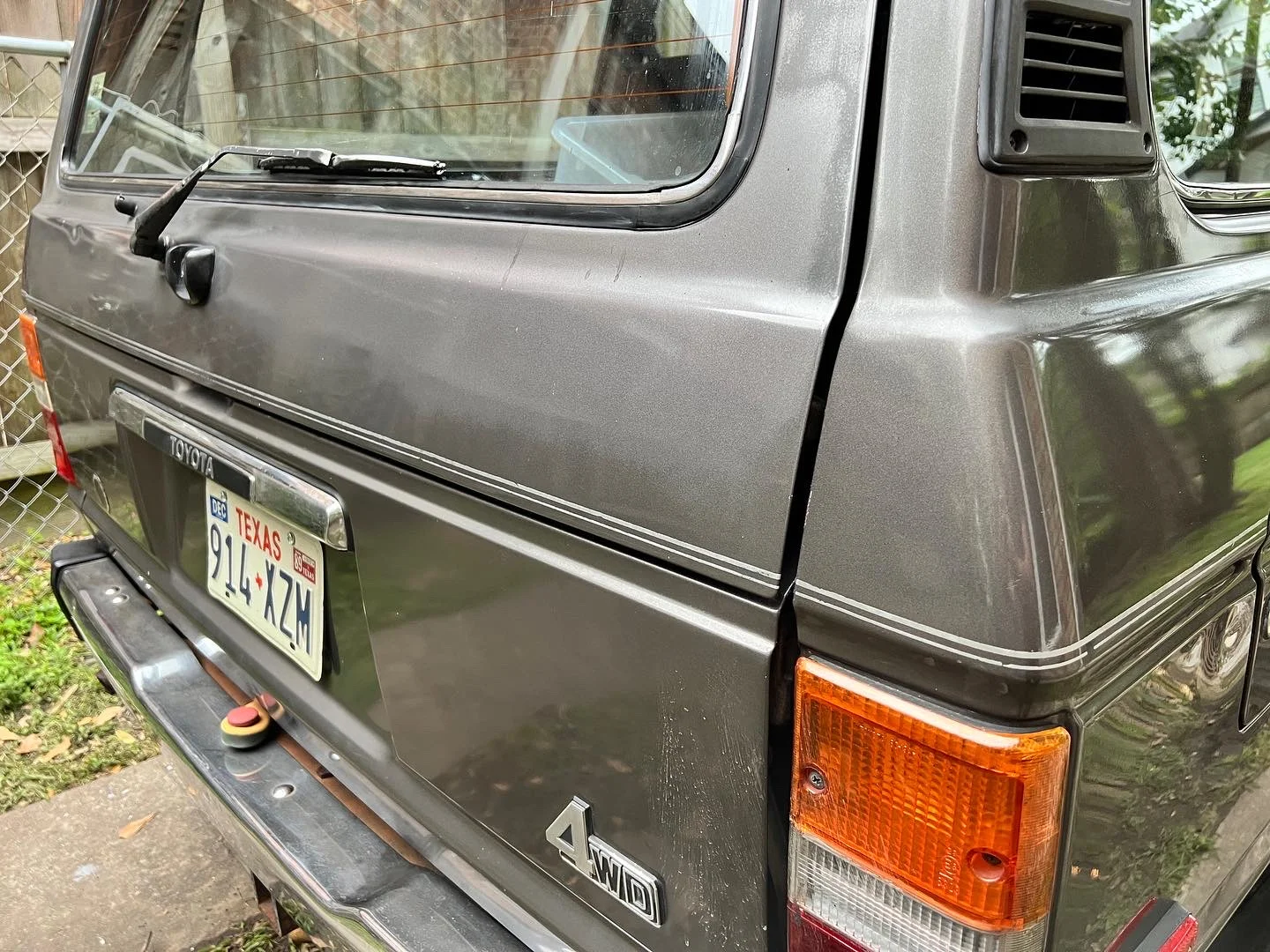

I’m calling the detail of grey gardens done. I can’t spend any more time on it, but it really needs another half day to get the last of the oxidation off.
Good enough for now. This is a lot of work. I see why people charge thousands of dollars for paint correction.
There’s a little haze on the rear and drivers side upper panels. An orange pad and v38 seems to work well.
It’s light years better than it was before. I don’t want to paint this truck, it’s got a lot of character to preserve.
