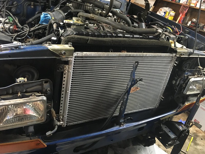

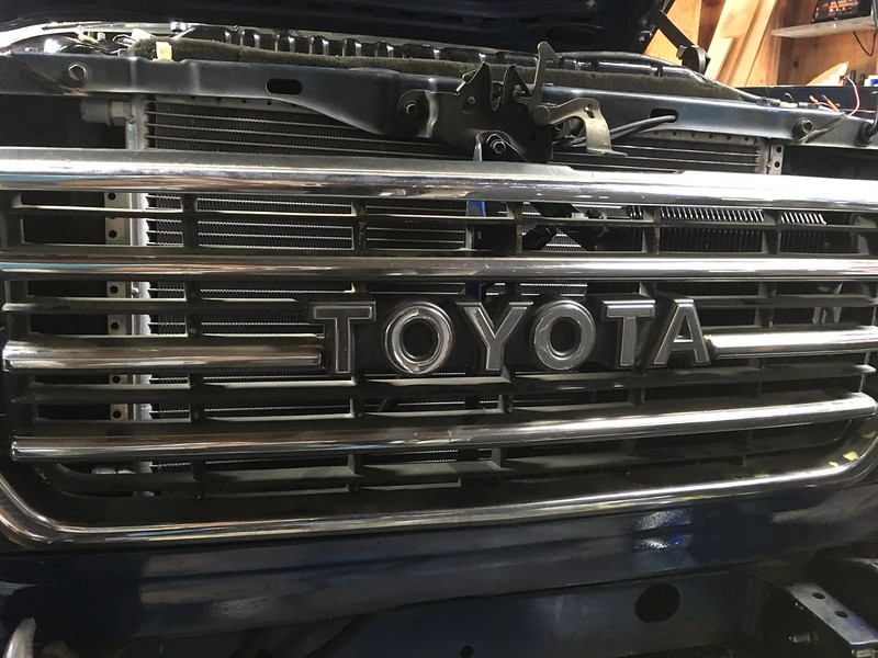

New parallel flow condenser in, coolant and tranny fluid hoses hooked back up, belts tensioned, and slew of wires and small hoses all in there place. Its Alive!!!!..... again! hahaha. Nothing caught on fire, blew up or leaked so far so I will consider this a success so far... :rolleyes:
The condenser was mounted using custom little brackets (a 6 year old could make, and it looks like one did) that use the factory isolator cushions and mount locations. The long bolts in the pictures were changed later
Time to put some miles on this behemoth. :steer:
Hoping to get the new AC lines made in the next two days.

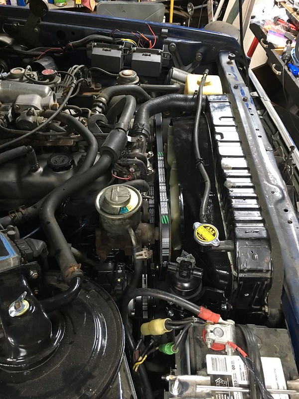

Well I finally got to drive the beast! It made it on a 10mile loop around Seattle. AC lines are being made as we speak by a shop that knows what they are doing. Discovered a coolant leak when I got to the hose fitting place, luckily it was just a loose hose clamp. Then I discovered I was leaking transmission fluid from the radiator fitting. I was able to get back to work ok and then home (I already had a few bottles of ATF in the cruiser just in case). Then when I got home I discovered I am getting some brake fluid weeping from the fittings at the master cylinder! One step forward, two steps back.
Hopefully the brake fittings just need to be cleaned up and not need replacing. Transmission fluid leak should be easy to fix. Almost there.
I am happy to report though that it was a blast to drive. Coolant temps stayed between the 1/4 and 1/2 marks. Engine seemed responsive and it handled fantastic (thanks @reevesci ). I can't believe how much this cruiser has changed since I first got working on it. The steering system actually tells the cruiser which direction to go now! hahahaha

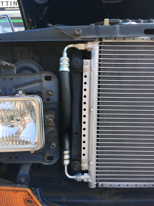

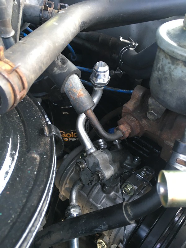

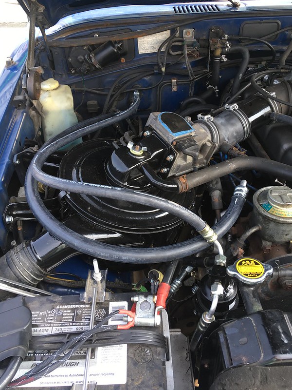

Got the lines made up today! Huge thanks to Bruce at Nebar Hose and Fittings in Ballard. Guy was awesome and did a fantastic job making the new lines and custom fittings.
New fittings welded onto the old proprietary Toyota fittings:
Need to tweak the routing on the top little line a little to better follow the factory routing. Now its time to charge it up and see how it all works
Happy to report nothing leaked on this round of driving. Not a drop! Teflon tape was added to the transmission cooler line fittings (thanks @Kleatus ) and the brake fittings were cleaned and no more weeping. Brakes seem better now too. Next step is to bolt the rear bench back in and go for a drive with the family :steer::D
