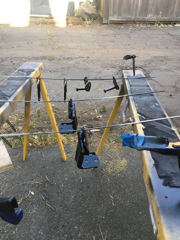

Every time I take something off the cruiser I try and put it back in better condition. This is sometimes a good thing and sometimes I probably should just not bother. This usually involves painting parts I will probably not see, or anyone will see, for a long time, and replacing rusty bolts with new OEM ones when I can find them. Some examples:

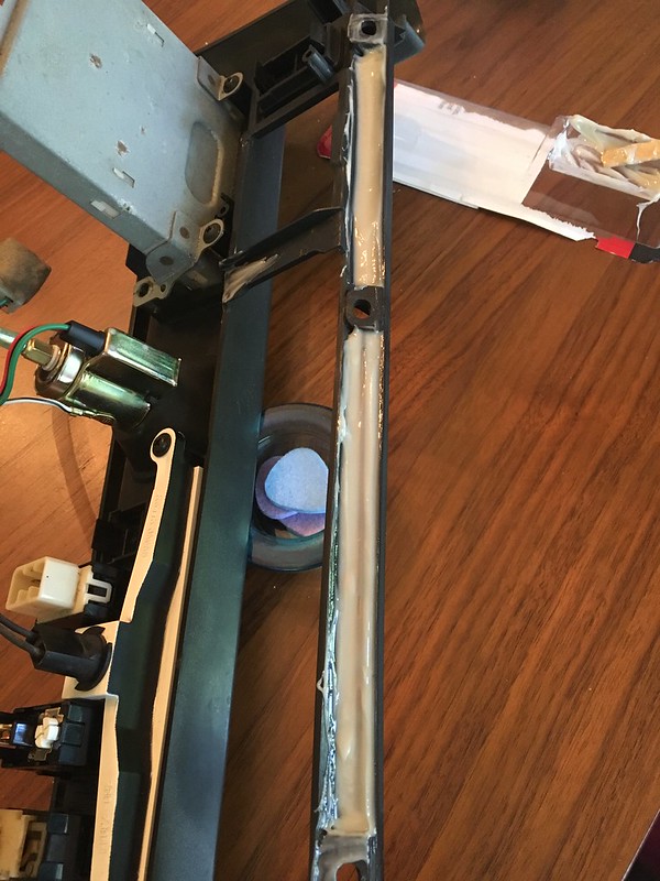

Epoxy and stainless steel rod reinforcement to strengthen the HVAC control trim:

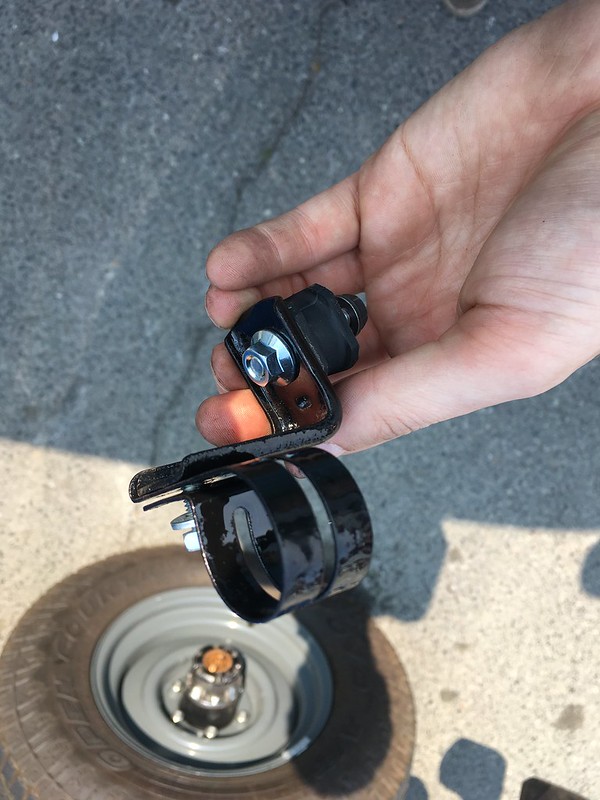

Painting and replacing the rubber isolator cushion and bolts for the AC line holder under the battery tray:

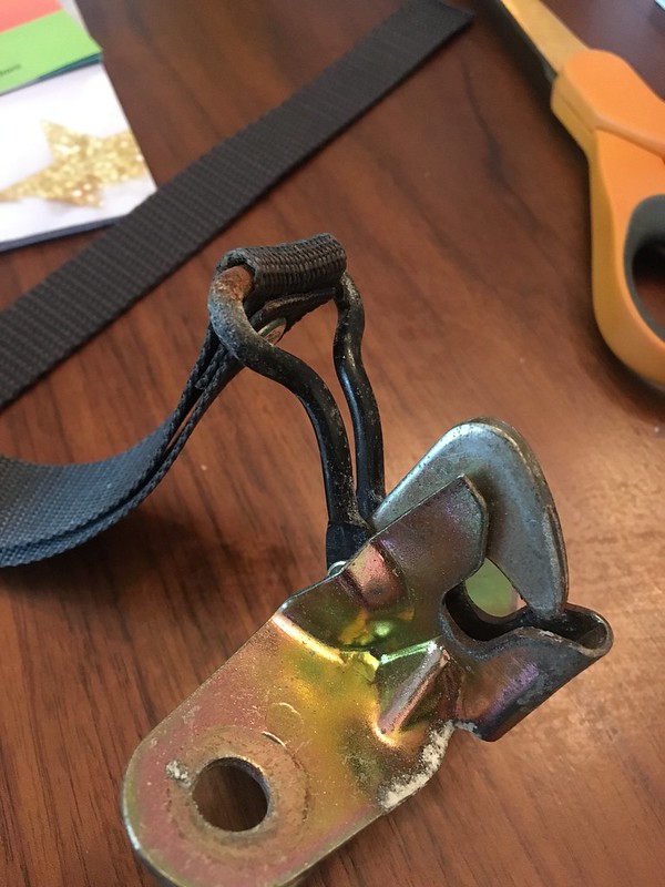

Painting the rear bench seat hardware and replacing the old strap on the release mechanism:

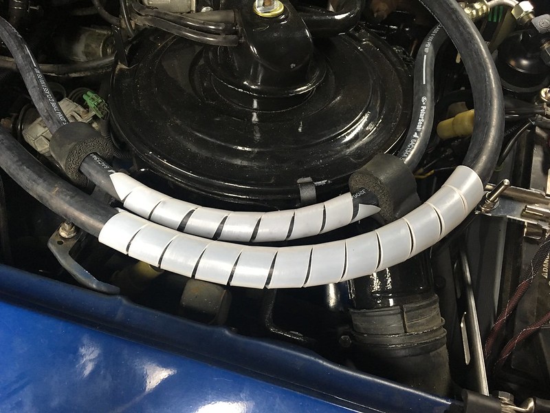

Found some protective hose wrap that matches the OEM style. A tad OCD sometimes. :rolleyes:

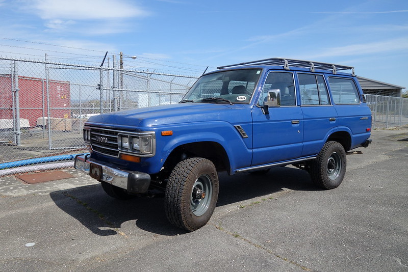

Took the cruiser to work today. 50ish miles of freeway and surface streets. Was waiting for it to explode or fall apart at any moment but thankfully it didn't come to that. It was a blast to drive. A few issues came up, engine codes 25 and 51, so I'll have to address those. The kick-down cable is also an issue but will be dealt with shortly.

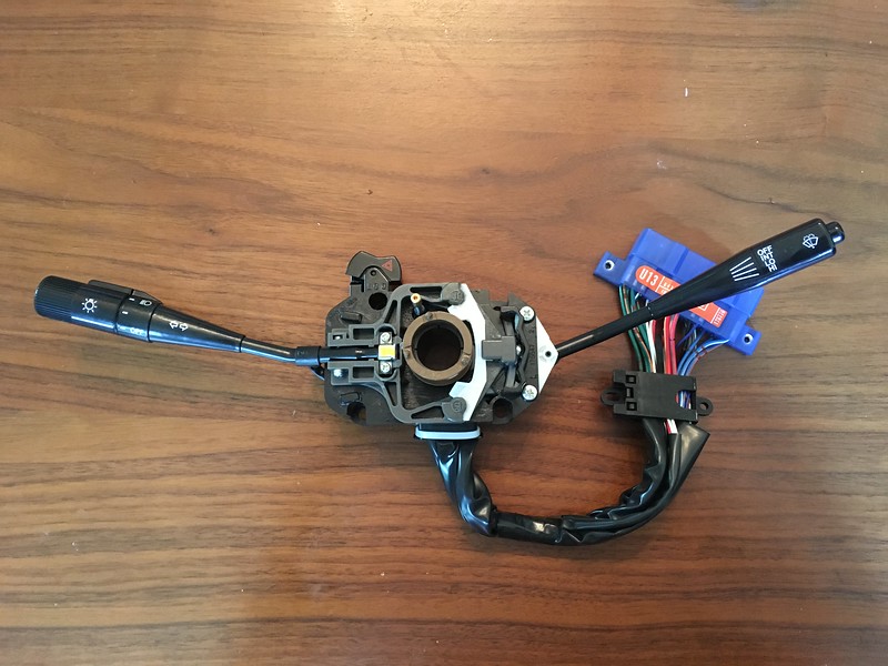

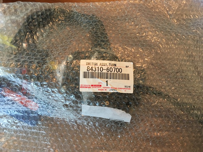

Chase failed to mention that on last Friday night I called him at 8pm that I was having trouble with my lights/turn signal indicator and he offered his current one up since he had one in his parts stash. I was supposed to leave that night on a trip for OR for the eclipse. Offered up his used part and I came down to help pull the steering wheel.
Big ups for helping me out and making the trip happen.

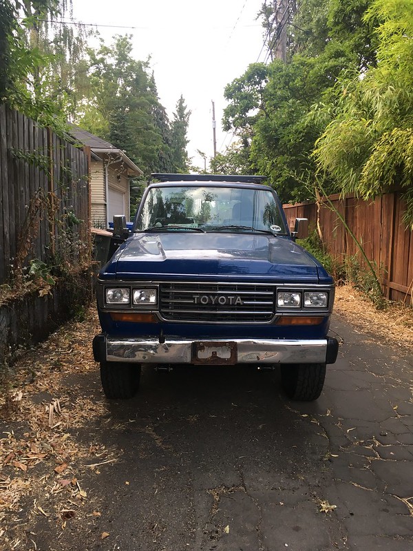

Looking good! Dave could have used those sliders on Sunday!.. and after today he may be contacting you for an entire exo-cage.
Rear bumper talks have begun.
Speaking of...Chase now that this thing runs you need to get some battle scars, we might be too embarrassed to invite you to the Western Washington Wagon Wayfare with it looking so much better than our junk :hillbilly:.
Bahahaha, oh yeah. This cruiser sports only the finest discount Maco paint job $200 can afford. Some day the old girl will get a real paint job.
Just curious, so it was total plug and play functionality wise? Glad it all worked out. :beer:
