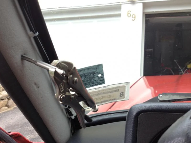

Pillars are hollow and thin metal sheet. Best and cheapest way is the way 2mbb shows it..
Nutserts or nut rivets!!!
I think everyone should have a tool like this... they are great little gadgets to have !!!

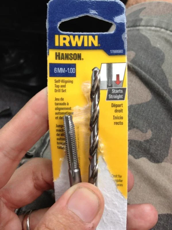

Do you have a 60 ir 62? The 60 doesn't have the holes on the a pillar. I just went to Home Depot to get a threading tool. 6 bucks.
This is the one you want if using the Toyota screws.

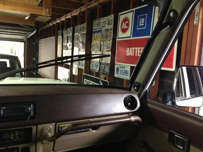

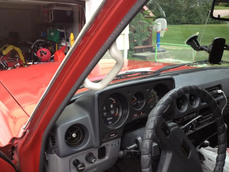

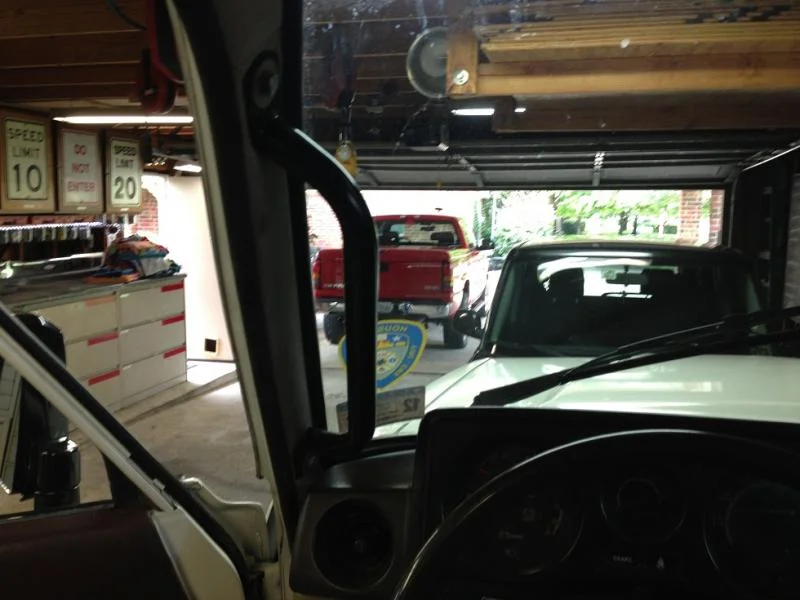

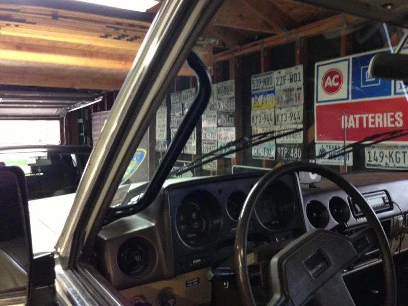

Indeed. SOA + No Sliders = Grab Handles. I originally ordered these for my dash (glove box) but did not work for that so I used them in the A pillar. They are Rugged Ridge 20" handles and put them in with my nut sert tool. Work well and look beefy. Finally got me an aussie bar and now the interior looks like a roller coaster ride.

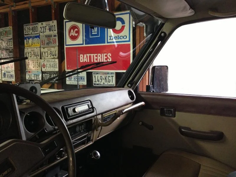

I just installed the A pillar grab bars and I couldn't be happier. Now it's "really" a breeze getting in and out.

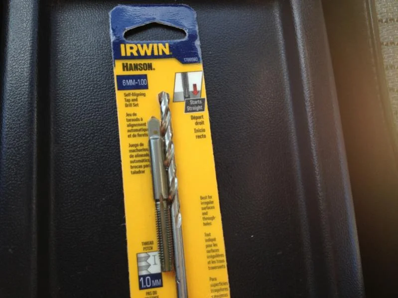

I used a Self aligning Tap and Drill Set from the Home Depot. It's the exact one for the stock screws. It cost me $6.50 or so.
It was really easy to use. Drill the pilot hole and use the tap. I used my handy pressure wrench and had no issues.
