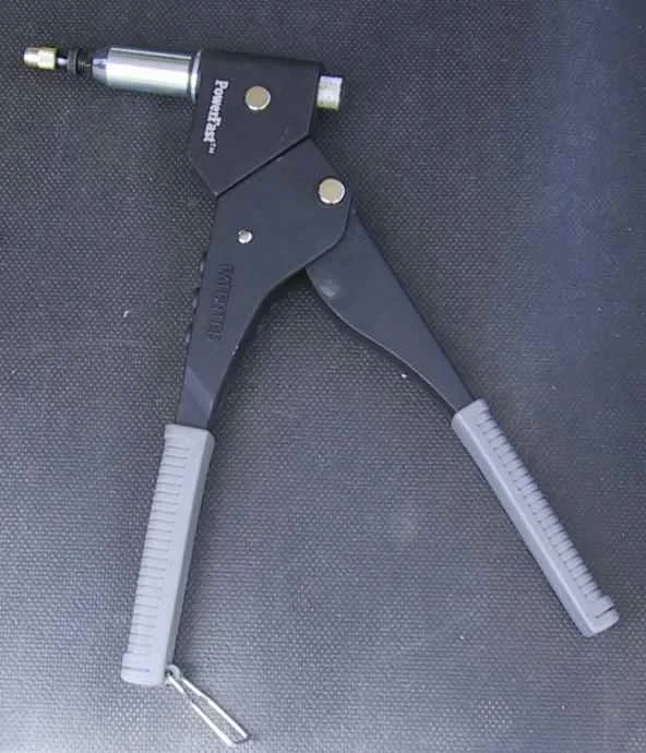

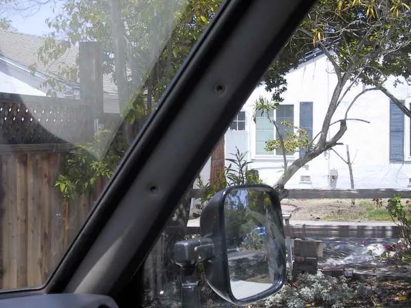

I'm going on a trip with some friends in my truck and his wife is petite so I installed the A-pillar and B-pillar grab assist handles on my FJ-60 this morning. The B-pillars already has the threaded holes in the pillar so that was a snap using a 6mm x 30mm pan head machine screw. The A-pillar handles are from an FJ-62. I drilled the pillar and installed 1/4" x 20tpi nut rivets.
