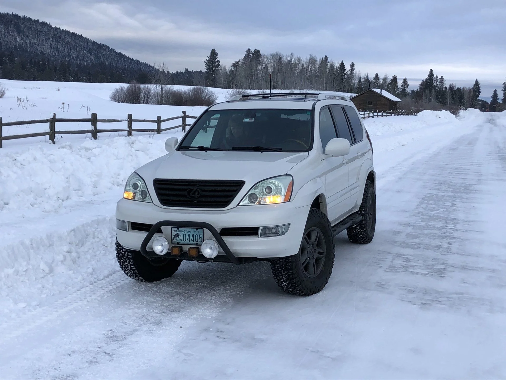

Lots of snow and icy road driving later, they work pretty damn well. So now I might just keep them.
I did some trimming and still have some rubbing I need to fix. And I probably need some new UCAs now (so might ask for recommendations on JBA or Toal Chaos, etc)

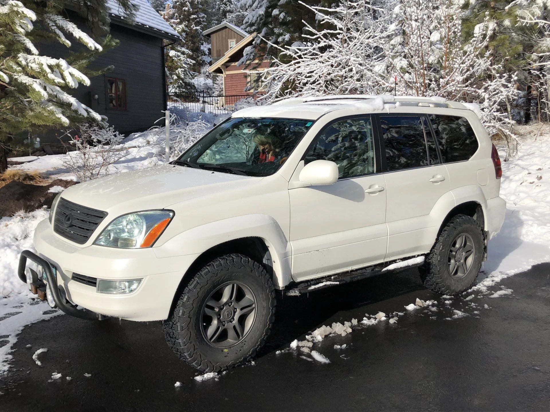

One more pic from earlier today
285/70/17 (6 ply) on the stock rims with spider trax spacers. We trimmed a little but I still need some help getting some of the rubbing dealt with. They sure seemed sticky in the mountain snow and ice.
Discount tire was great to work with and out the door mounted and balanced... I think it was about $1000
