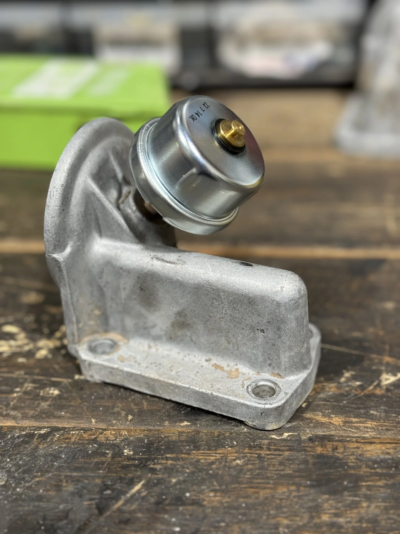

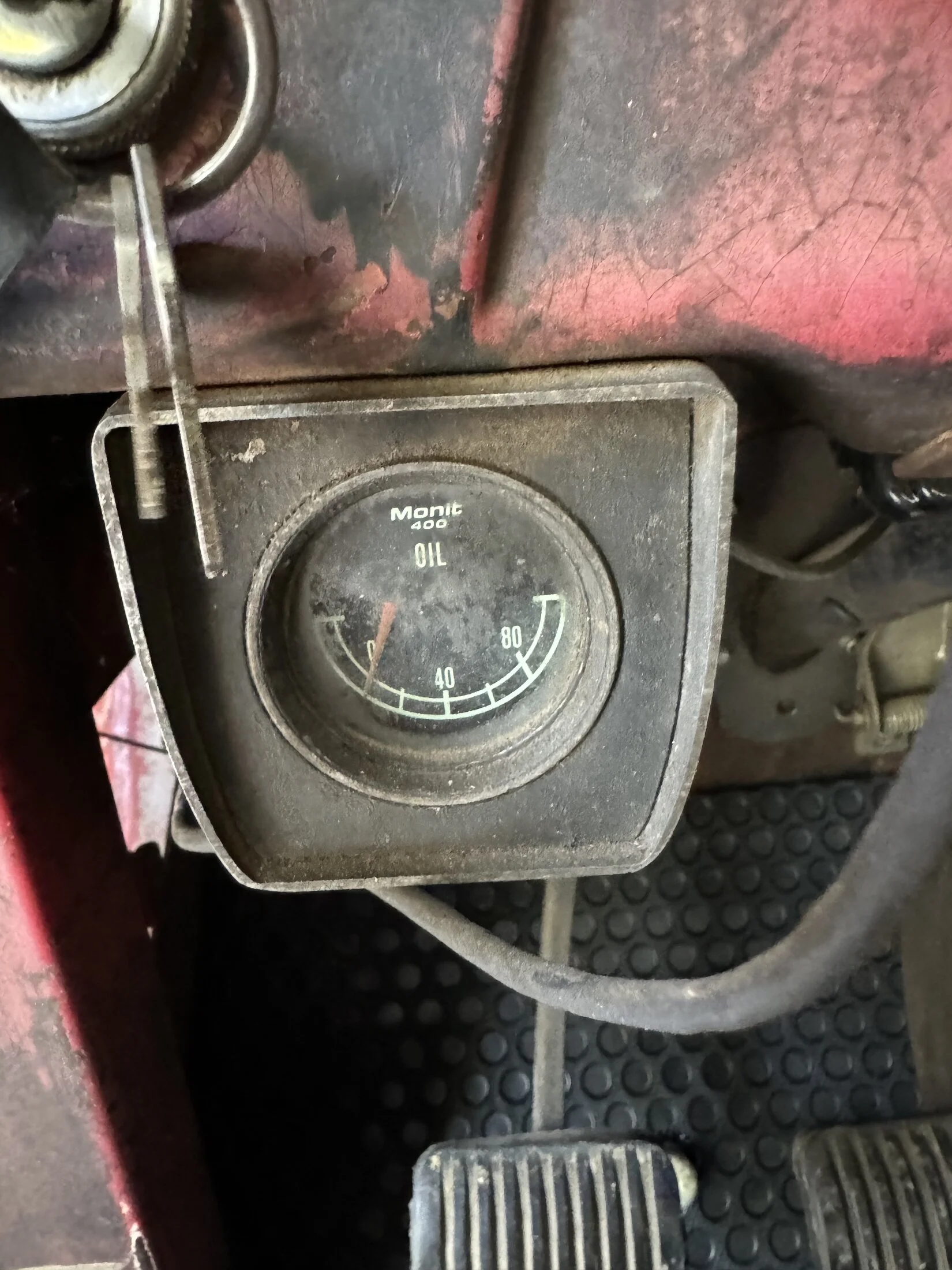

The PO had an old school oil pressure gauge tapped into the block on the old F when I got it.
Since none of the gauges worked I kept it but tapped in the 1/8” NPT into a non Pressure style oil filter housing.
It never leaked in the 3+ years but I must have disturbed the threads enough to make it leak when I swapped this all out.
I pulled it today and chased the threads good and reinstalled with Locktite 567
Still leaking. I’ll be calling Classic Cruisers on Monday for a new one. I’ll try to get one that’s already tapped this time from the factory and try to make the stock gauge work again. If not I’ll get an adapter.
Mean time it’s back as walking wounded

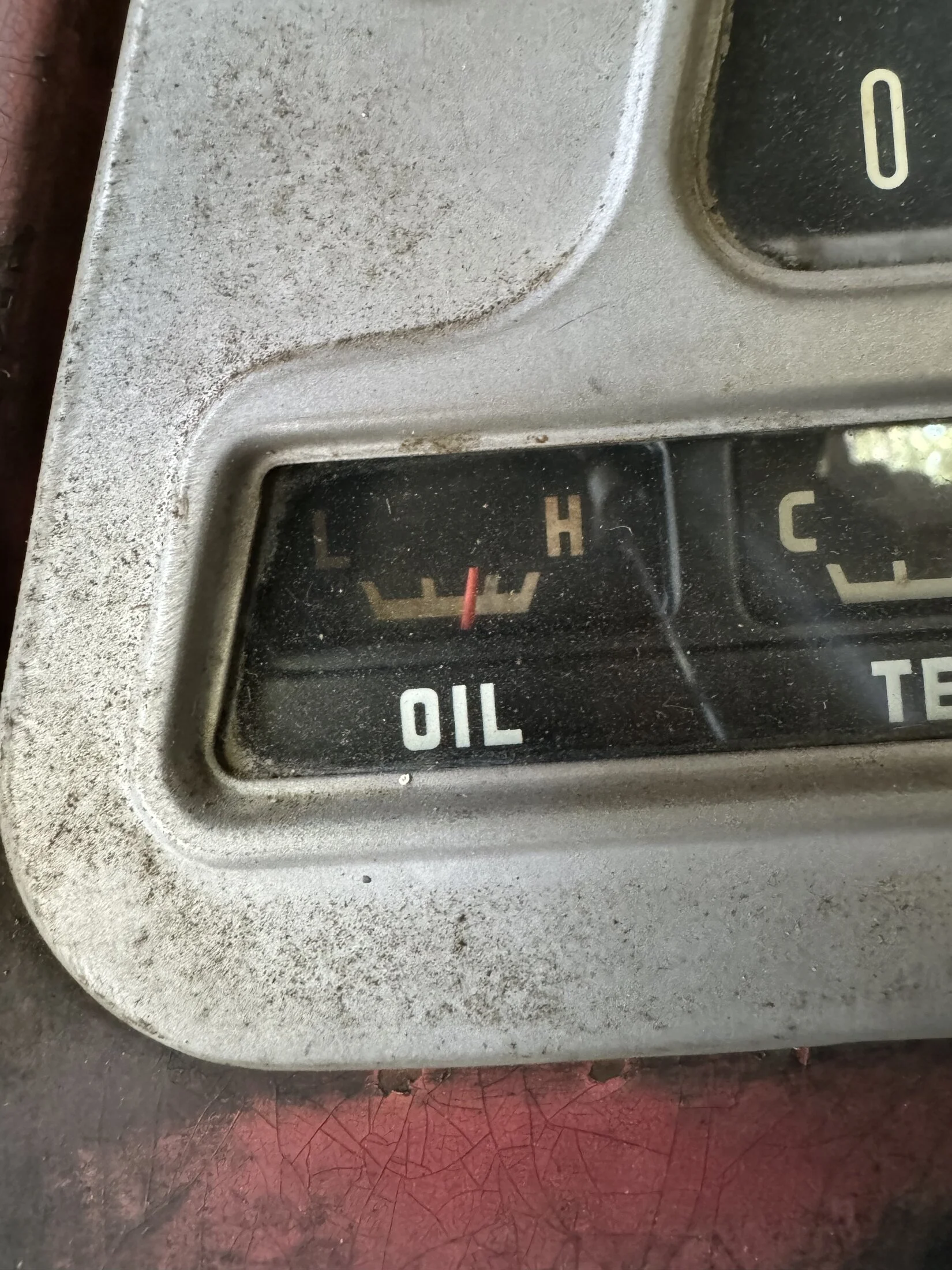

I got my OEM pressure sensor from Classic Cruisers. Wild Toyota still makes this. The gauge was broken on the old cluster and I never even bothered to check the new cluster. I just used this old one that was on it.
BooYah, the stock one works. Just needed to run the black/yellow from the drivers side to the oil filter housing
