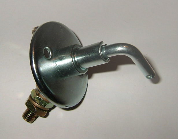

A useful equipment for all vintage cars & trucks is a
Battery master switch ...
... have had it in my gone 43 and glad to have in the 45
Sometimes I pimp my cars :)
Cheers Peter
Military trucks like the Unimog 404 have had them.
Nickname in Germany for these vintage battery cut off switches is:
Natoknochen.
Nato
: North Atlantic Treaty Organization
Knochen : Bone
same Natoknochen is installled in my ( and was in my gone 43) 45 .
they are also a theft protection
Best Battery Cut Off Switch - Do you really need one? - CorvetteForum - Chevrolet Corvette Forum Discussion
Bosch classic Natoknochen:
Batterieschalter
http://www.bosch-classic.com/media/...switches/downloads_3/klemmenbezeichnungen.pdf
