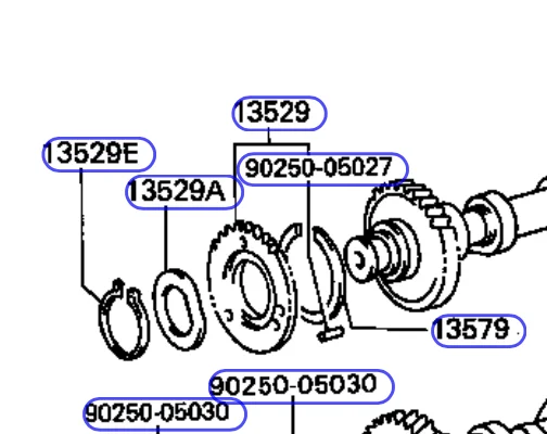

Looking at the picture below from the FSM, it would seem that the camshaft gear spring is installed between the gear and the subgear. Correct me if I’m wrong, camshaft gear, the heavy spring washer that lines things up, then the subgear, then the wave washer, then the final spring washer.
I followed the diagram on partsouq, which makes MUCH more sense.
