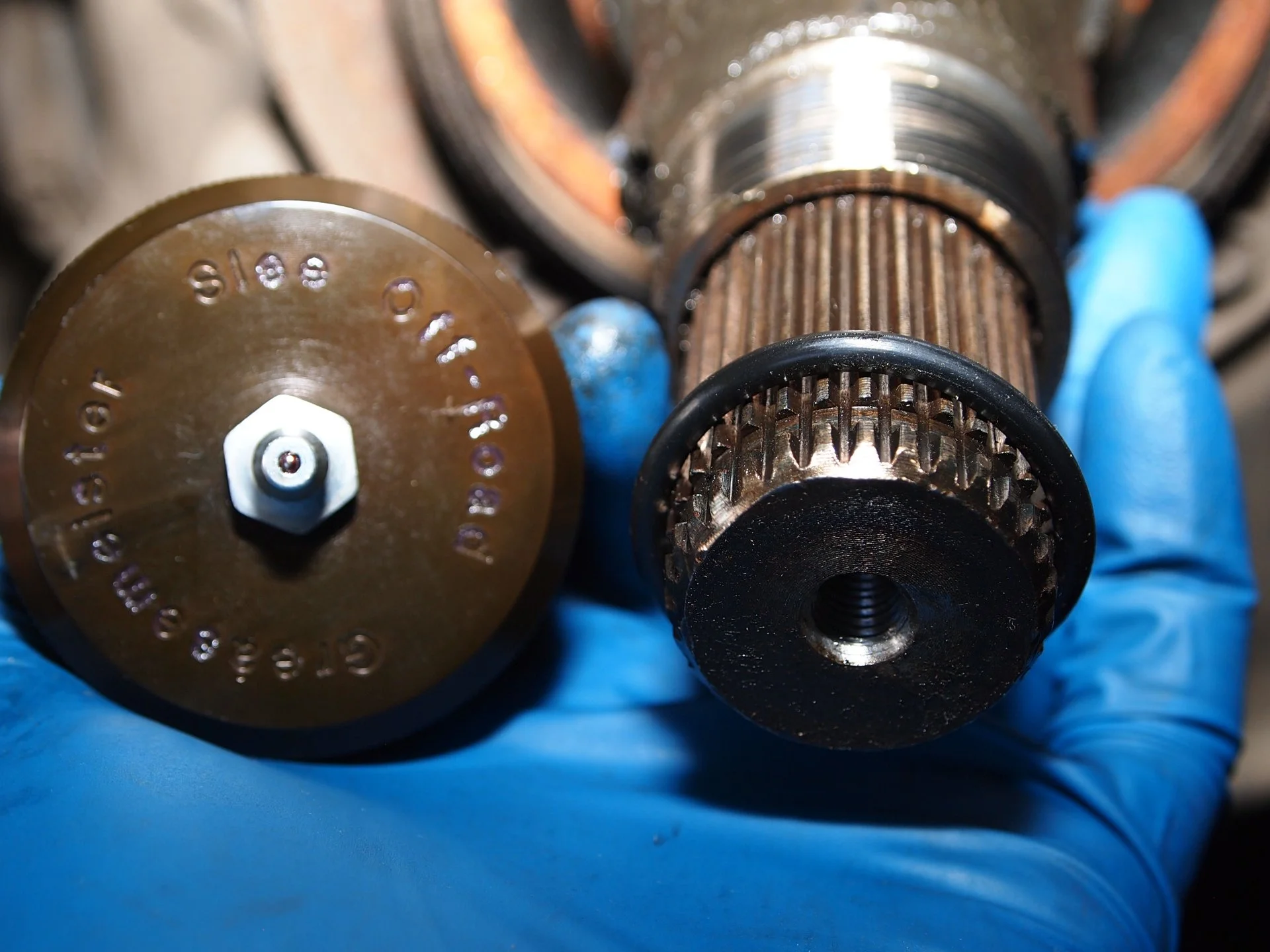

Pushing grease into back of bearing & bushing, by slightly pushing FDS (CV) axle through, is not very effective. It just to hard to get to, even to just the axle brass bushing, much less the needle bearing. Pushing through from front is much more effective. Some make a tool from a PCV cap and grease zerk. You'll find examples of in mud.
Personally I remove knuckle, during first wheel bearing service. Than clean, inspect (replace if needed) and lube axle bearing & bushing.

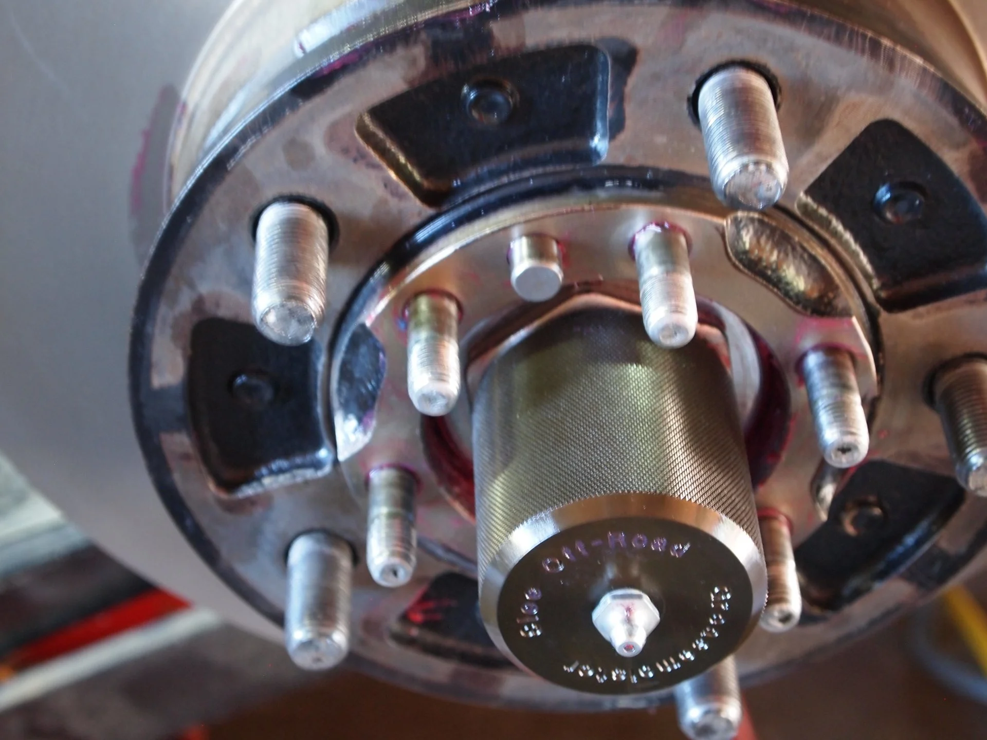

I use a Slee spindle tool to grease axle bearings and bushings. I just use Mobil 1 wheel bearing grease. (FSM calls for #1 white lithium soap base grease IIRC)

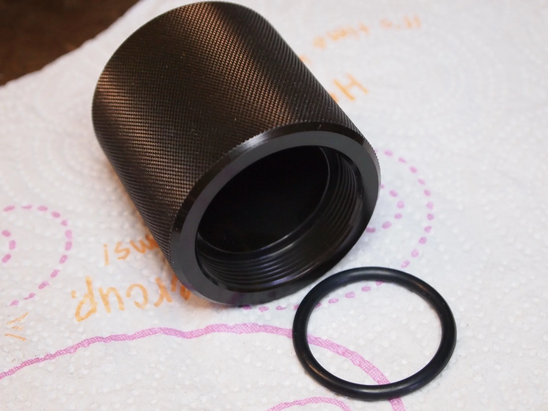

The Slee tool is pretty fancy. You can make your own for about $4. This works really well.
Yep, that is exactly what I did. Worked pretty well. Thanks.
