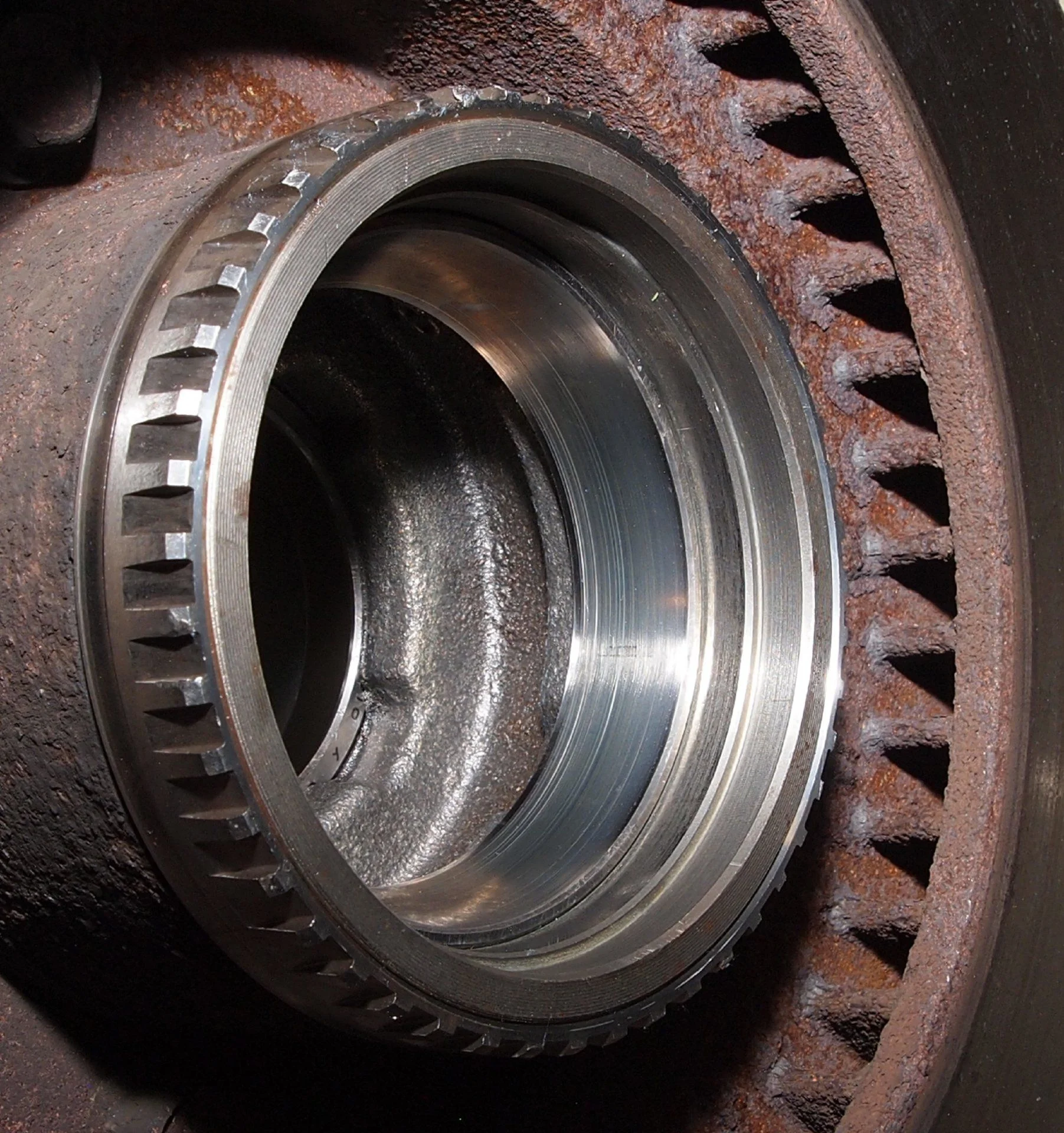

Cone washers is area many get into trouble. So I'll show these, they were toughest cone washers I've removed. Someone glued them in by putting FIPG on hub flange gasket. Toyota does NOT use FIPG anywhere in front-end.:bang:
We don't pound on hub flange as it will bend. Which may keep from giving a water tight seal and/or cone washers from riding flush.

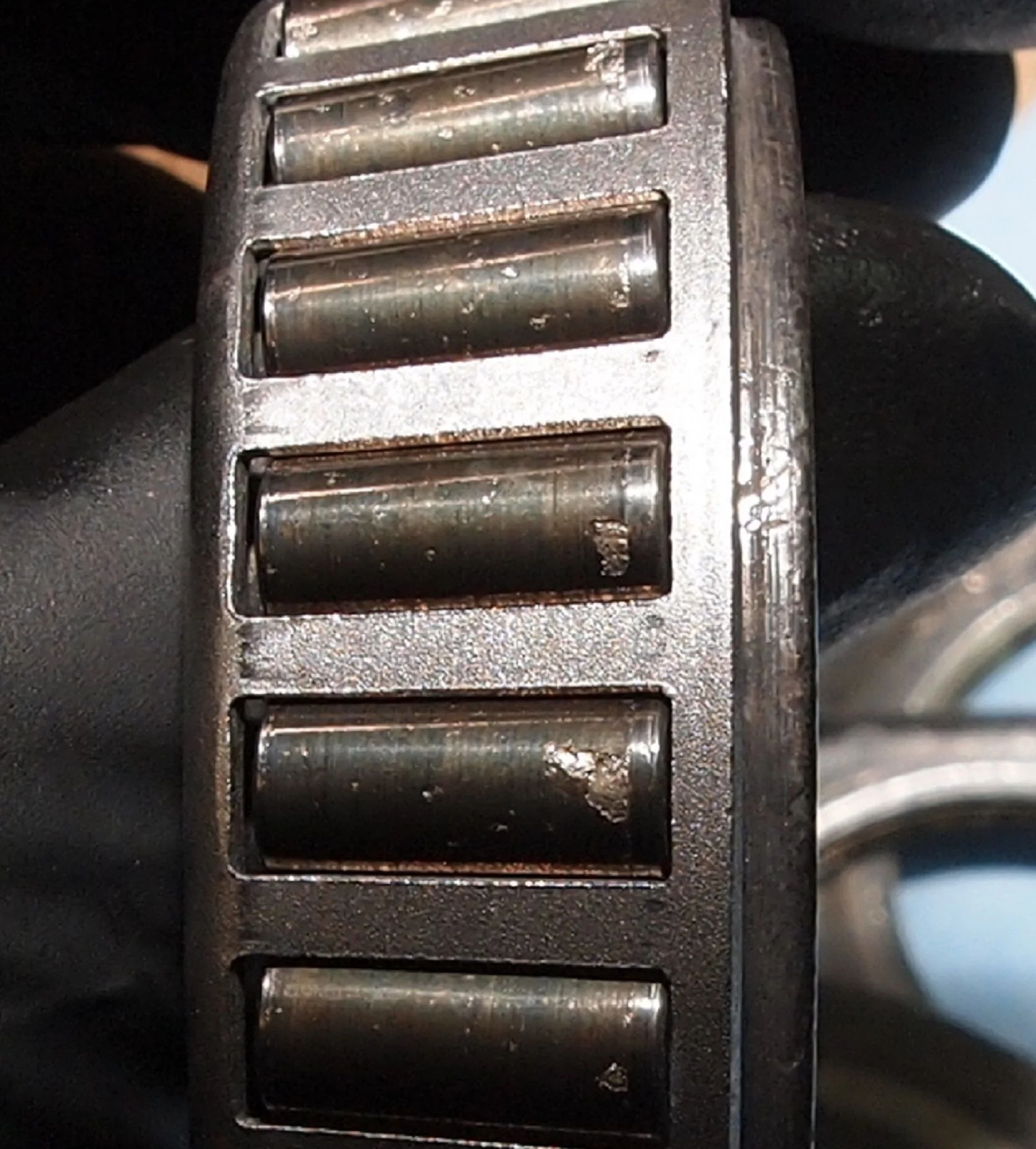

I don't replace wheel bearings often, as they are so tough. I did find my first bad wheel recently. Sorry I don't have video of replacing. One day I may see if I can edit all my videos in to one rather than segments. But for now one must just have to hunt through my videos on youtube.
Here what bad bearing & race looks like.

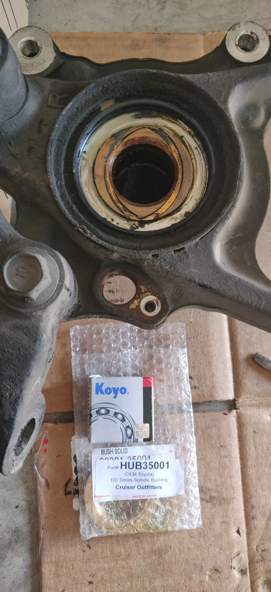

How do I remove this brass spindle bushing? I have spindle bearing and bushing to go in. And do I need a new oil seal? Can I reuse it?

Spindle bearings replaced with brass washers. Removed those by using a socket inside the axle cavity. Thanks again.
