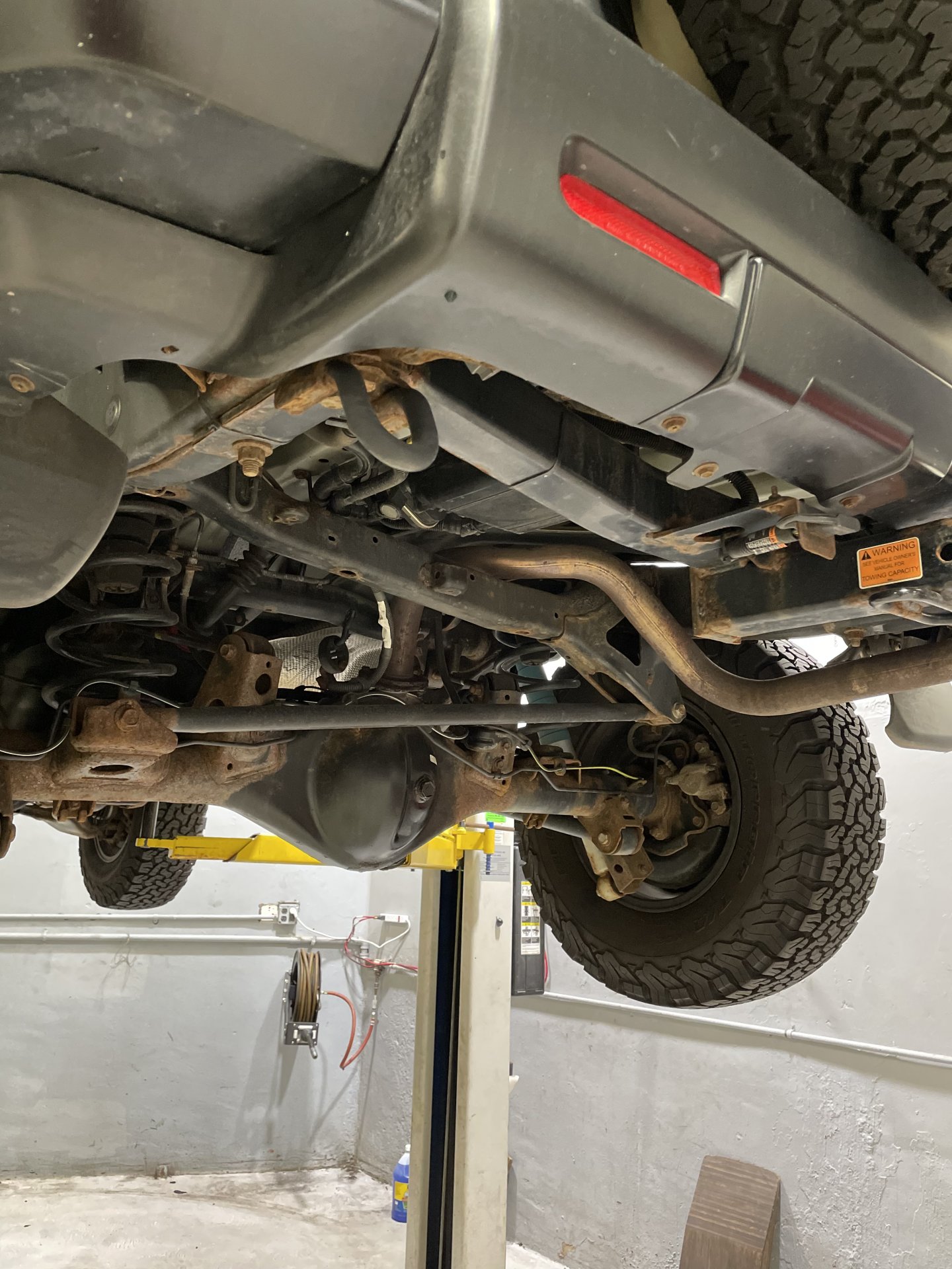

Need the collective opinion of you all. Looking at an FJ cruiser and this is the underneath what are your thoughts on the rust

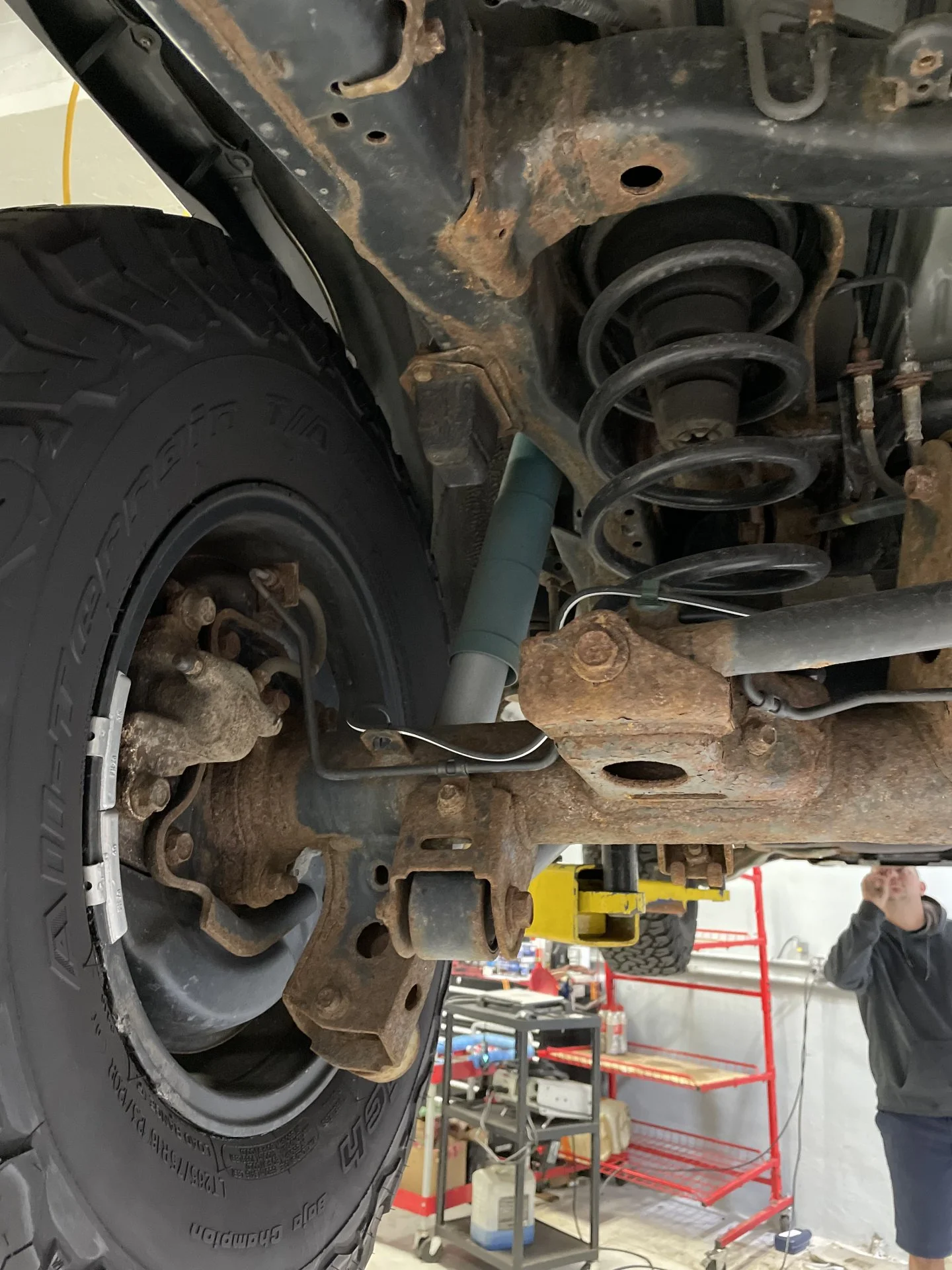

I suppose it's not bad by Detroit standards. That panhard bracket on the axle looks pretty rough. But the wheel speed sensor wires look brand new.
That seems to be a weak spot on the FJ. I looked at one this spring in which the bracket had fallen off completely from rust and then rewelded back on. Rest of the undercarriage looked similar to the one shown in this thread, maybe just a bit worse. I passed, even though a good price around $11K and less than 100K miles. Had another issue though, a lot of road noise from the rear end that owner discounted as being caused by the snow tires.
OP: Not so bad that I'd run away, but deserves some sort of rust discount from the normally ridiculous prices asked for on this model.

That's not even corrosion. That is surface rust. It will come out with a wire wheel on a grinder. A crafty seller would have done that already in a day and put black rust paint and then spray oil over it and tell you how well it was taken care of.
For the northeast, that could be the underside of any two year old truck. I'd be more concerned of rust starting like that on body steel, that would be a walk away.

I'm confused. I thought you walked away from this one. Most of the areas that I see with surface rust are also the areas that get abrasion from the road.
