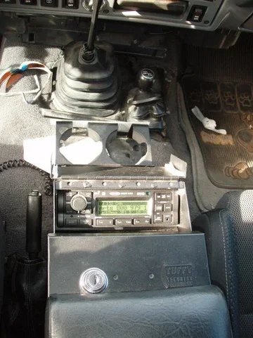

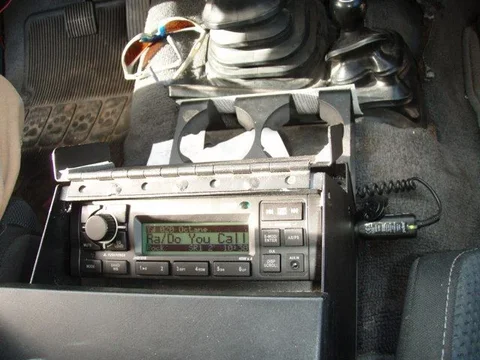

OK, so I got my sirius box and it took about 4 hrs to take out the old stereo re-wire everything to the tuffy and drop the new unit in. Pretty straight forward I'd say.
I did have to dremel about 1mm of each side of the Tuffy for the unit to sit all the way down and flat but other than that.. it looks pretty good...
LOVE this unit. it matches the green lights on the dash board and I can dim it waaaaaay down... I thought I was getting good sound from the previous unit but with this unit and the Sirius the sound quality is much better. I still need to get the wire for the IPOD direct connection so I can leave it inside the Tuffy charging and can control it straight from the head unit.

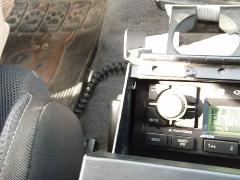

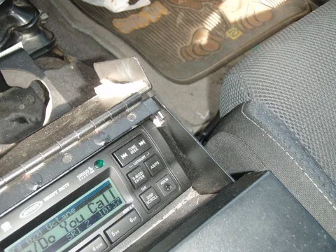

Here are some pics...
see grind on side of tuffy.
See grind inside of tuffy
It dropped right in after that...

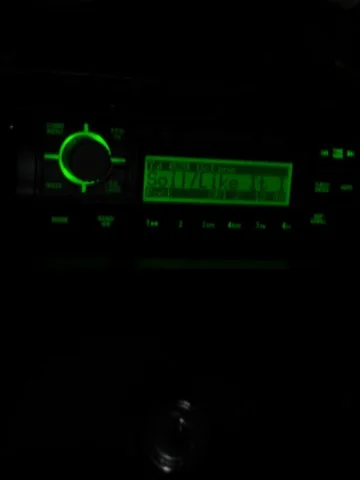

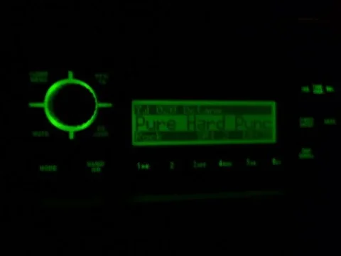

Here are of some at night
I also added some extra 12v outlets at the bottom side and rear of the tuffy box with a 10 amp fuse..
The sirius box is a plug and play and I used some double tape and put it under the tuffy.
The green light is at its brightest on the last two shots and it can be lowered but I like it at hi as it is not hard on the eyes... Its a no frills radio and I like it. Its wired to a 12v ignition wire but im getting a lot of feed back from the turn signals and the headlights when ever they are on.
I might get a filter (if there is such thing) or wire it straight to the battery..Any thoughts or comments on the feed back are welcome as I dont know much about audio set up...
