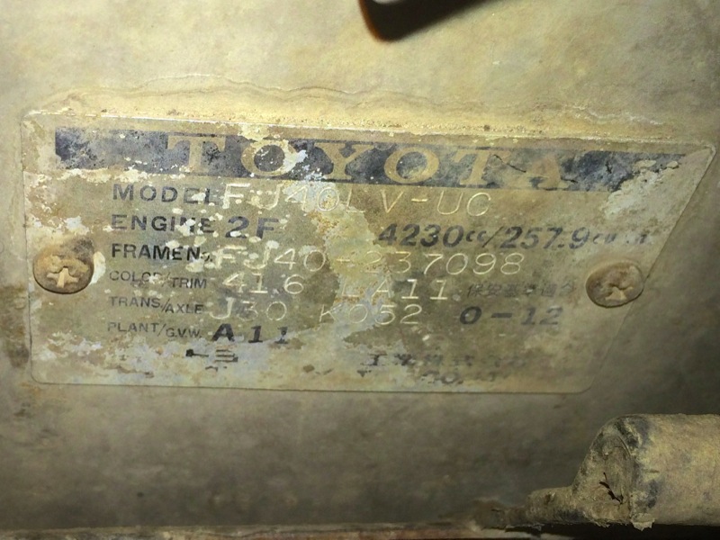

whats the trim code and vin number of the cruiser? if you now either

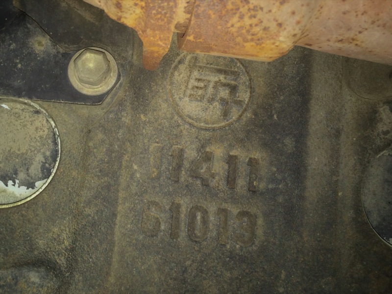

I do have that info… as well as the block and head reference numbers. See below:
The builder's plate isn't against the firewall, its on the passenger side fender behind the battery. Based on the screws holding it there I'm assuming it was relocated to that spot.

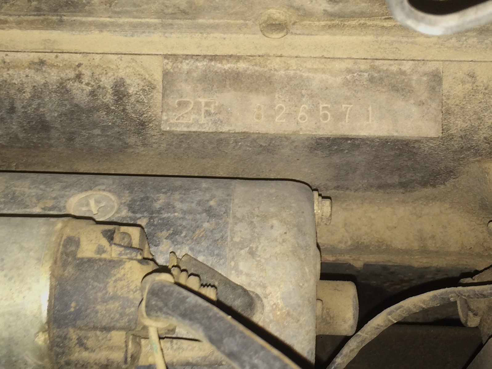

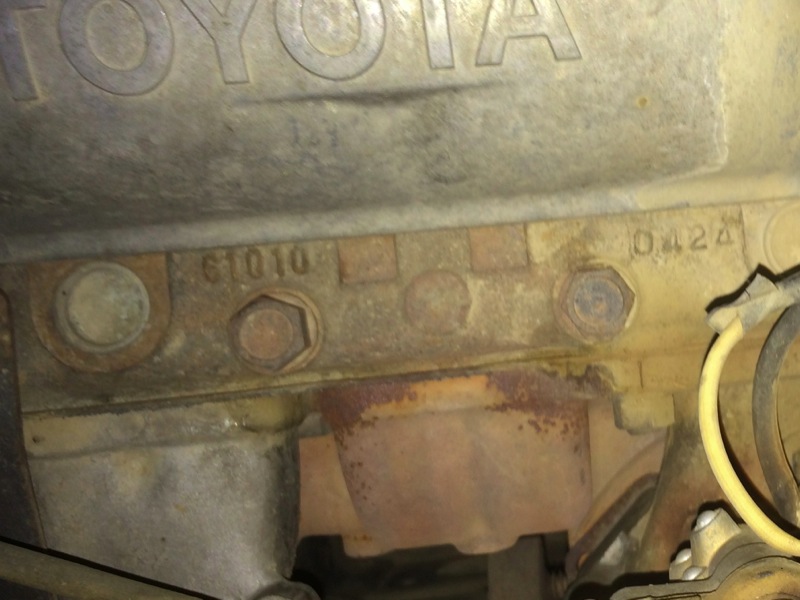

As for the engine block number, its next to the starter down on the side. And its imprinted into the block.
Is that FJ40LV-UC code referencing a Europe spec vehicle?
-Geoff
No, it's a General Market spec vehicle.
Ah, gotcha… I actually snagged a photo of that as well.

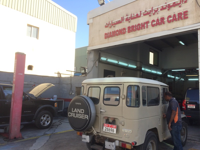

Anyway, I picked up a new water pump, all new radiator/coolant hoses, radiator cap, side fender emblems, fuel filter, wiper blades, etc. Truck is in a local garage getting fitted with all of that now. The guys at the shop were all quite excited to see my old Land Cruiser.

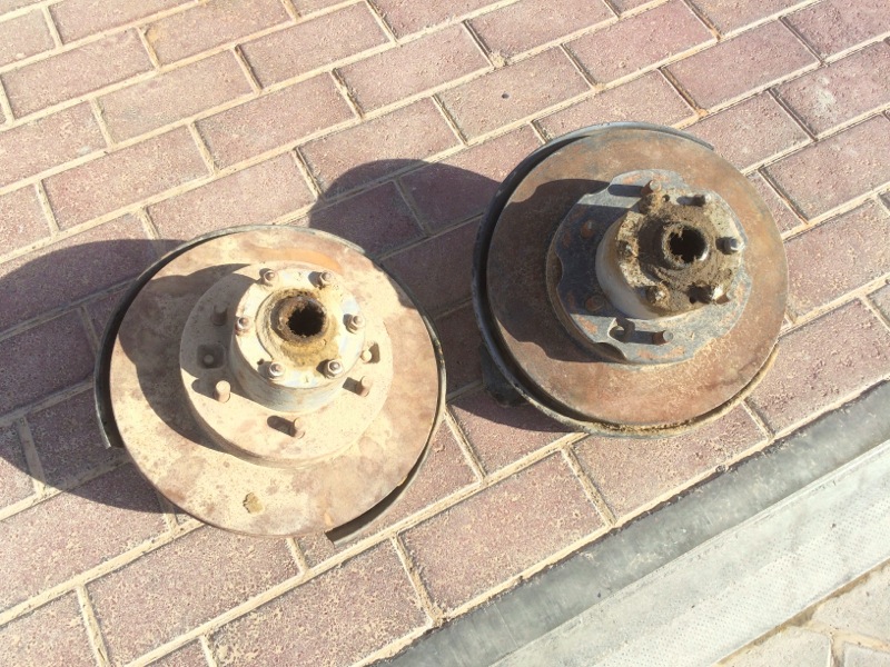

Also managed to find a pretty good junk yard up in the norther Emirates… managed to snag the following items:
60-series disc hubs

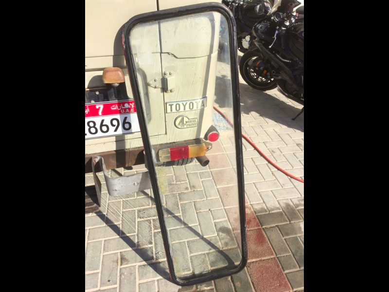

OEM windshield (the replacement in my truck now is too small at the corners)

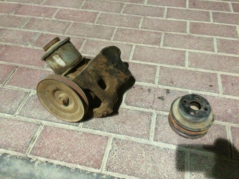

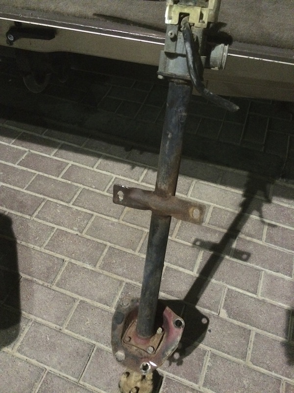

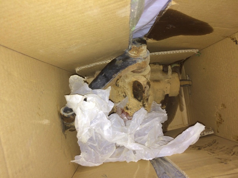

Parts for a 40-series power steering upgrade:
Gotta return the pump… it's not good. He's got at least one other to give me to try.

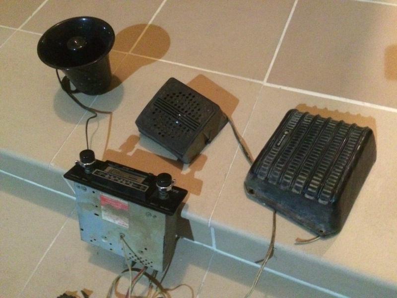

I also pulled the old radio out of the rig…
Niether of the speakers worked… only the loudspeaker. Found the radio had been wired into the cigarette lighter and then I also found another wire patched in. Traced that to the fog light switch. So the fog lights were running full power through the switch that had been patched into the cigarette lighter. :bang:
Glad I caught that. Though now I'm wondering what other wiring issues I haven't found...

Not sure I'm so wild about the power steering. It works great... too great. I'd gotten used to the manual steering and the fact that I could feel everything in the road directly through the steering wheel. Now I can't feel a thing. Hmmm...

As for PS, I noticed that in the beginning as well. The steering seemed flightily. But trust me, it beats no PS when the weather is hot and you have to make a U turn from a standing start. You'll be very glad to have it.
