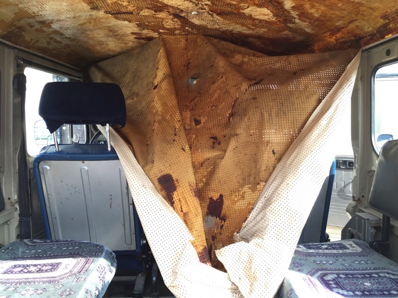

Pulled the old headliner. The accumulated dirt from the past 37 years was NASTY! Note this headliner was about 1/3 of the way down already, torn in several places, and had two holes smack in the middle. A new one is in the plans.

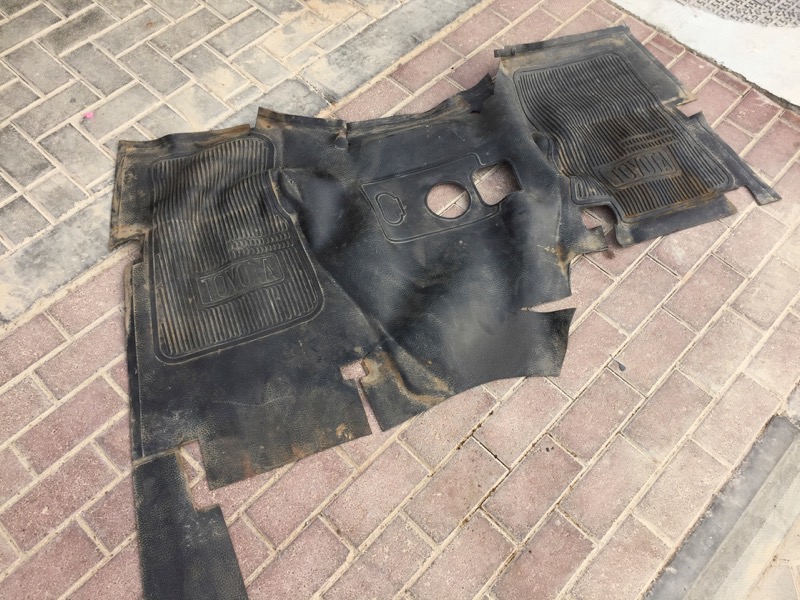

I also pulled the factory floor mat. It's in great condition and I can't wait to see how well it cleans up.

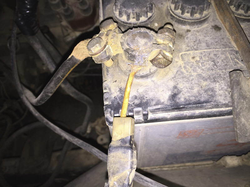

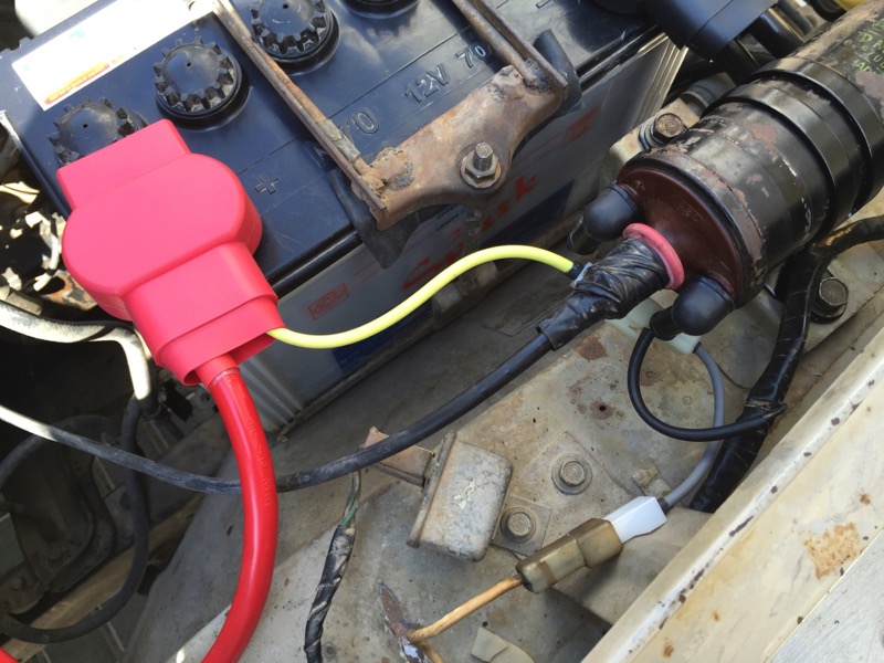

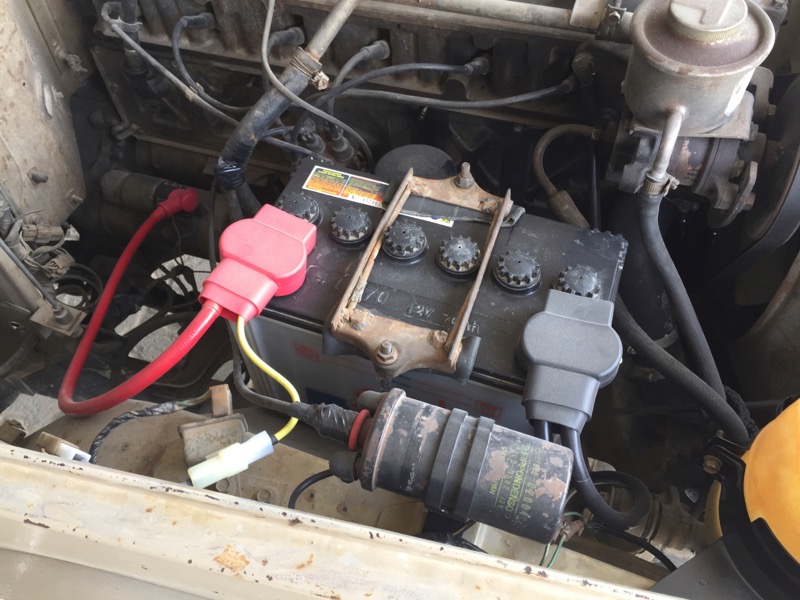

I've been doing some electrical housekeeping. This was instigated by some shorting issues I had on my engine circuit.
Cleaned my fuse block...
My starter cable was a bit old... and the battery lead for the wiring harness was in horrible condition.
Thanks to @Coolerman's slick Toyota connectors, terminal covers, and fusible link (I'm sure the stock one burnt up a looooonnnnng time ago) I was able to clean things up a bit.
@GA Architect provided some inspiration as well and I redid my starter/ground cables.

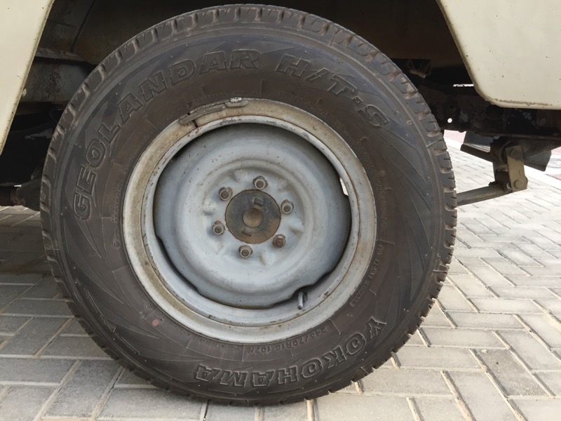

Put new shoes on recently. The tall/skinny tires that it came with looked great. They were about 3 years old and had plenty of tread. However, they were light truck tires and were hard as rock. The first time I took the truck out to the desert I aired down to around 12 psi and the sidewalls remained rigid. Not only that but they rode like rocks as well... speed bumps were jarring.
Tires are a bit of an issue over here. I gave my shop about 5 different sizes I'd accept and 3 different makes... and got one match. I managed to snag passenger-rated Yokohama Geolander H/T-S in 245/70 R16 (since I've got the split 16's). They are a just a tad smaller than the 7.0R16's that were on there.
I'm actually quite pleased with the overall look of the tires. More importantly the ride of the rig has dramatically changed. It's way more comfortable and not nearly as jarring on bumps. Not only that but I can drive the car up to 100 kph now without massive vibration and rattling (I imagine the balancing helped with that).
My end-game is a 2" lift with BFG Mud Terrains in 255/85 R16. But when one of the tires/tubes went flat I decided to go ahead and just get some passenger-rated placeholders in place now. I'm happy I did.
