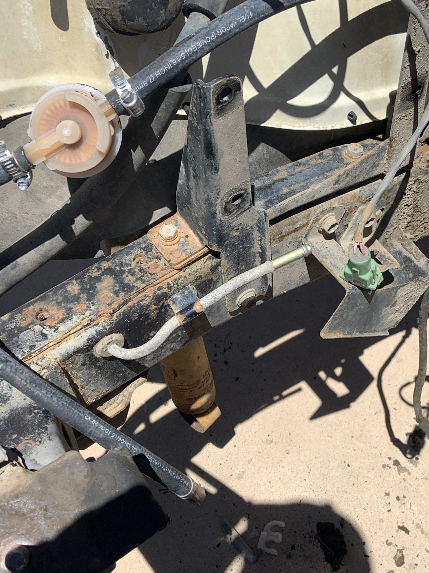

Can’t remember if I posted pics of the low-pro perches I made. In an effort to win or at least get nominated for the Scrapdaddy Repurposed Material Award, I made these out of the 2-1/2” x 1/4” square tubing from one of my old rocker/sliders. Also wanted to keep the little brake line p-clamp mount from the stock perches.
Measured out where the center of the new perches needed to be 11/16” inboarded from where they were originally, and set the pinion angle to 5 degrees. Didn’t check what it was originally, but the 55 rear sits right around zero. Perches are just tacked for now.

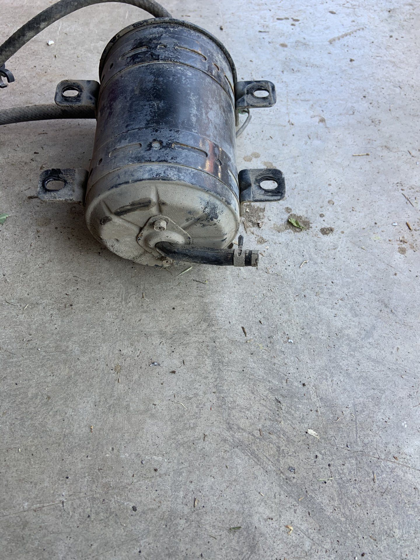

While I’ve got you here @PabloCruise , wanted to get your .02 on this. Robbed the charcoal canister off the 60 to see about setting it up for this project. It has 4 ports. The one on the bottom goes into the frame. Also looks to be some sort of electrically controlled valve.
Would you recommend using this or emulating it?

It could be good...
Don’t worry about the bottom line, the cans need to be at atmospheric pressure so that engine vacuum can suck off vapors when the time is right.
The vapors want to rise to the top of the can, so no worries having the bottom open to atmosphere, the vapors won’t escape.
Also, if you severely overfill your tank, and pressure pushes liquid gasoline into the can, it will run out the bottom.
We can probably ditch the control valve, it depends on how you want to purge this can.
the simplest hook up for the top is incoming line from tank with vapors, and purge line connected to some form of engine vacuum.
It could be good...
Not saying it's a problem but gasoline vapors are heavier than air and want to sink unless they are warmer than the surrounding air. My FJ55 canister looks just like that 60 canister on the bottom. Not sure where the line goes that it's hooked to.
The 55 canister only has two nipples on top. In from the tank and out. Mine goes to the air cleaner housing just above the carburetor. I agree you can probably ditch the valve.
