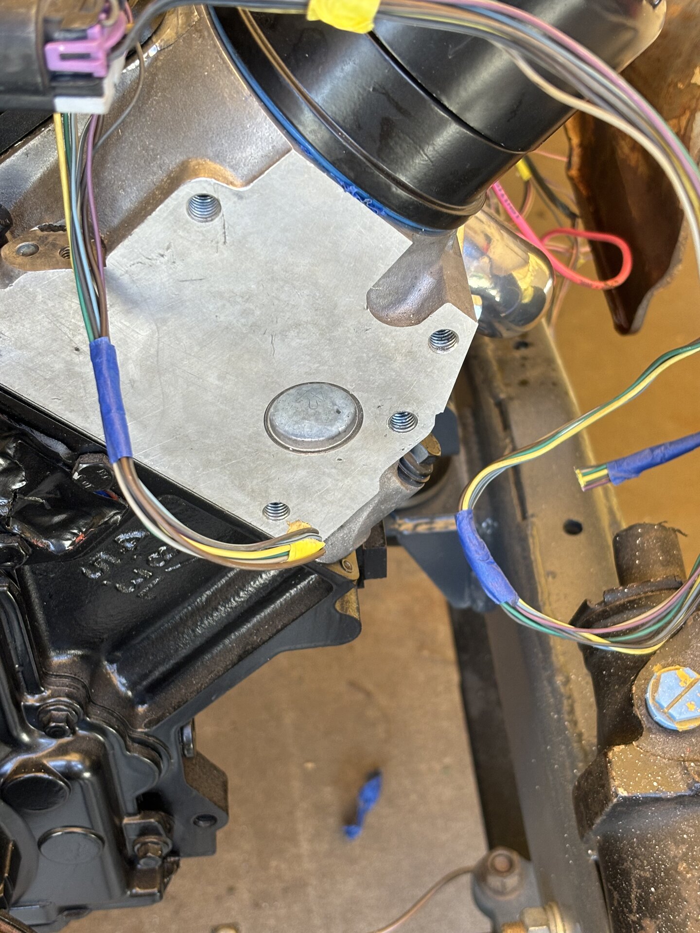

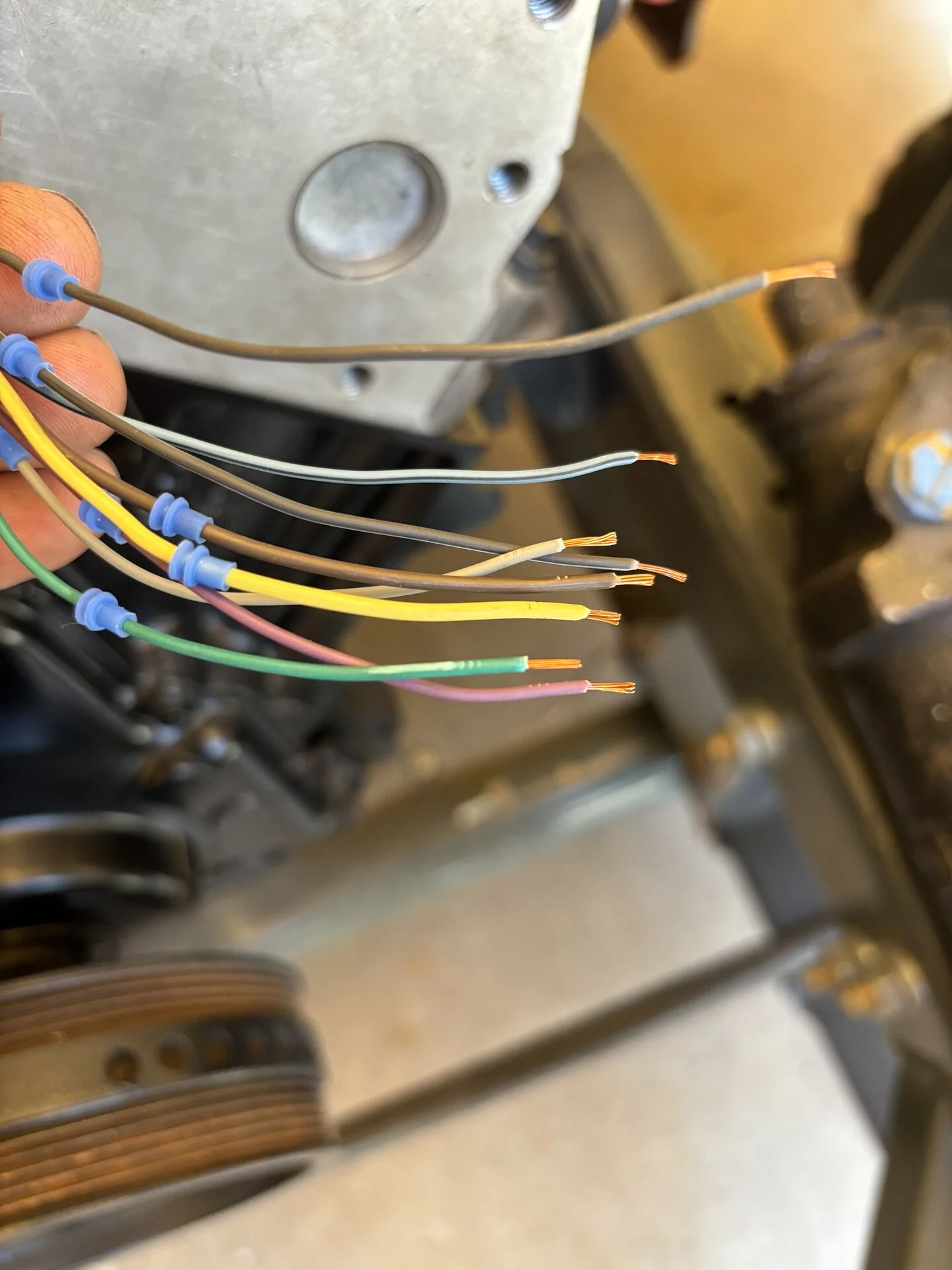

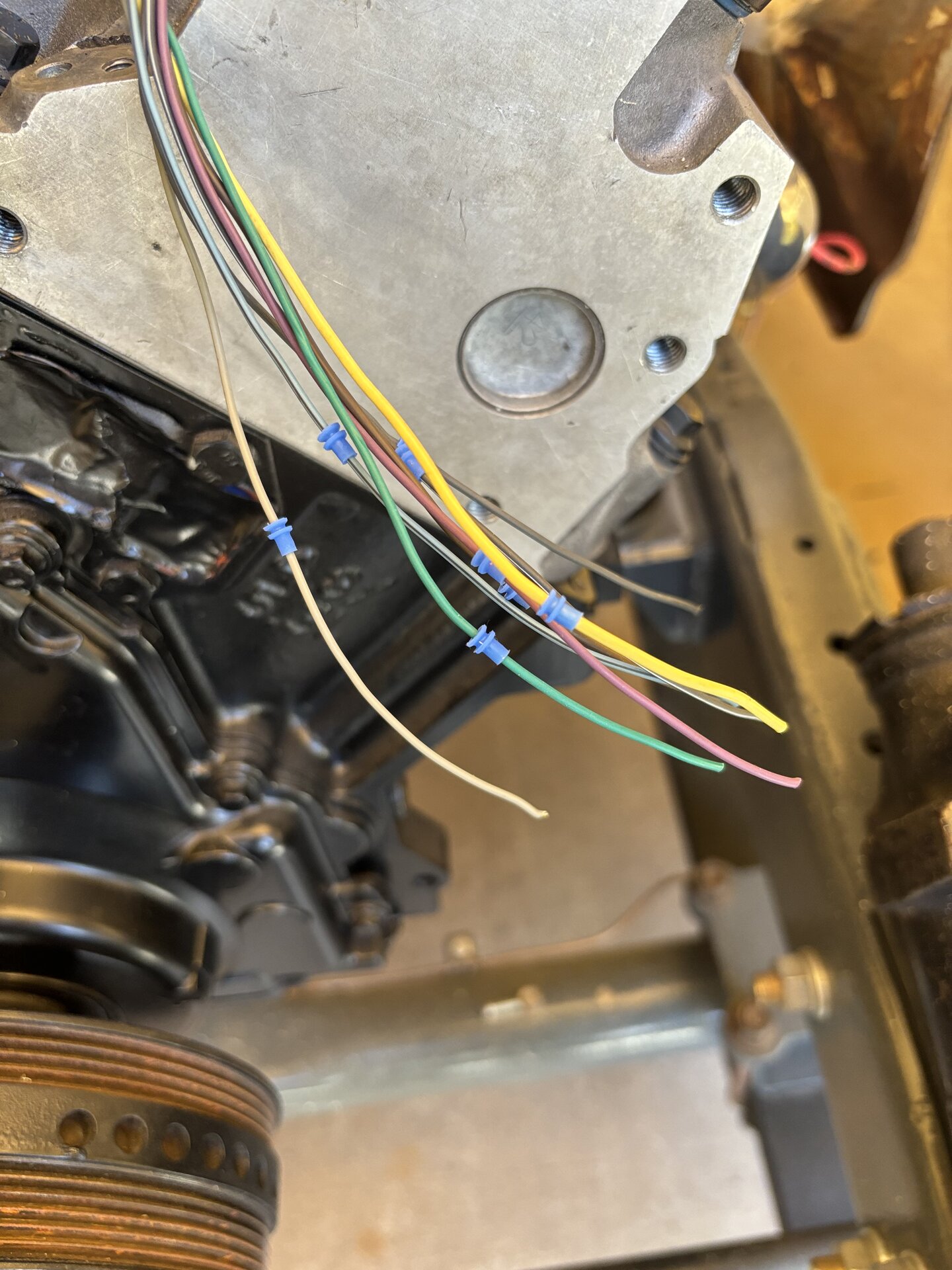

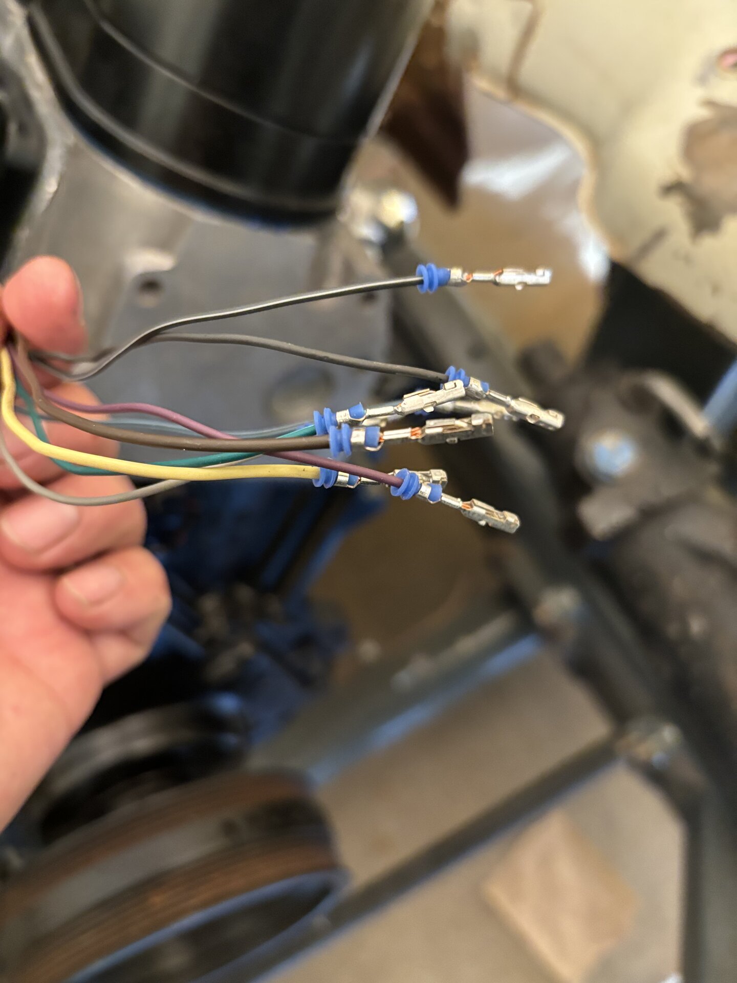

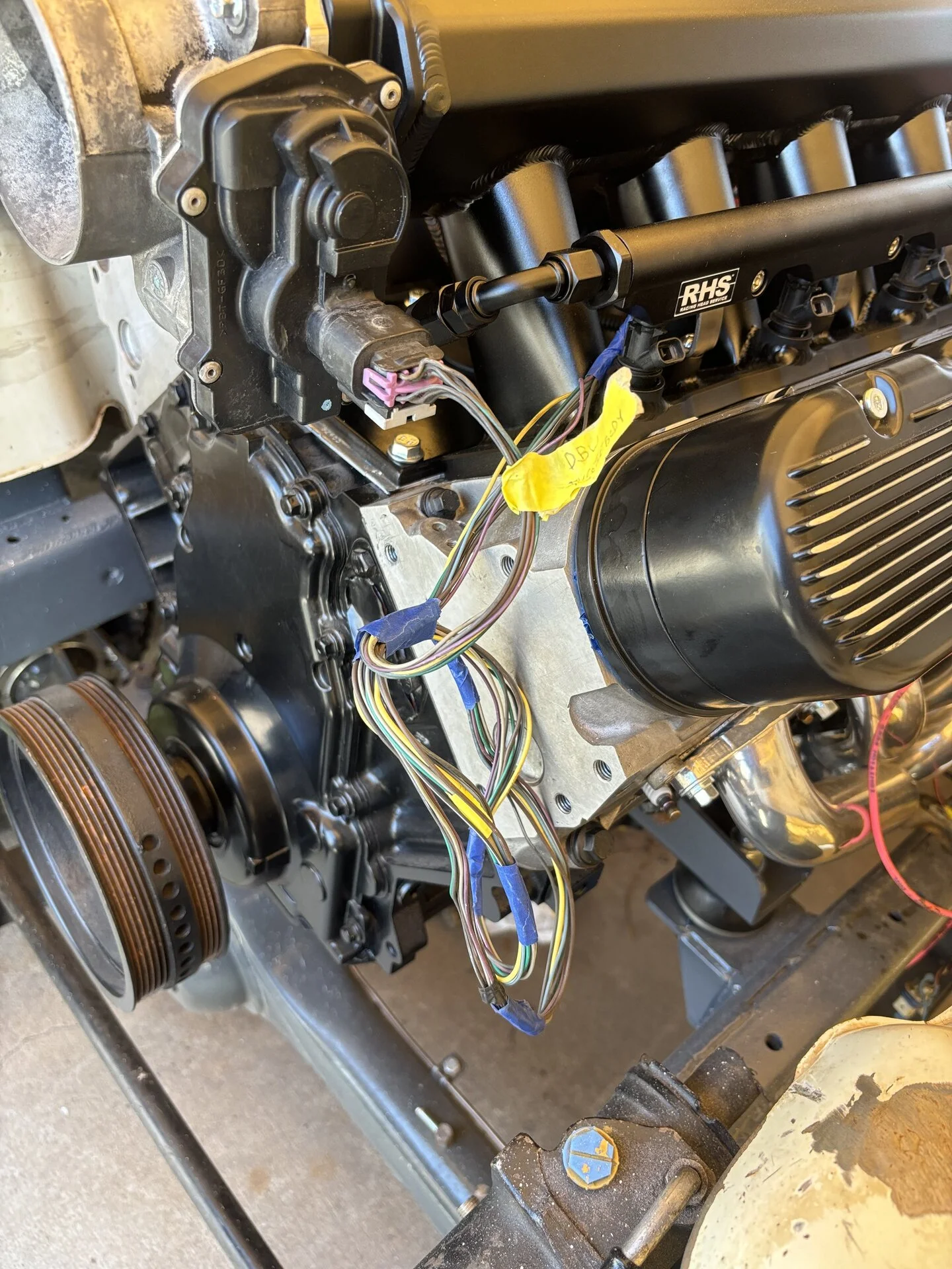

Wanted to show you guys what’s been going on over here with the wiring of the engine harness.

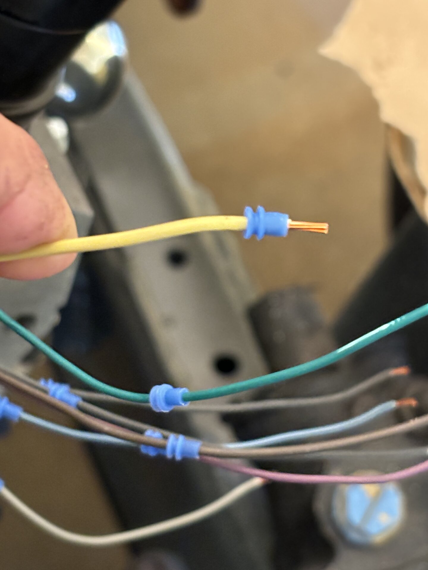

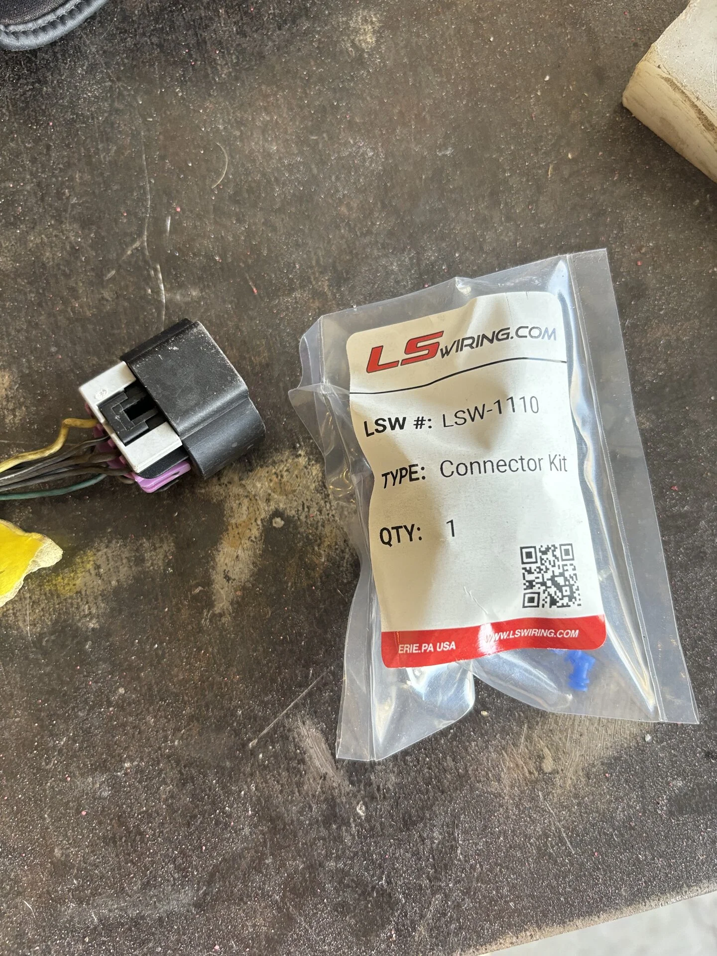

I picked up all new connector “kits” from a company called EFI Connection.
Here’s some pics -

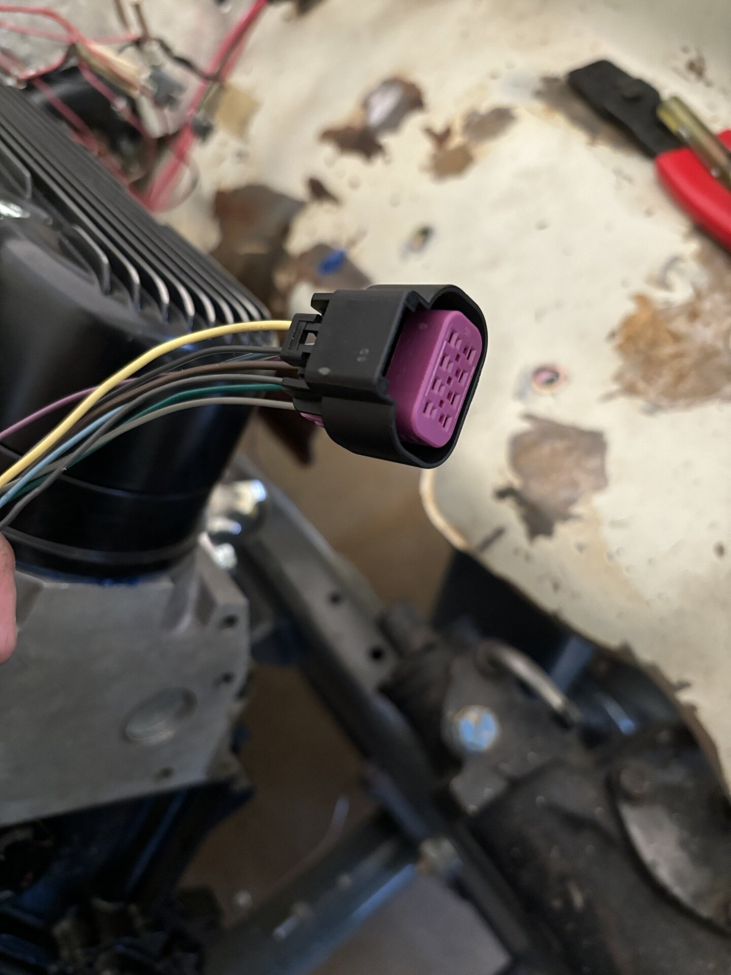

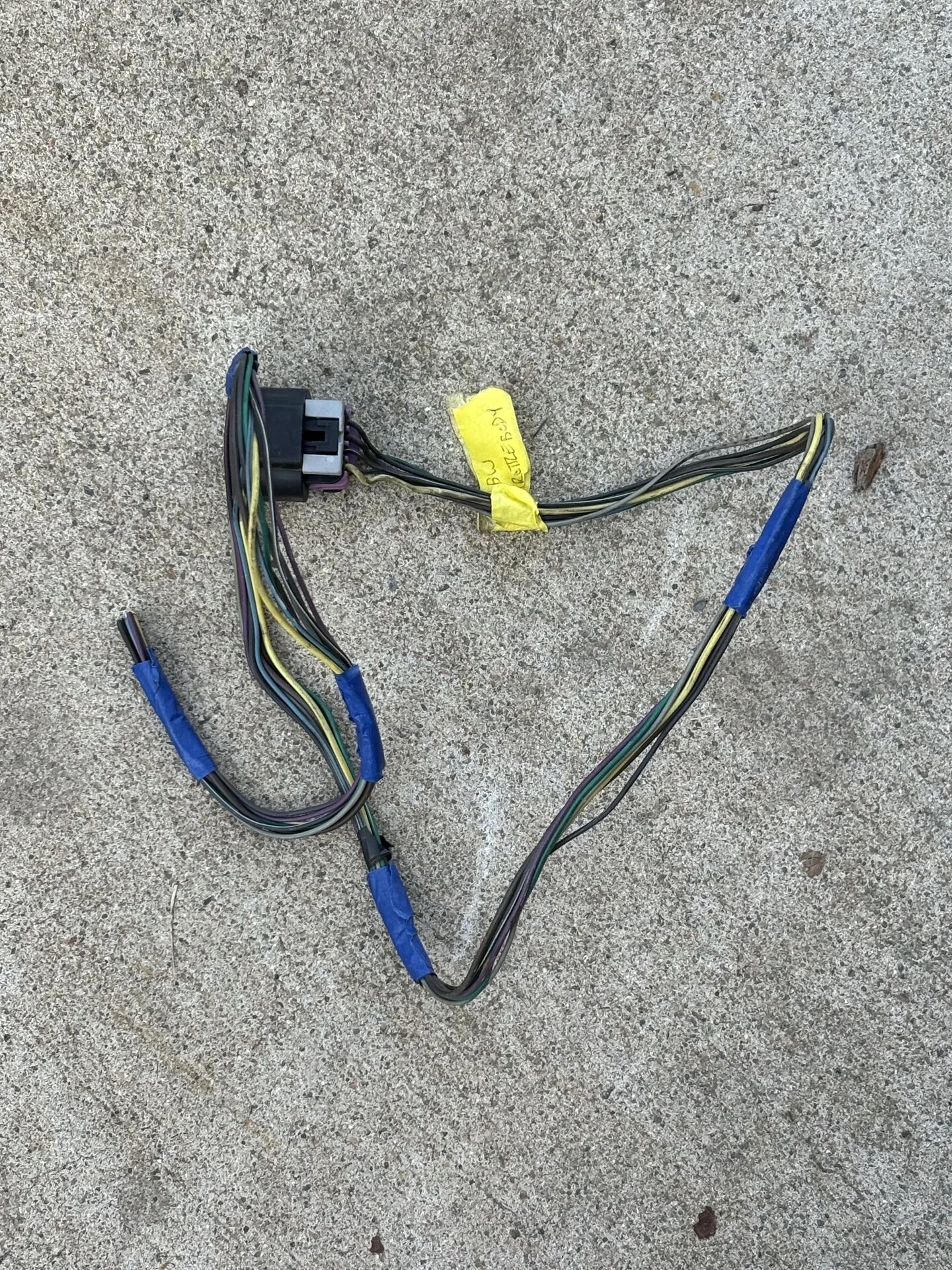

Removed about 20” from the throttle body section of harness.
Man that looks bomber!
(And perhaps a bit trying on patience?)

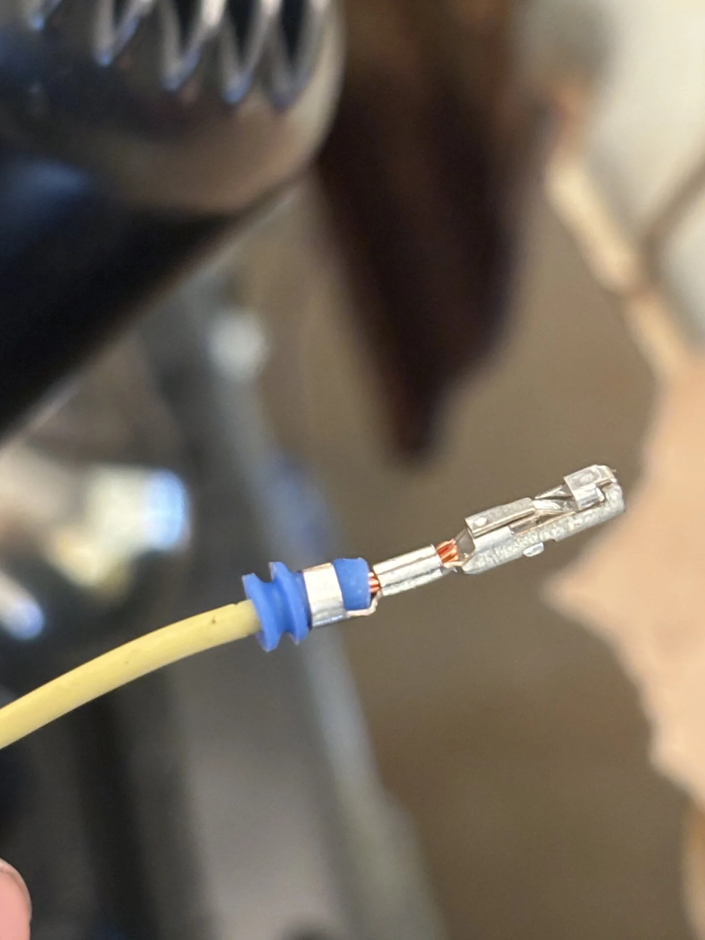

Those are some nice looking connectors, seems to be similar to my Weatherpack connectors , but more robust. Good job.

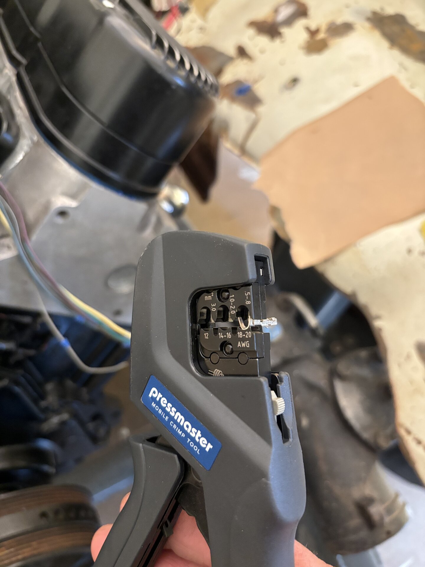

That particular connector is from the Aptiv GT 150 line. Pressmaster doesn’t have a die for that line specifically (that I’ve found), so used a Weatherpack style die that goes down to 20 AWG. It crimps the wire holding section of the terminal great, but doesn’t really crimp on the seal very well so had to help it along with a cheapie open-barrel crimper I have.
