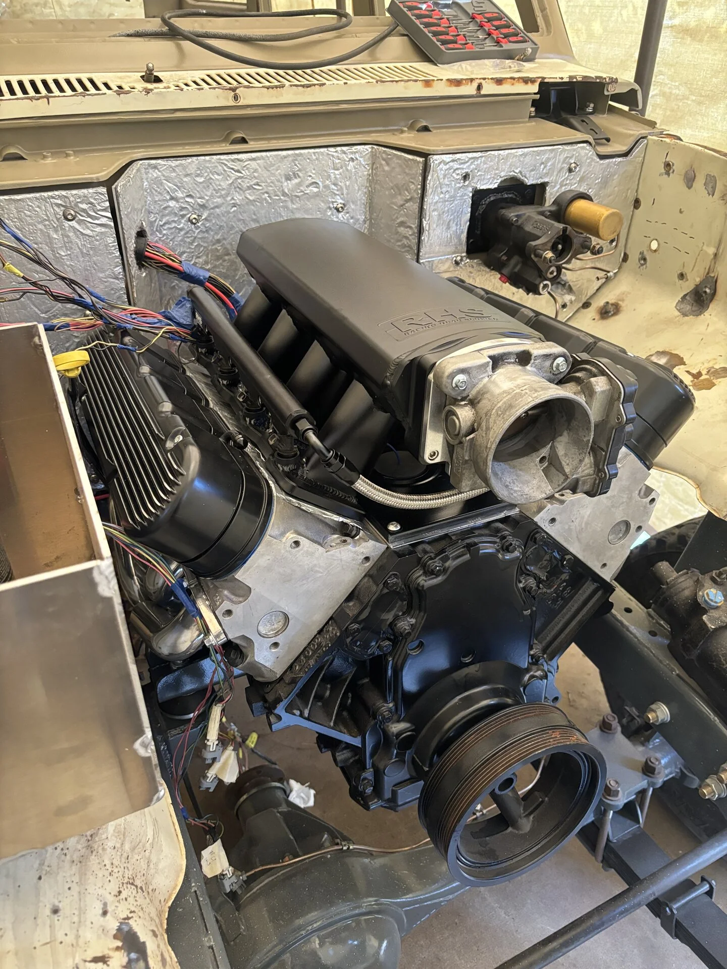

Looks nice in there. But I think now you need a big 102mm throttle body to bring it all home.
Yes, the throttle body is currently the ugliest part of the equation. My plan is to run it first with this original TB and upgrade later if necessary. At the very least this TB needs to be removed and detailed!

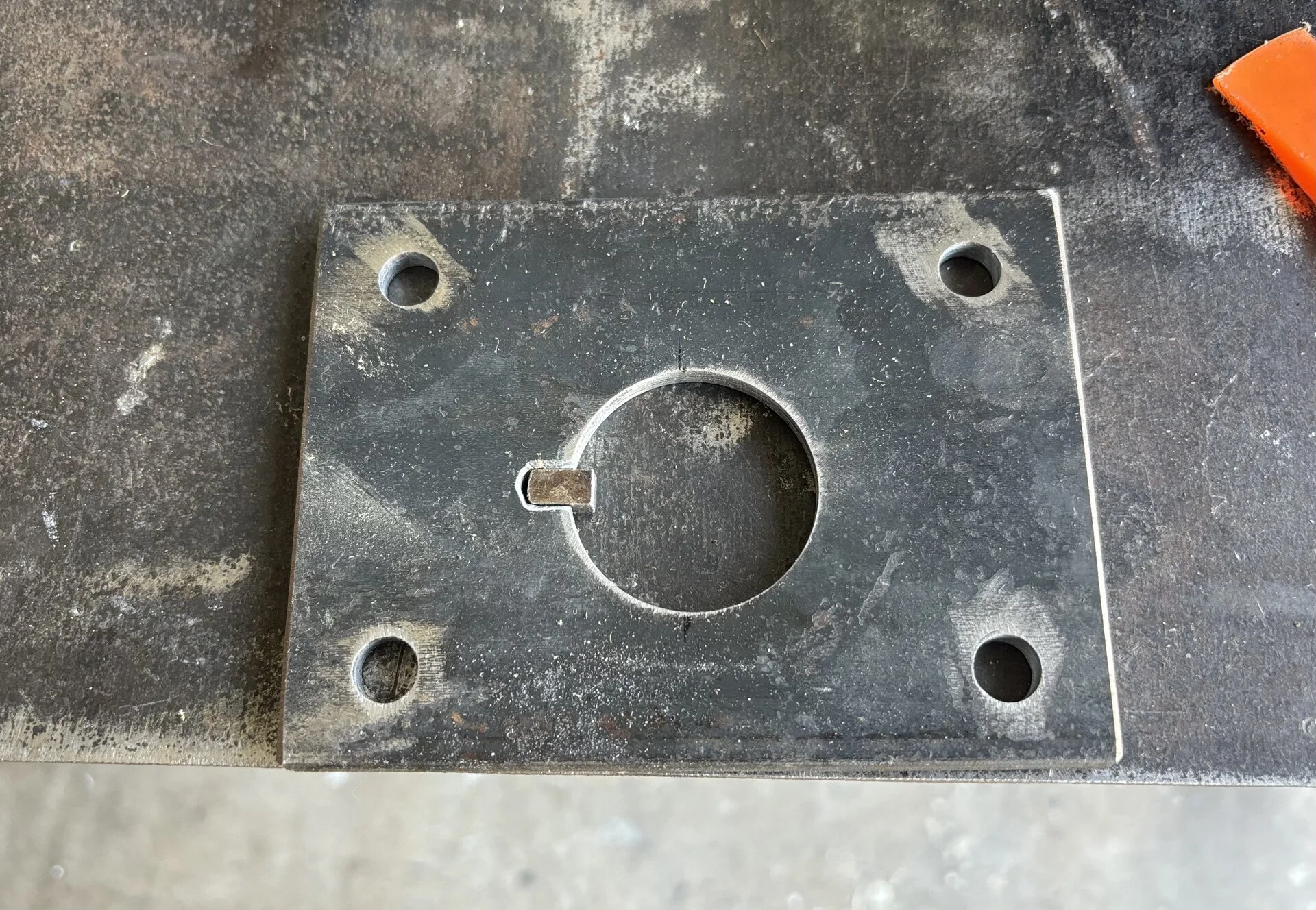

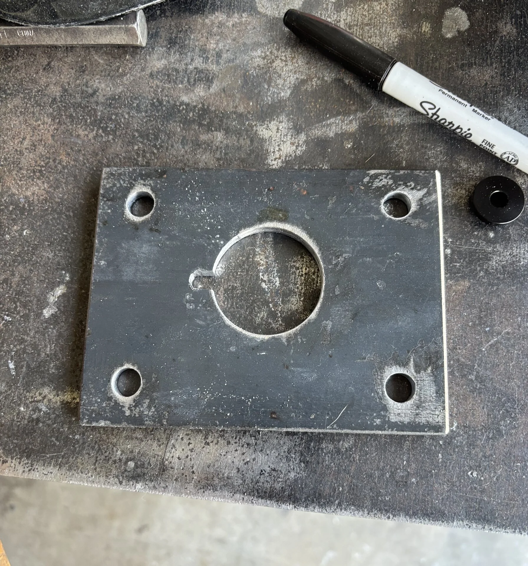

Took a couple steps backwards with the hydroboost flip (should have done it that way to begin with). Made a new mount. Will need to readjust the brake lines or make new ones. I’ll do that when I’m done with the engine wiring harness.

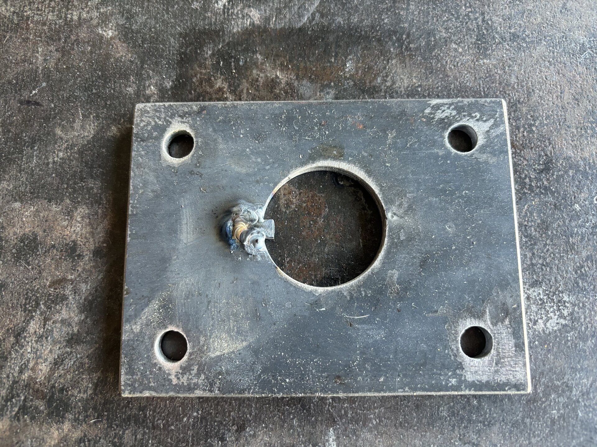

Instead of trying to cut around and shape out a locator dog, I just cut the 1-5/8” hole with a hole saw, and then welded in a locator with the TIG (more than one way to skin a cat). This is much better than the last design anyways, can actually get a tool on the nut to tighten it down properly. The studs are from the OEM GM mount from the truck it came out of.
