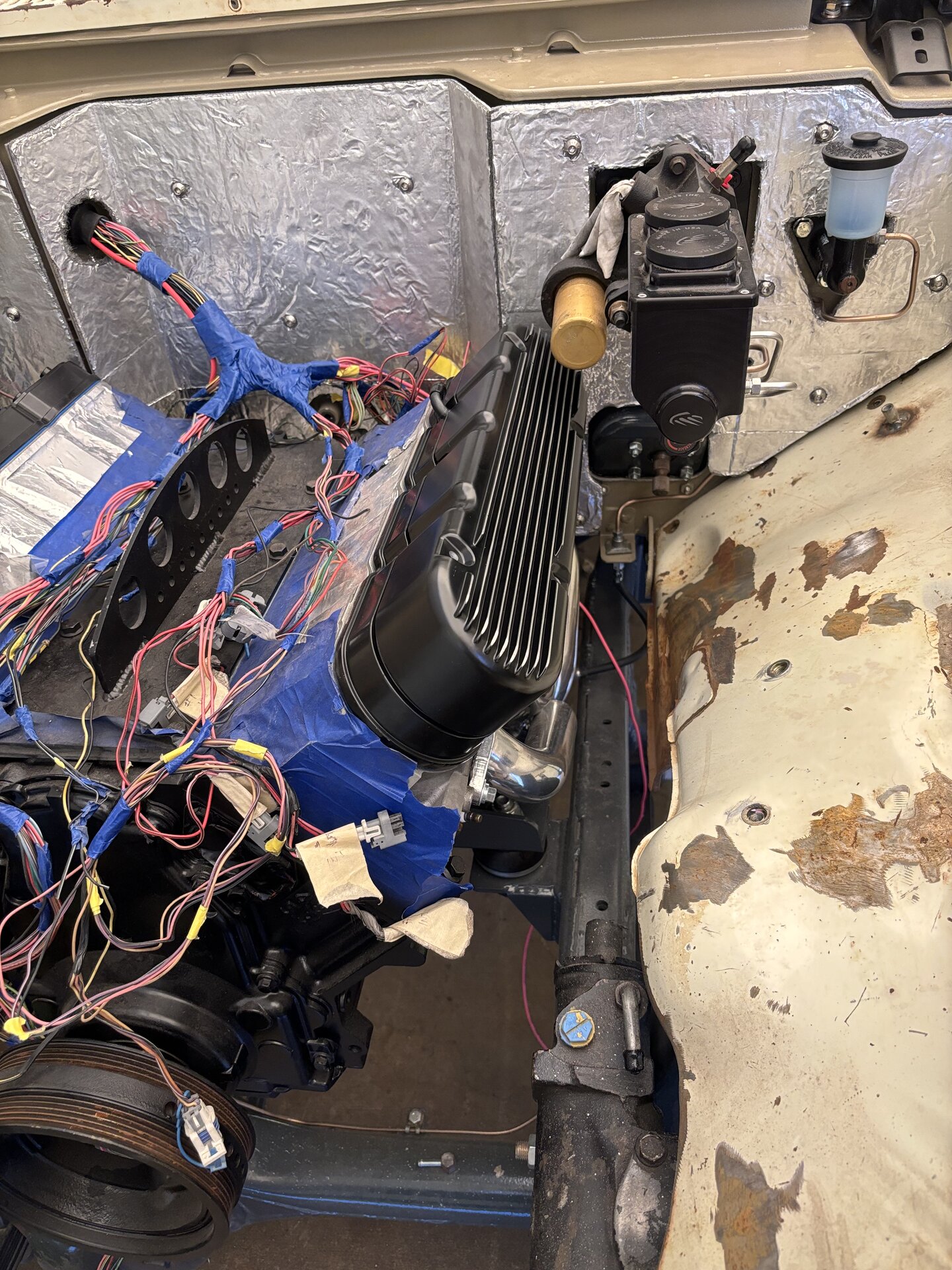

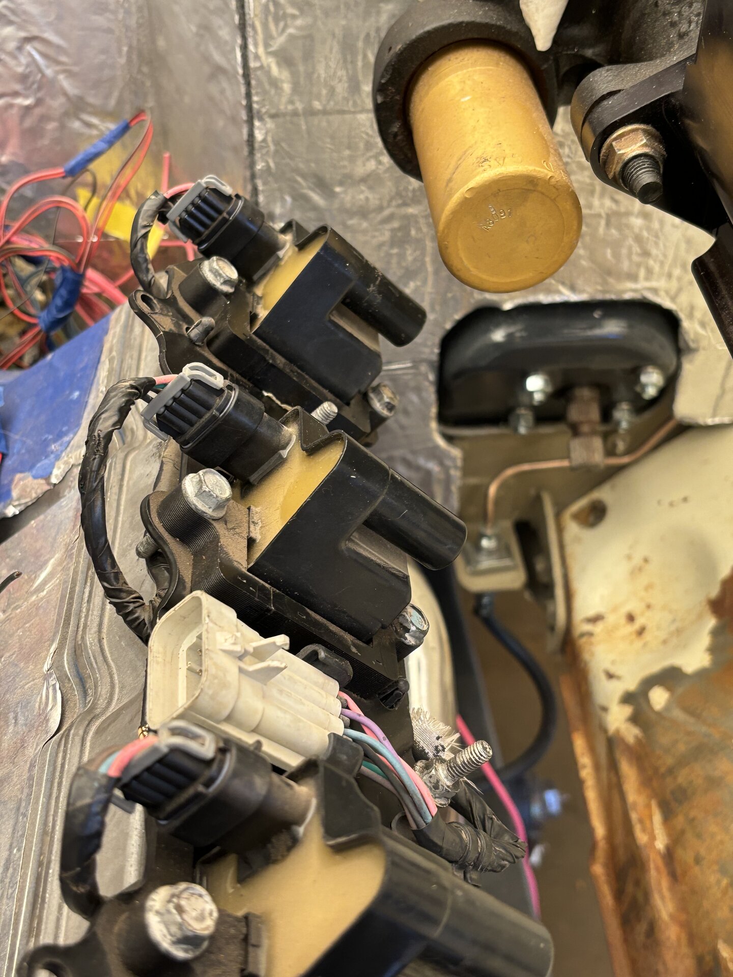

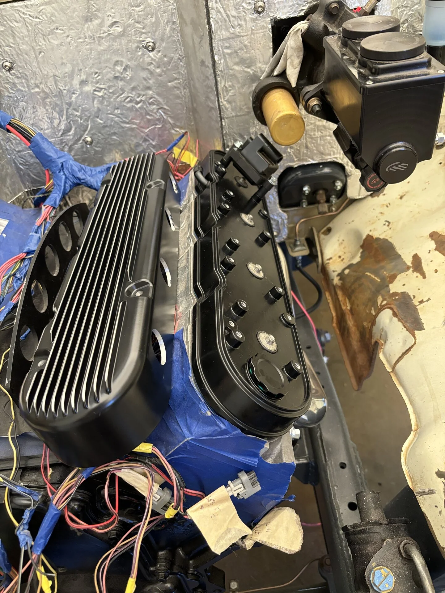

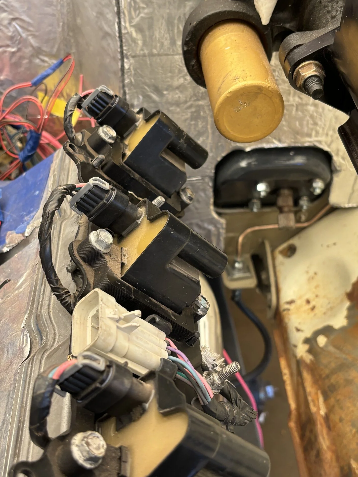

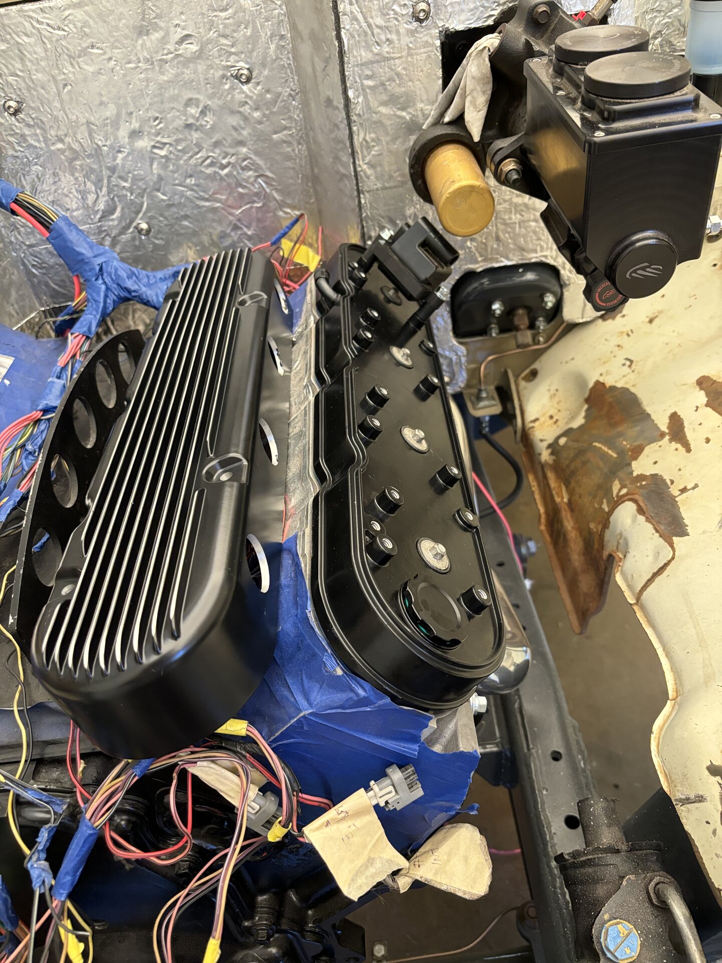

Tried to make appearances more sleek underhood with a set of coil hiding valve covers.
Unfortunately, they’re not going to work. Not enough clearance between the cover and the hydroboost to slip the cover assembly in place. To use a set of covers like this or similar, the coils would need to be remote mounted somewhere else. Then you’d have long plug wires running everywhere - not sure I see the point of that trade-off.
Even with the stock valve cover and coil position in place, there’s about 3/4” to spare.

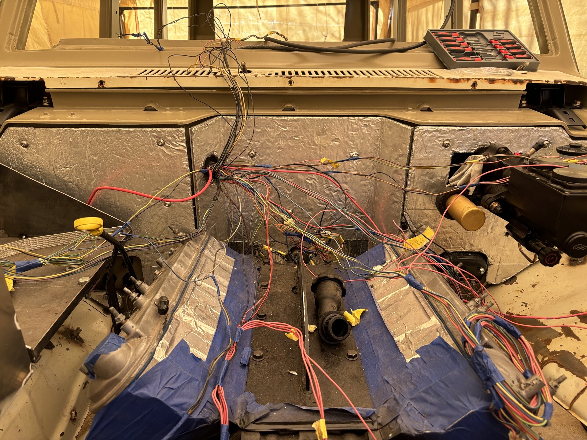

My O2 🐂💩 wich don't mean a thing! I would mount coilpacks remotely like the recess in firewall 4 on top and 4 on bottom and build a box or cube with access to hide them in 😘. Hide the wires in a tube or braided line or whatever your ❤️ desires! Mount the Valve covers and only use the hole at the rear to run to firewall 😘! No coil packs showing and only a short wire from back of valve cover showing 🧁🍰! Please tell us you are gonna address the inner fenderwell issue 🤔🧐💋❤️😘🧁.
Snug fit!
