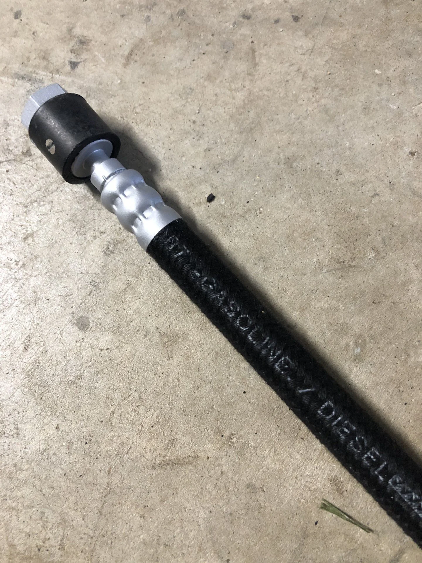

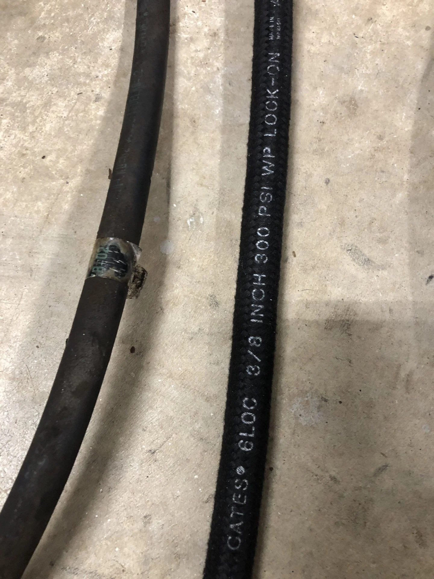

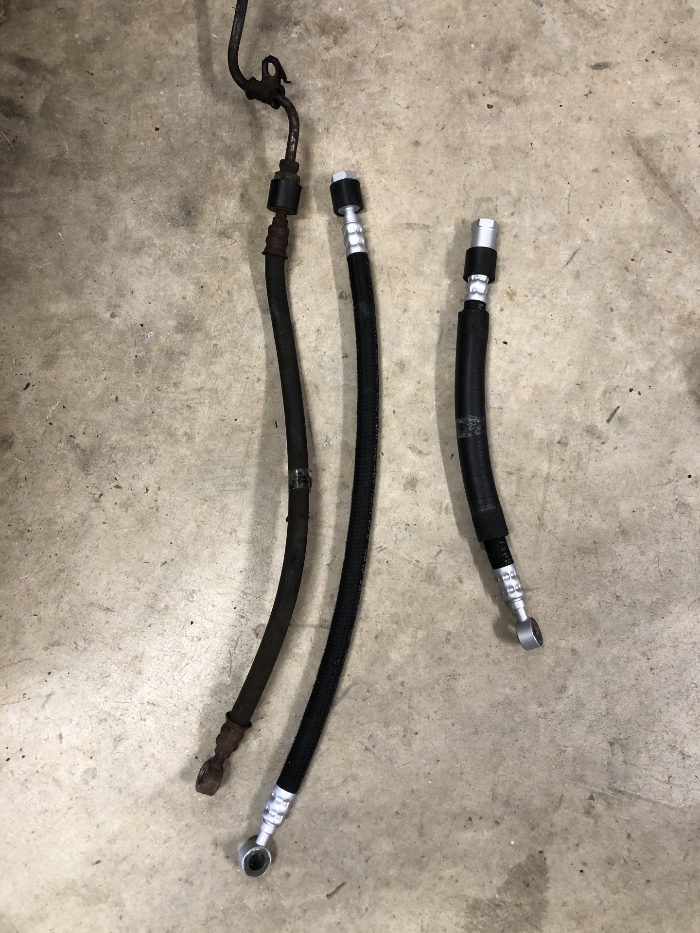

I happened to get this done last week. I took the lines that run to/from the fuel filter to a local hydraulic shop where they cut the old fittings off and crimped my old fittings on new hoses. I happen to have an extra line in pic on left to show before and after. The old line was rubber and the new one has a braided cover.
When I got them back I hit the ends with a little spay paint. The hydraulic shop charged $37 and change but not every place I called would do it. One that deals in heavy equipment said they didn't have hose rated for gasoline. Another told me fuel lines need to be certified and they didnt want the liability.
If I could have just ordered a couple all new hoses I would have opted for the convenience. My old ones weren't leaking but while I had some things apart I decided I might as well restart the clock on 30yr old hoses. I didnt think about the soft line over the gas tank - that one will have to last a while longer on its own :)

Was going to aak if the hose was fuel rated went back and zoomed in on the pics and can see they are. Witch is great but if you dont have the fittings you kinda screwed. Pretty sure @cruisermatt is looking for a complete replacement.
