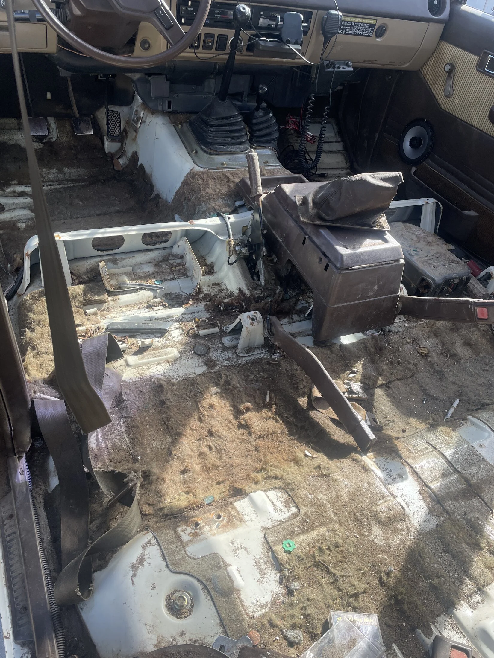

Hey guys so I ripped up my carpet and got some of the insulation off but there is a lot left, best way to go about taking this out?
There is also the old sound deadening black material in the front areas. I’ve heard about the dry ice method but was wondering if I should wire wheel it with a respirator. There’s dust everywhere
Planning on laying down kilmat and then doing a black diamond plate garage floor type material instead of carpet
Dry ice is the normal method, buy a bunch let it sit, then it will pop. I also used some isopropyl in the tough spots.
My build thread I did it first thing. I wouldn't wire wheel it. Would make a mess.
