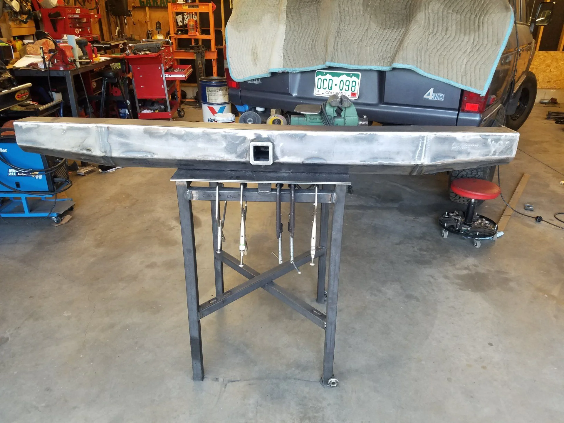

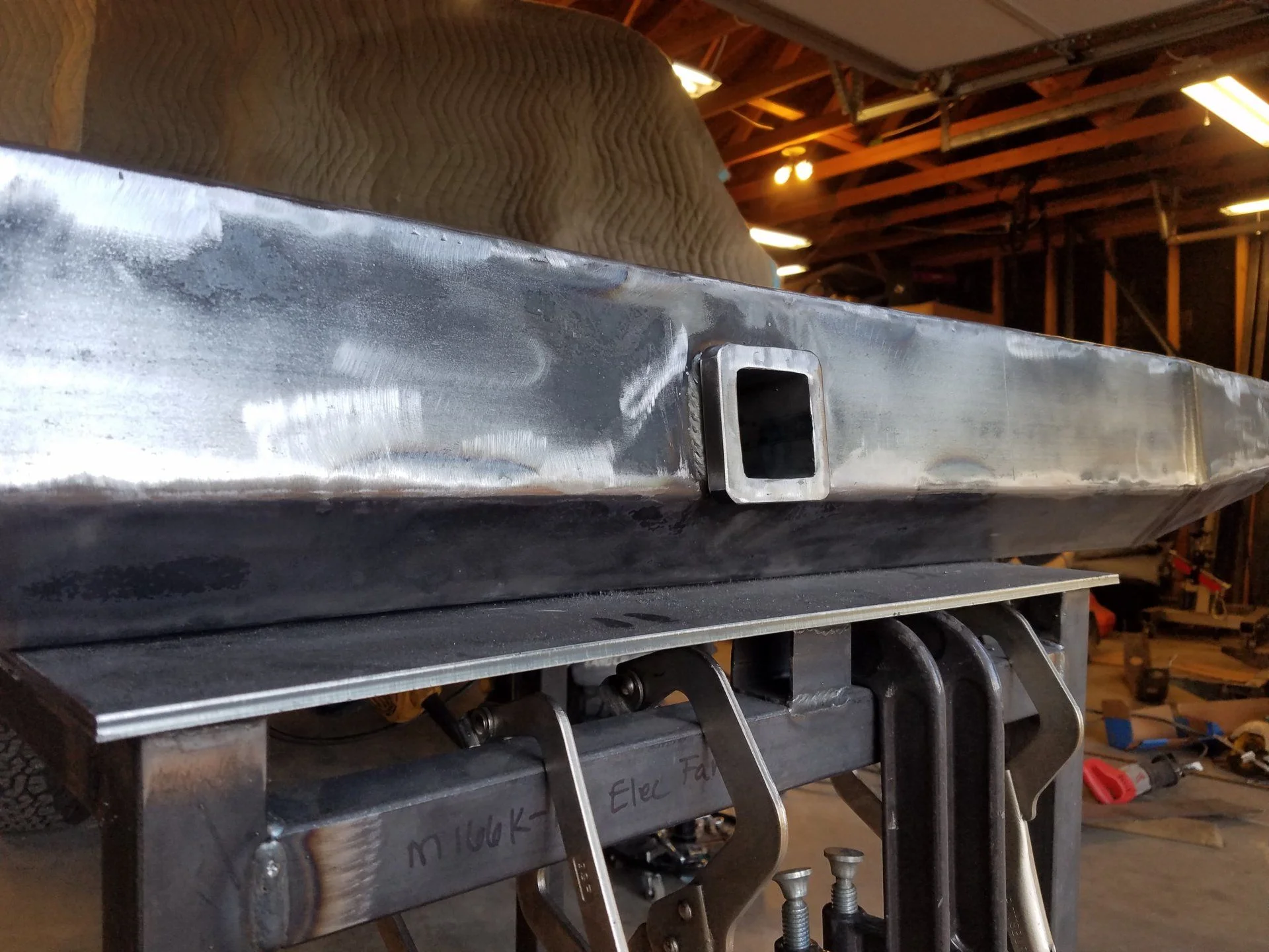

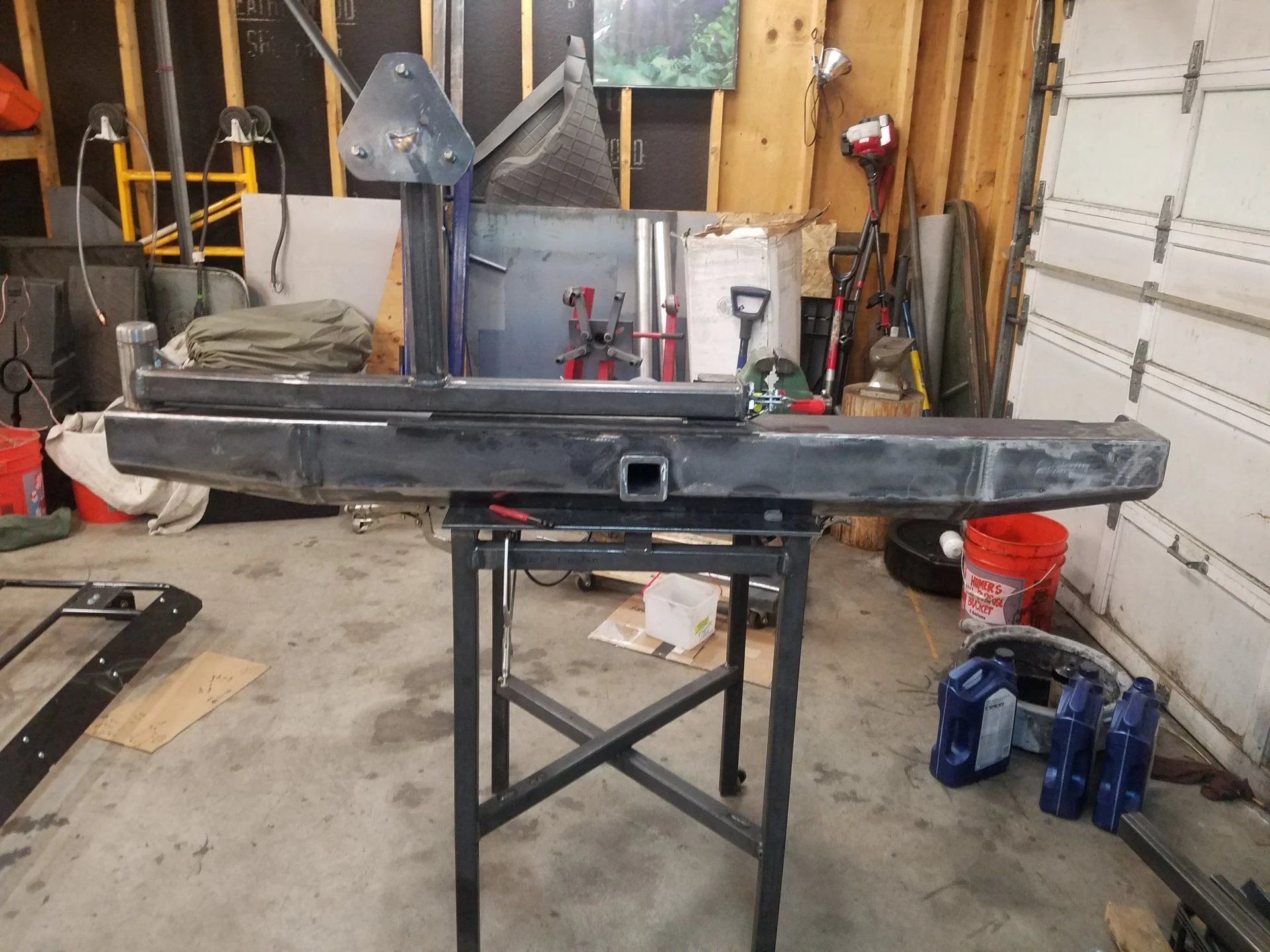

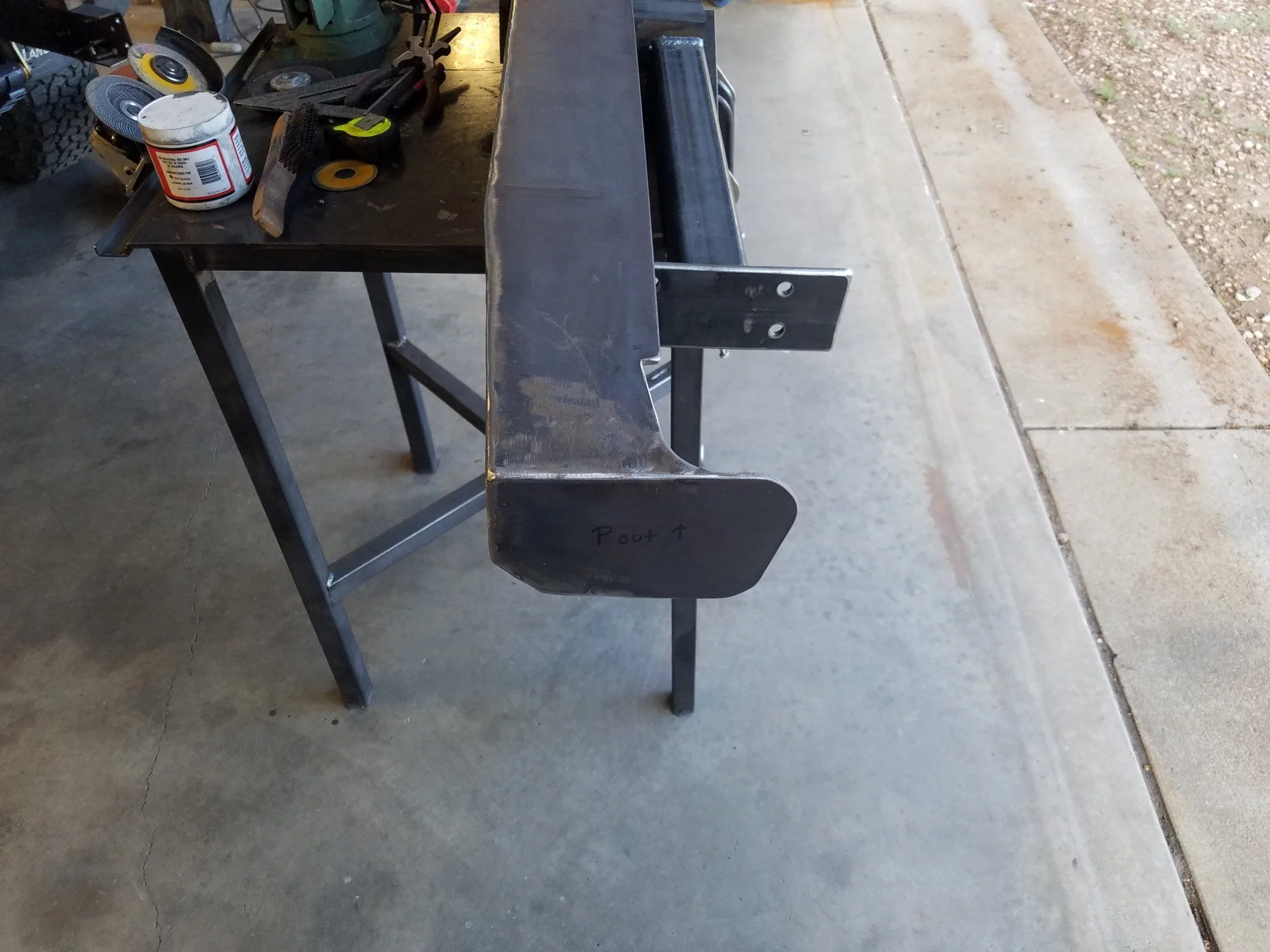

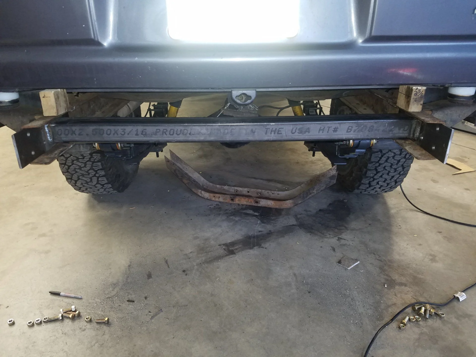

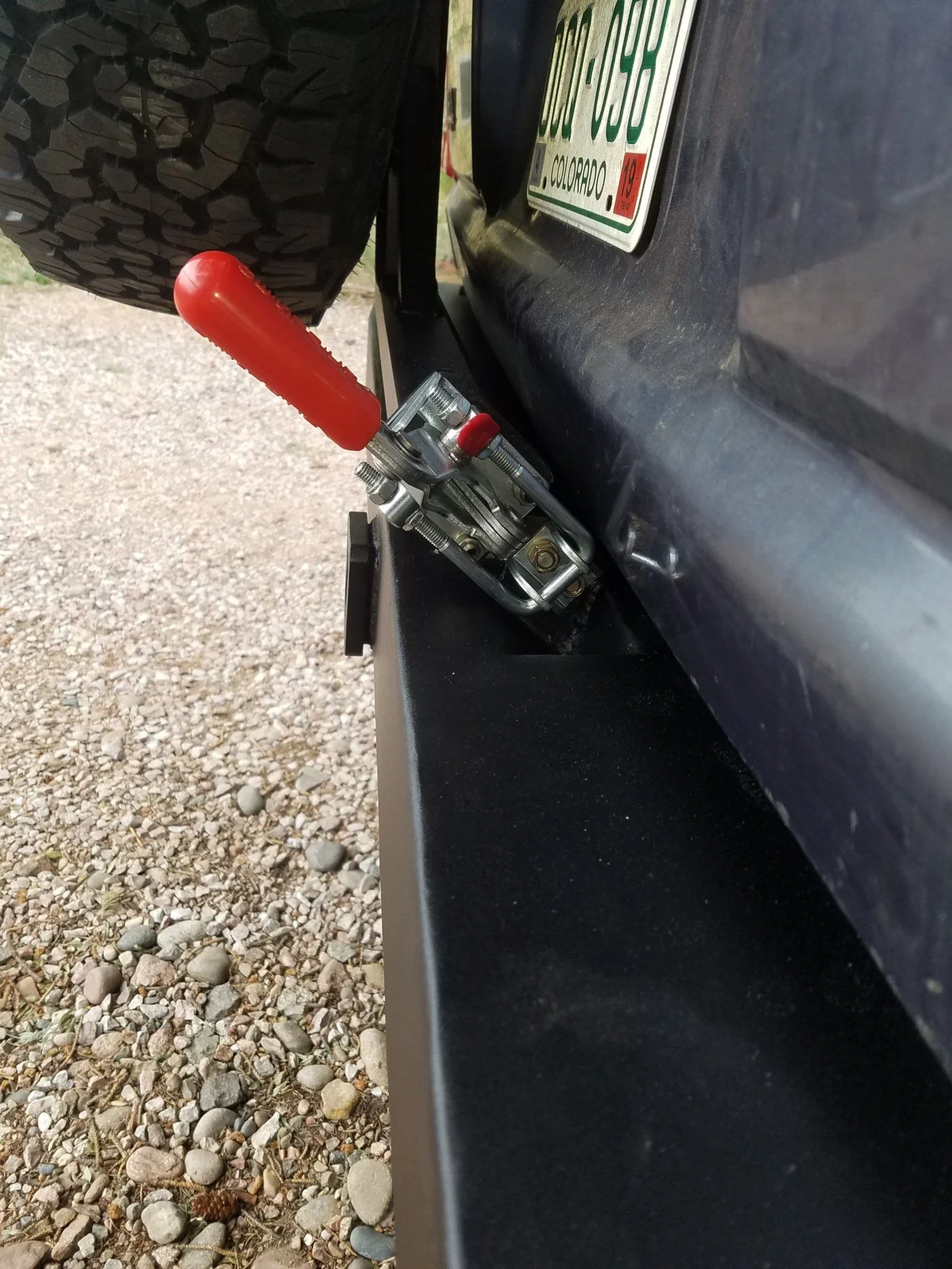

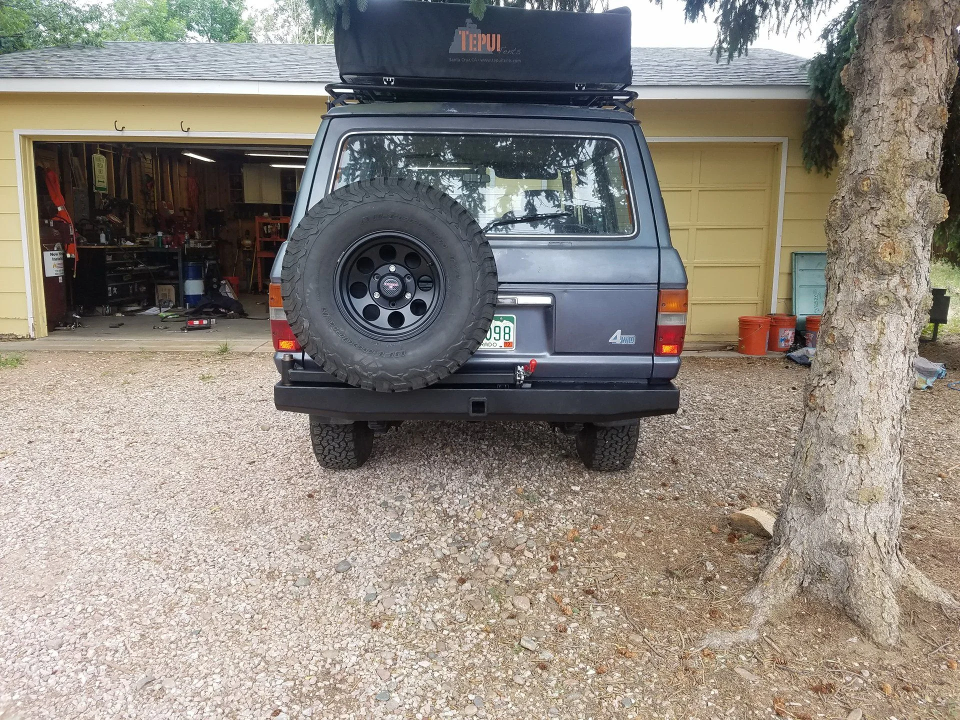

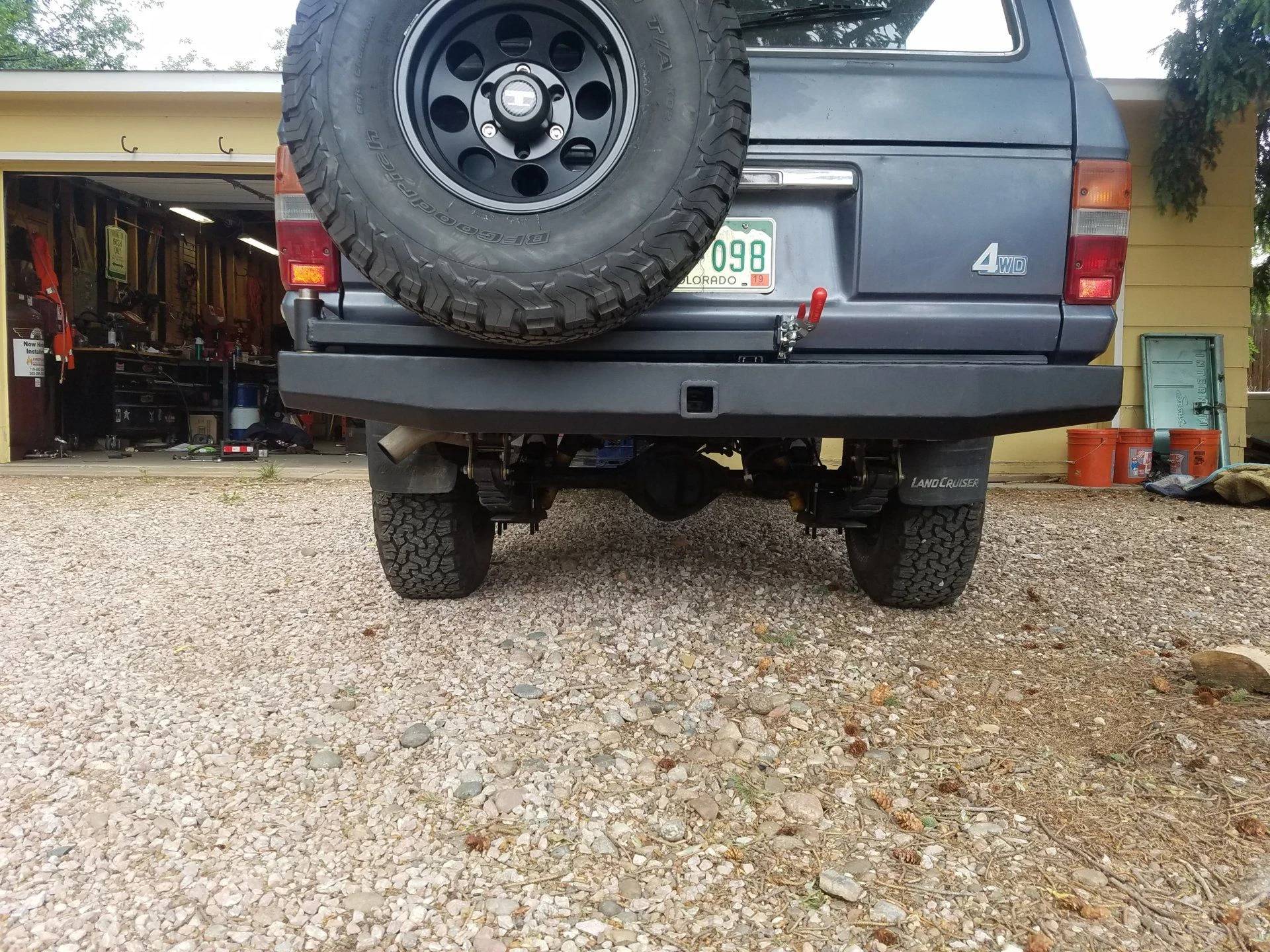

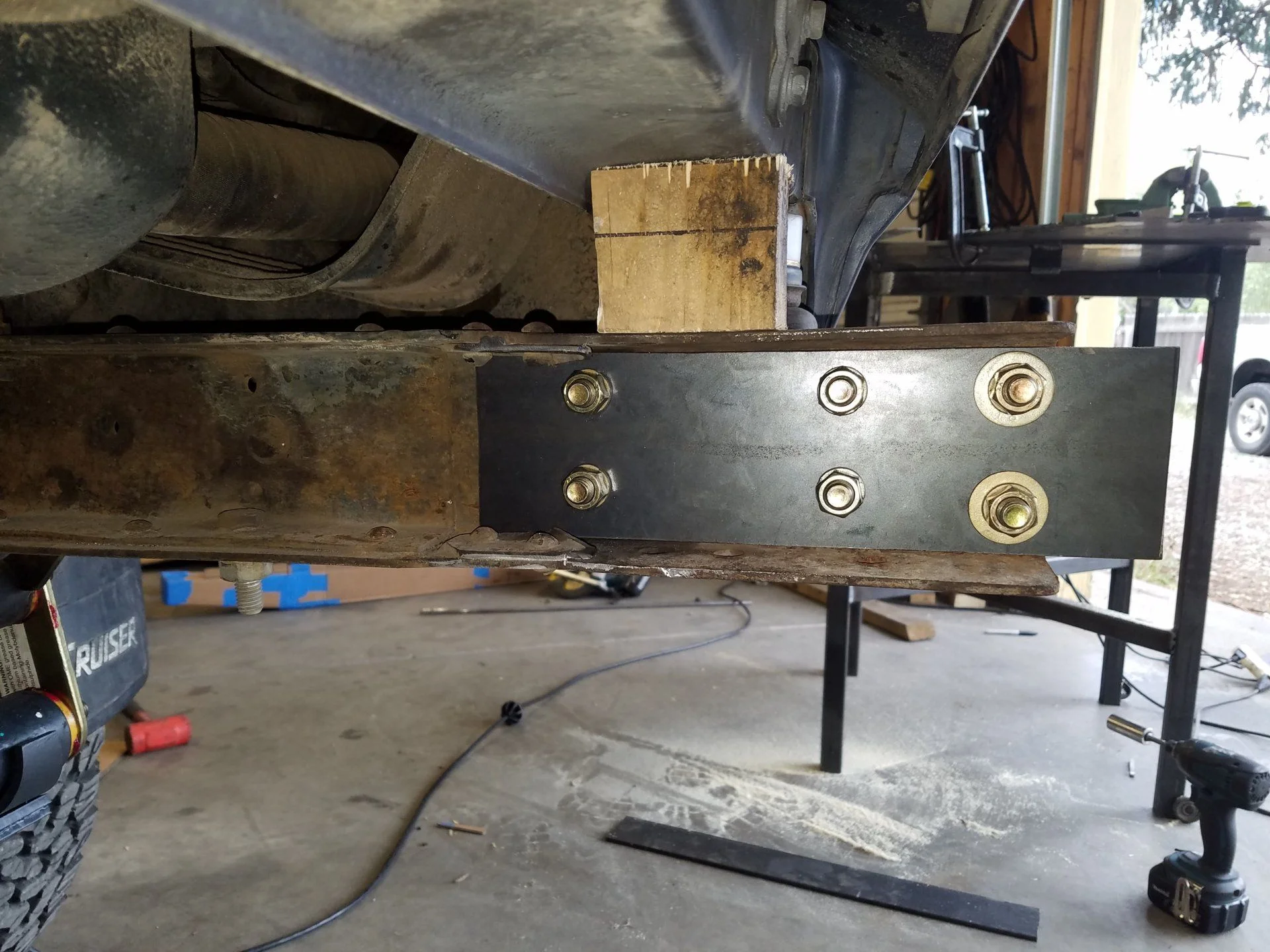

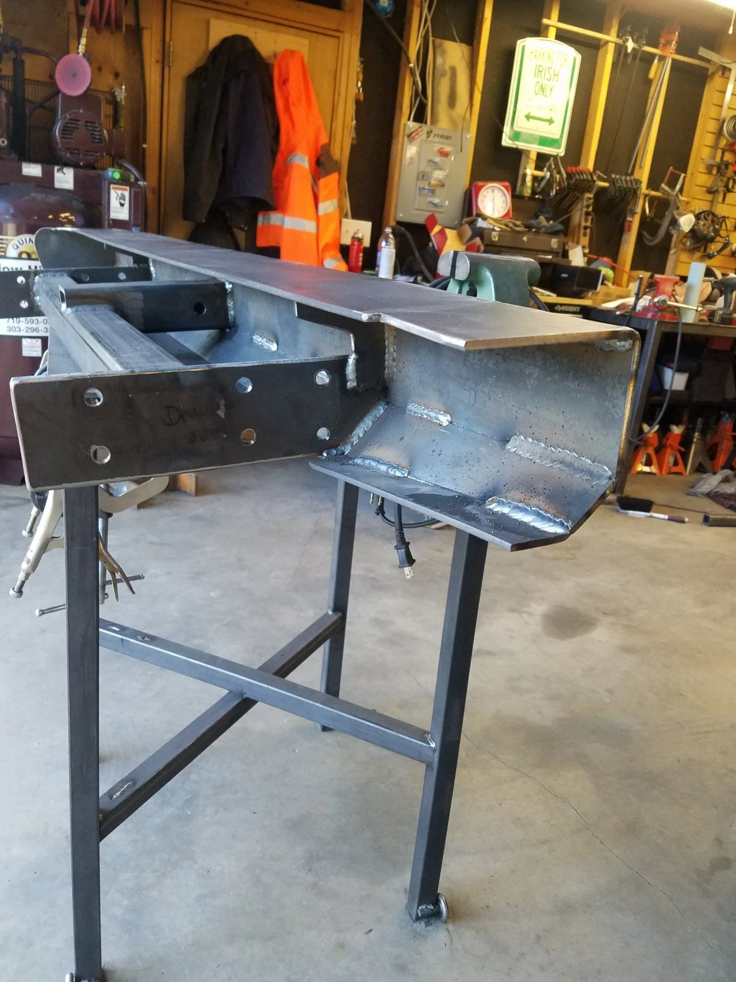

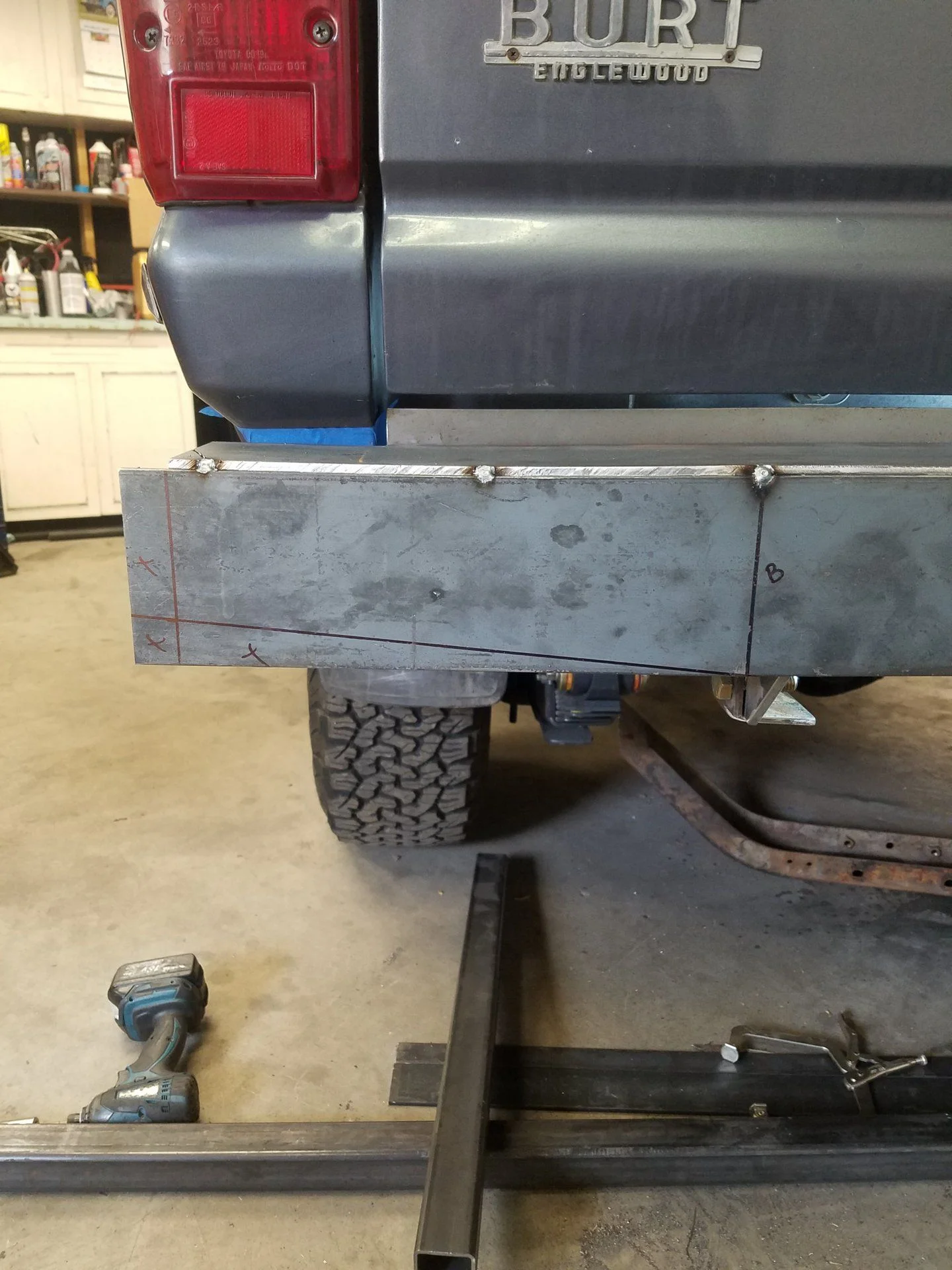

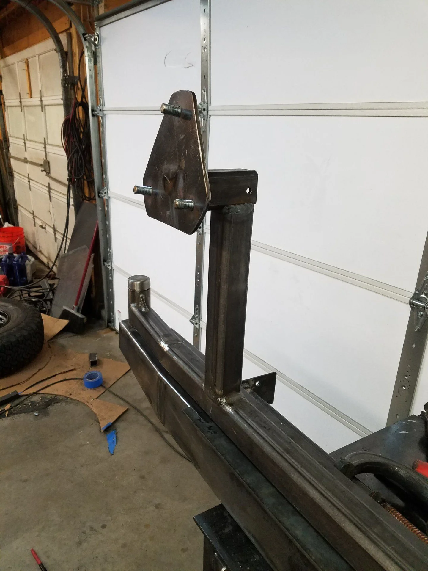

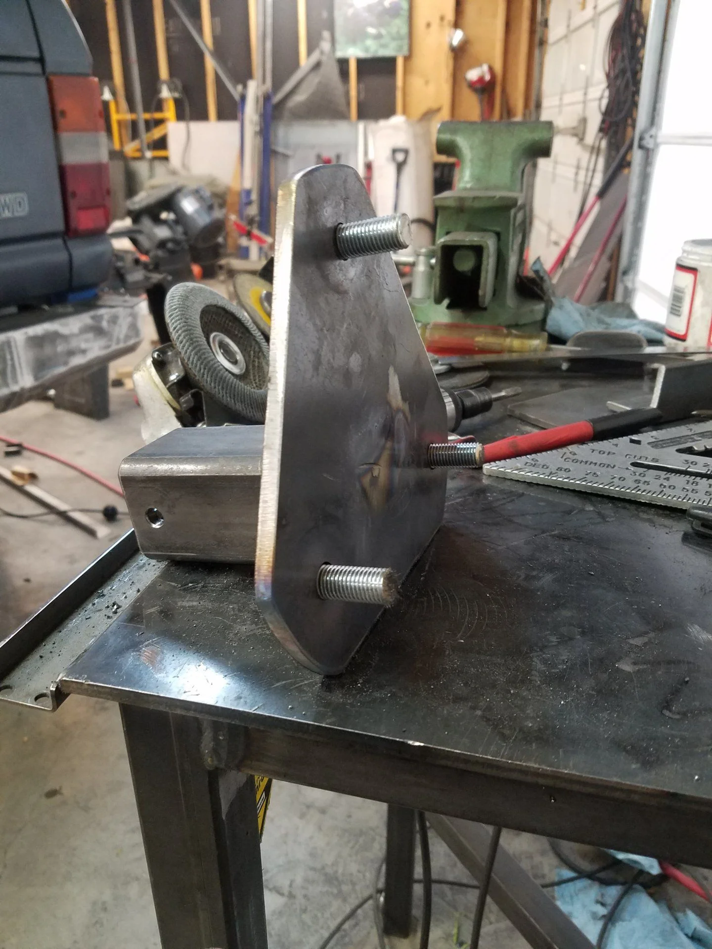

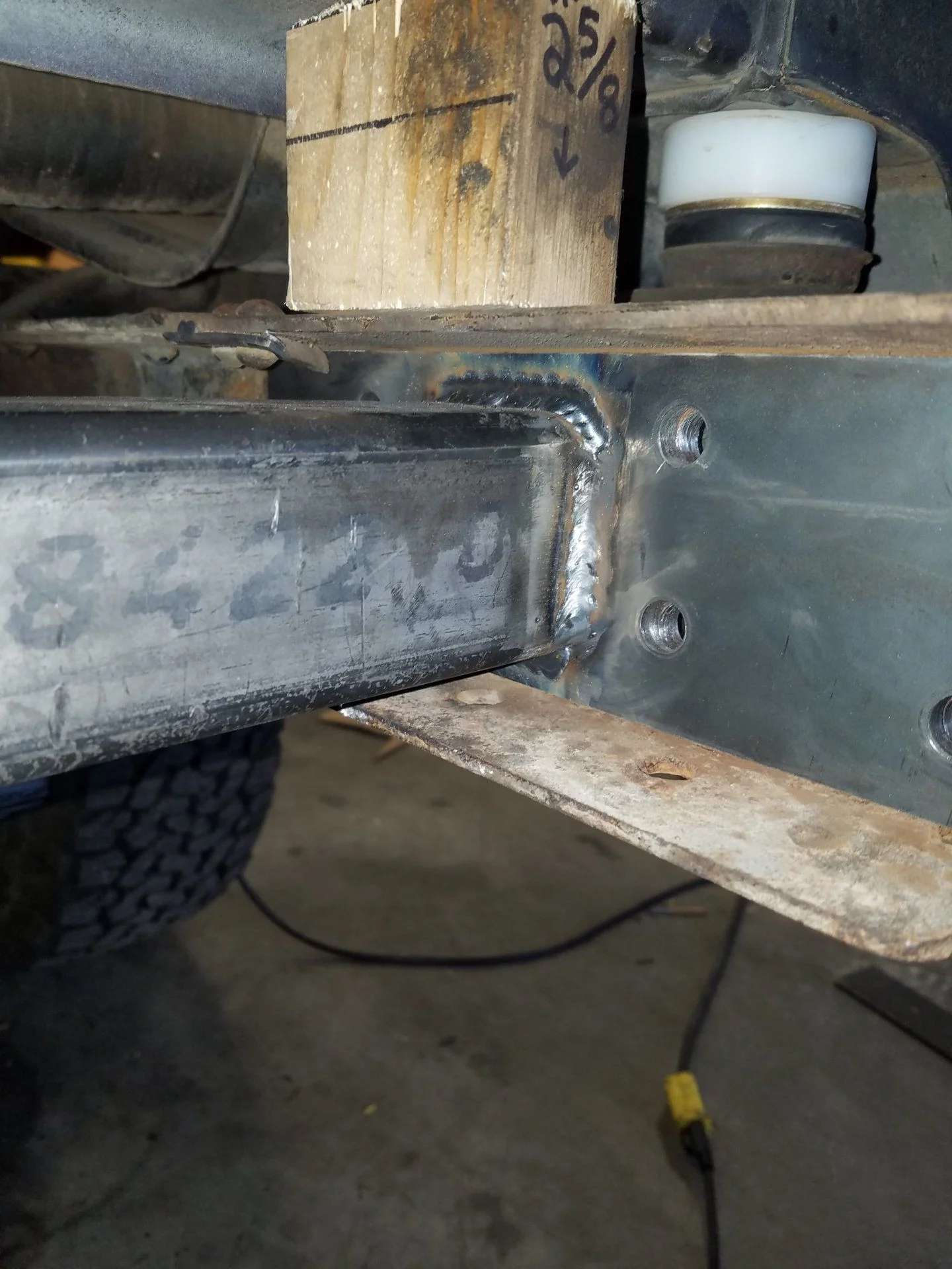

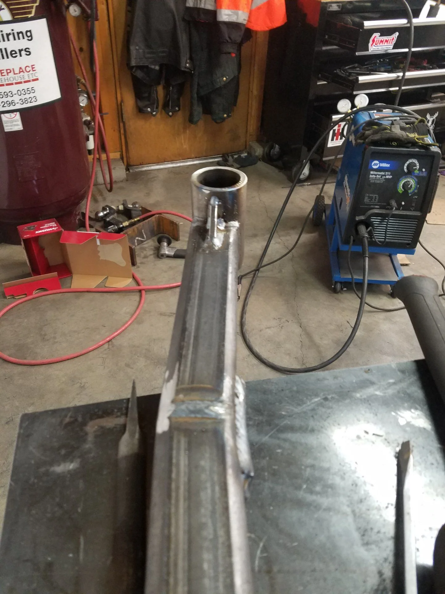

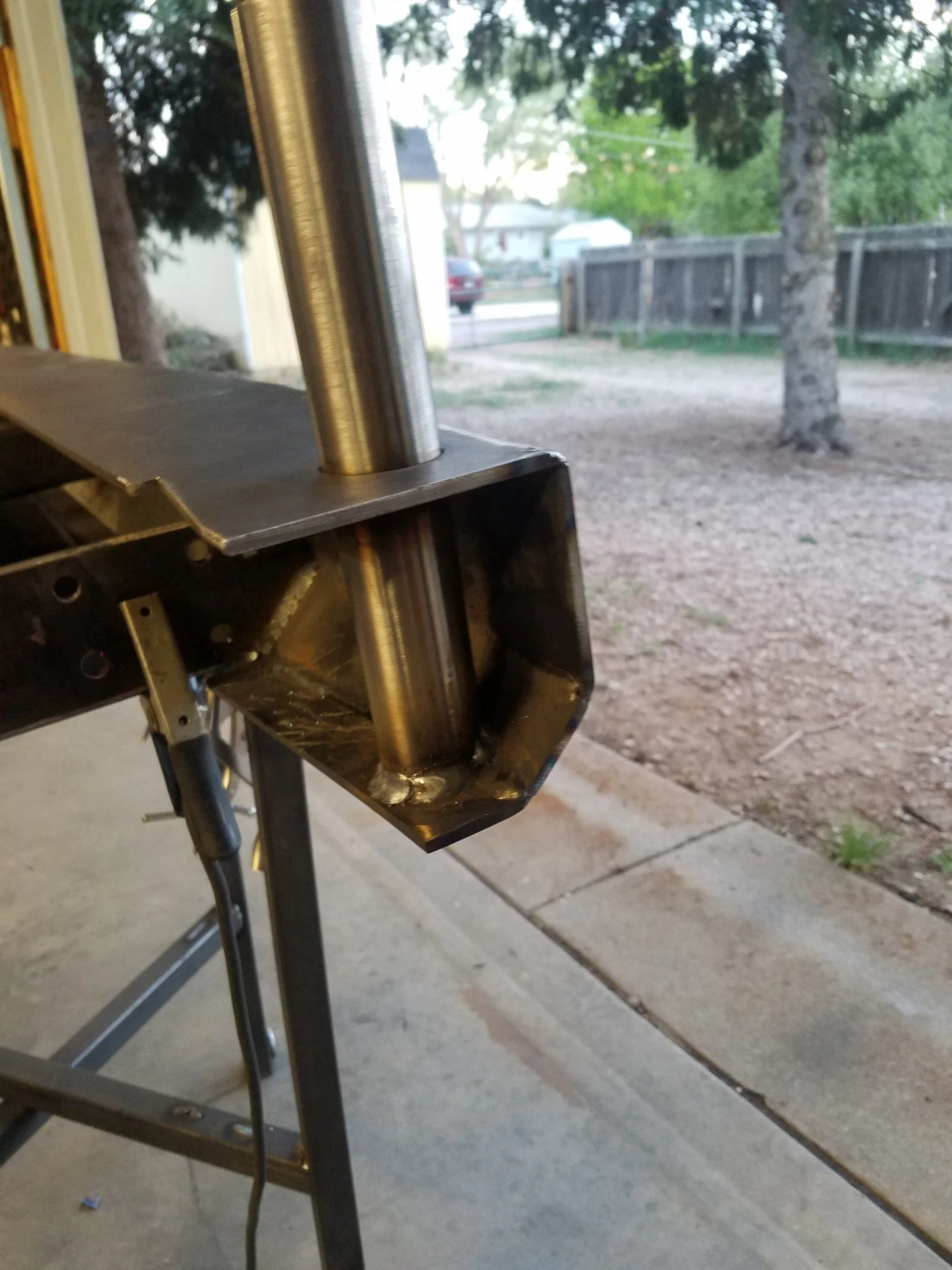

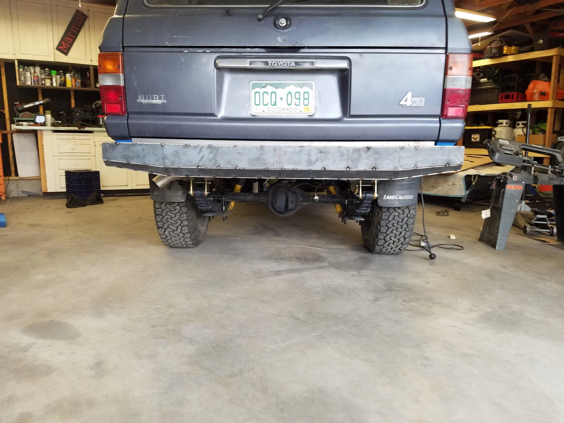

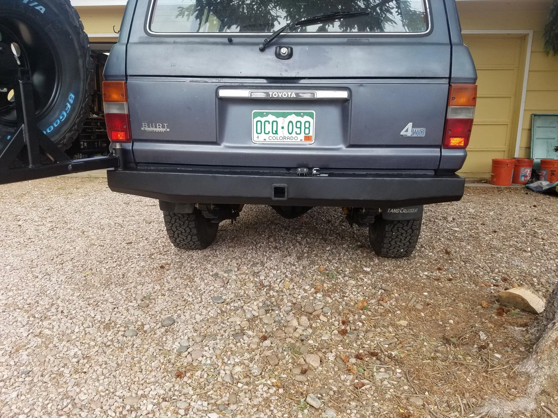

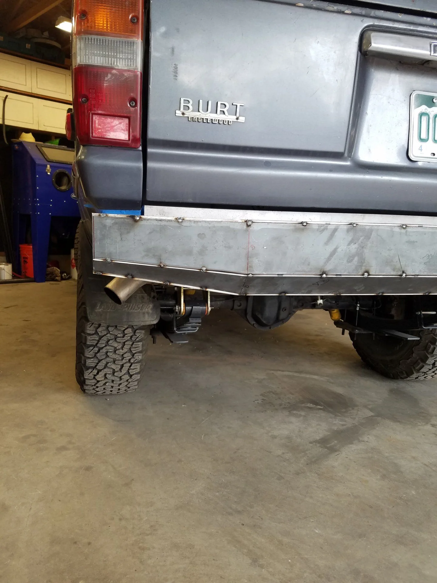

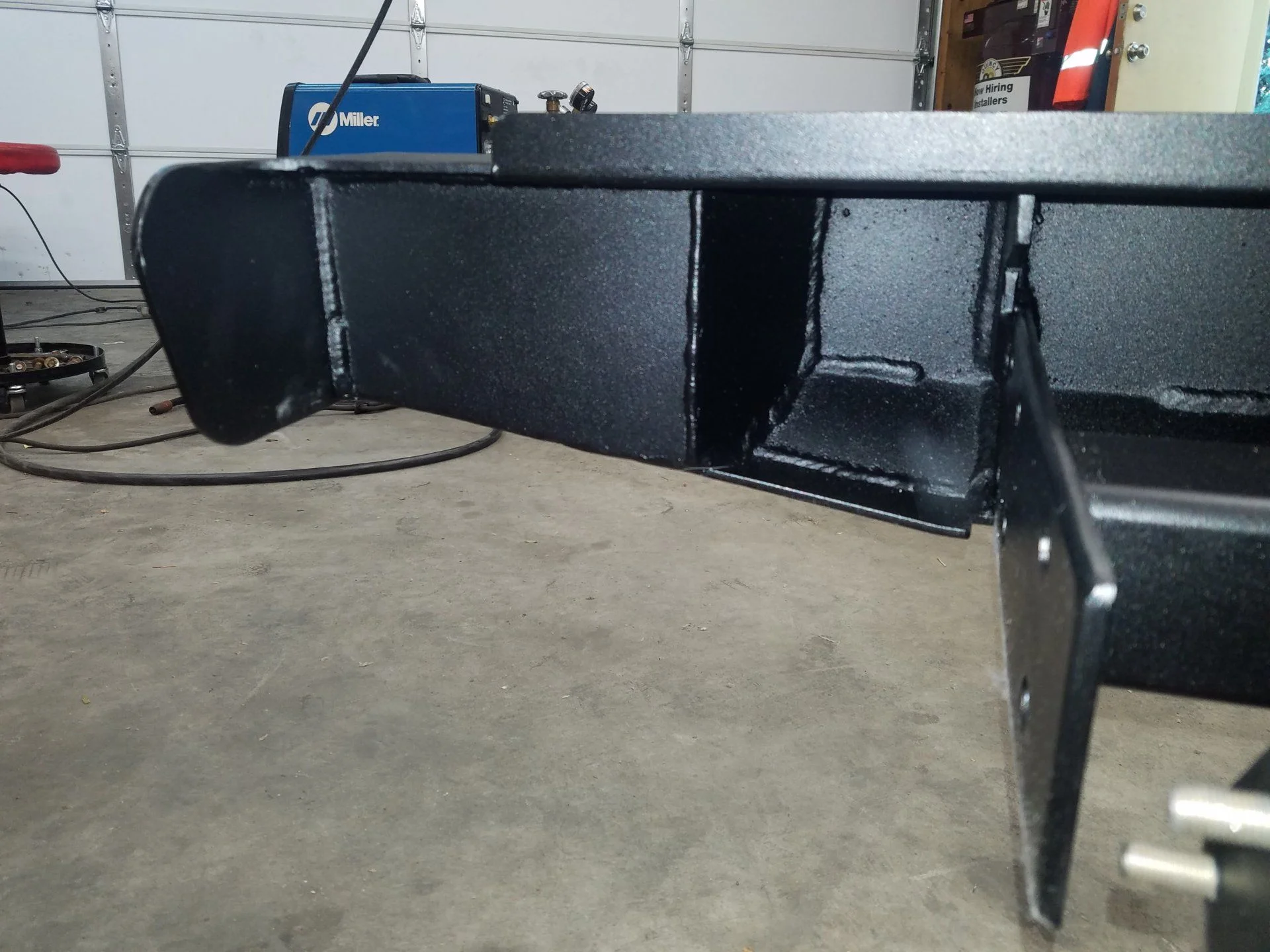

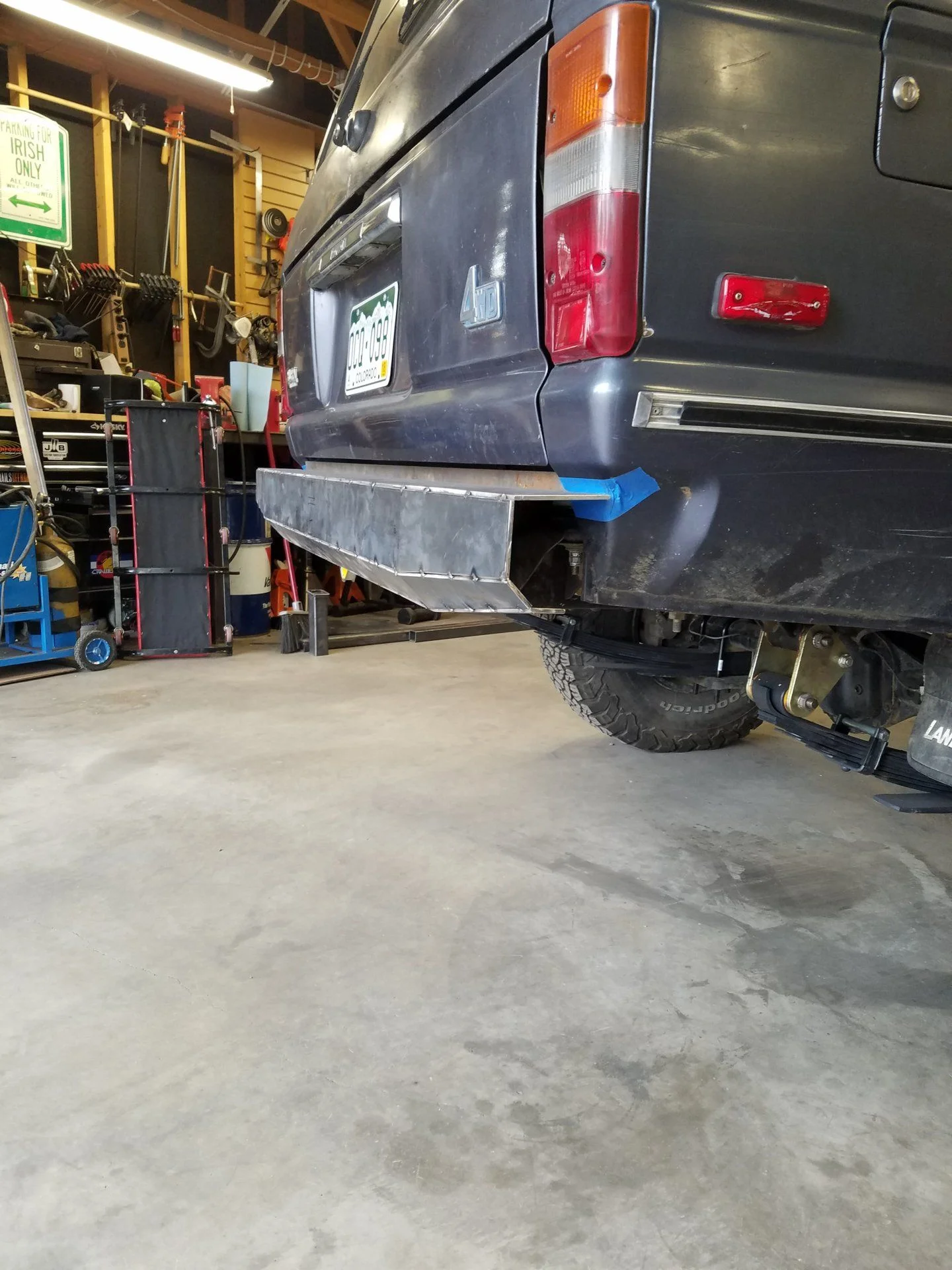

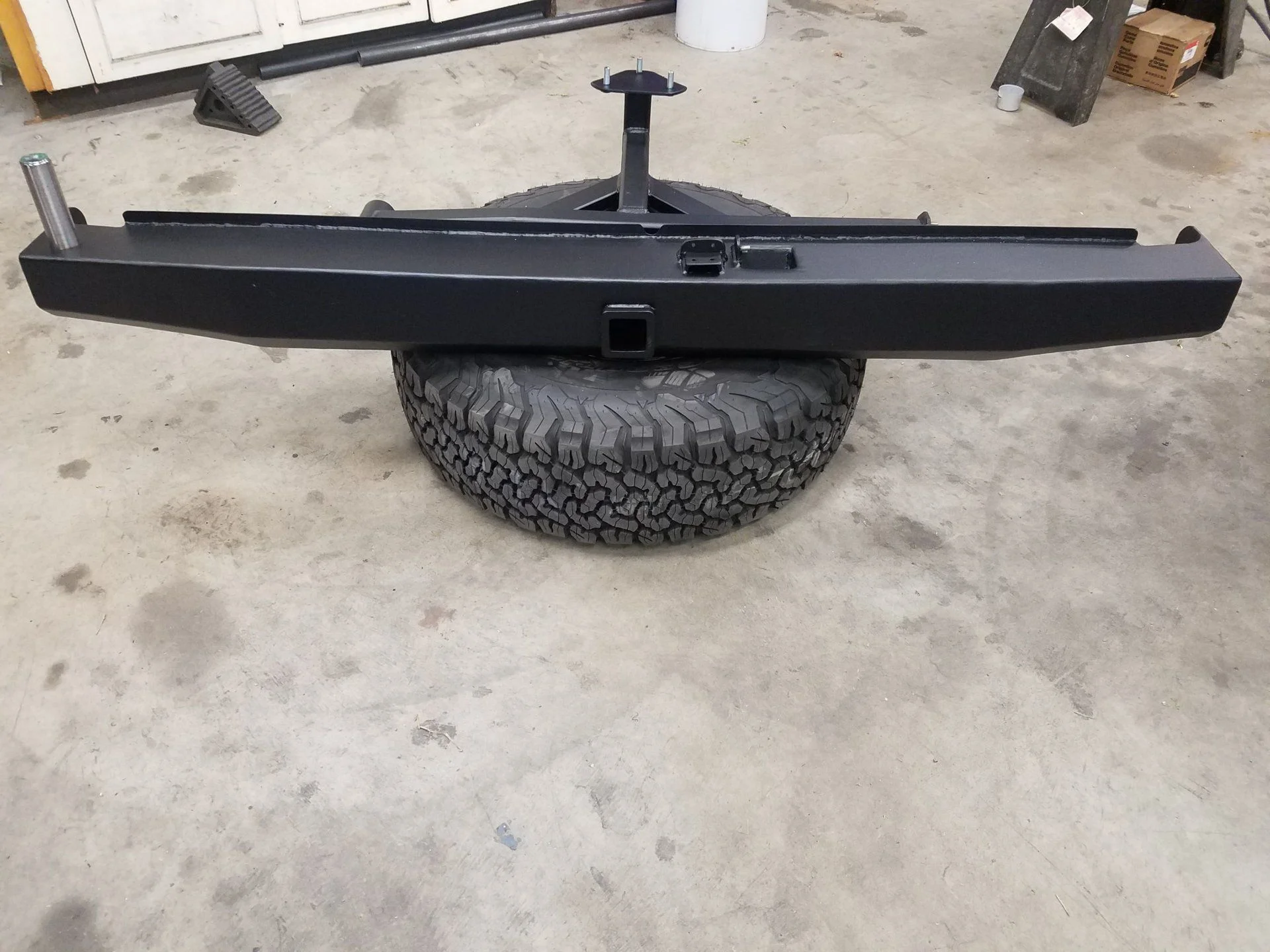

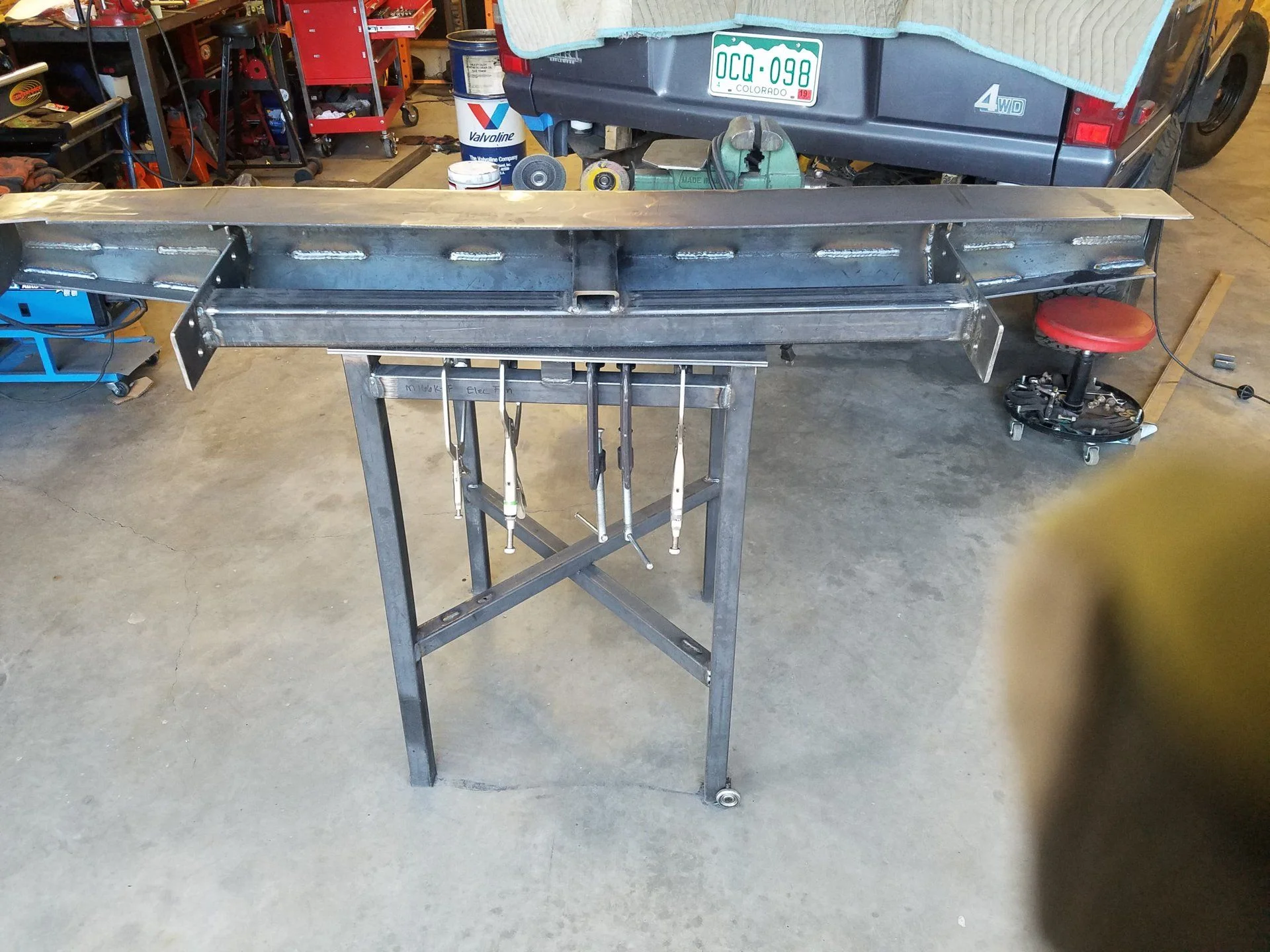

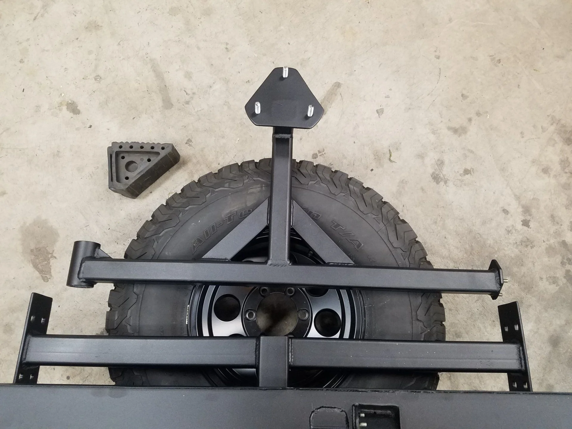

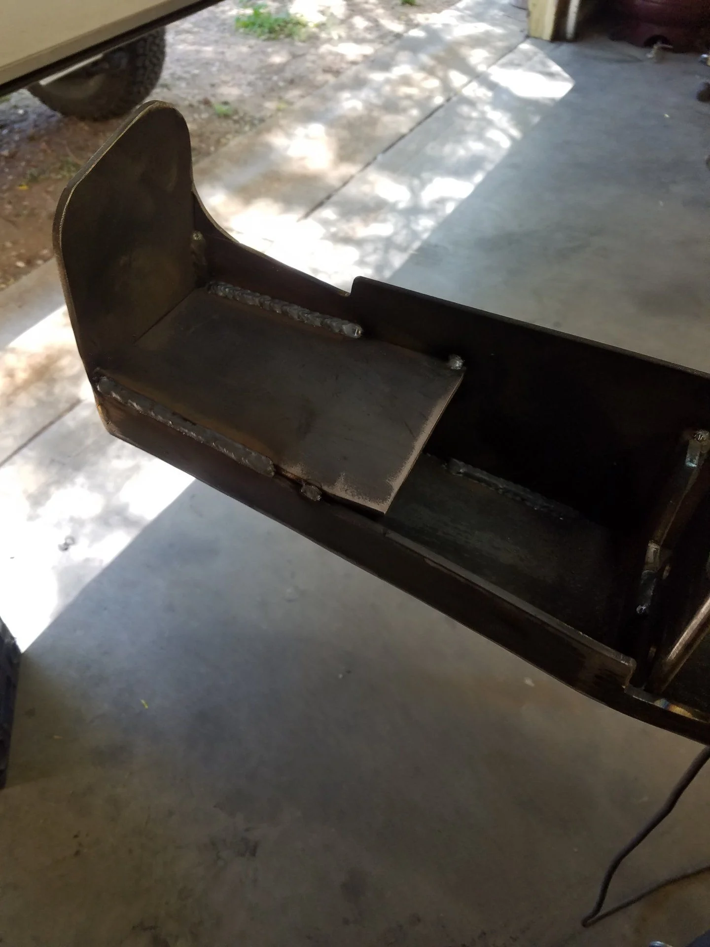

Hello all, I figured I would put up some pictures as I go along on my rear bumper build. It is going to have a tire swing out and an integrated hitch. I cut out the factory rear cross member and put in a 2.5in cross bar to attach my hitch to. I am going to bolt the bumper on using 6 bolts per side where factory rivets were before.
Really nice looking @mrniell , who did your powdercoating and what kind of turnaround was it?
