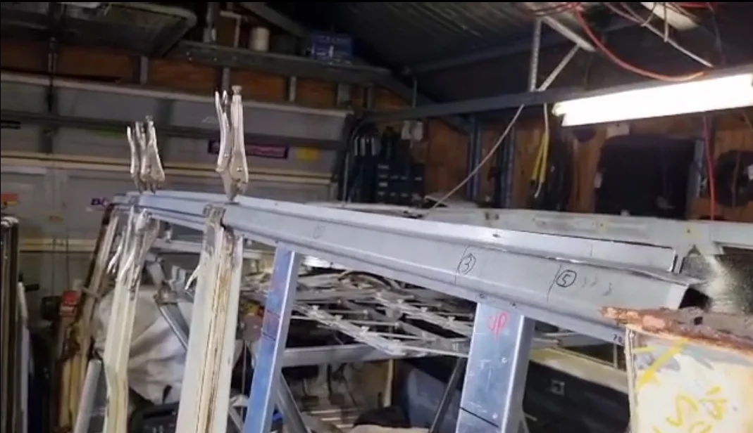

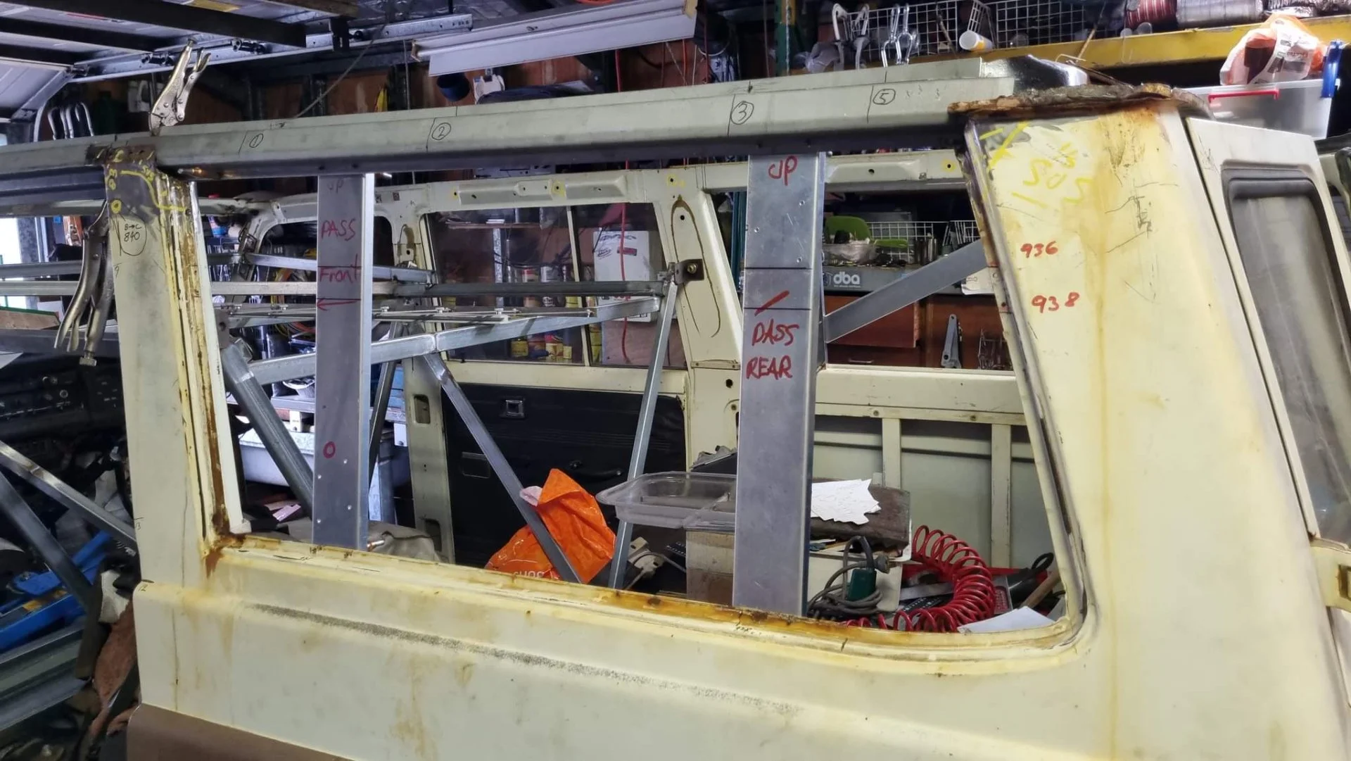

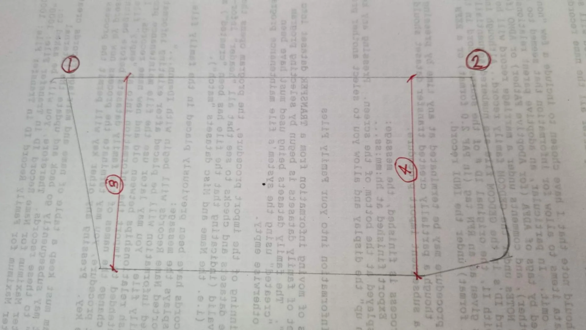

Rear passenger window fitment.
Finishing off the inner and outer roof channels, need to ensure the glass shape.
Like everything on the 55 it sightly tapers.
Had to allow for the rubber as well.

Posting the final product.
A to D Pillar Inner and Outer Channels.
Now to run another set for the Drivers side.
Been almost 6 months of tinkering on weekends, in planning and measuring. So happy with the final outcome
