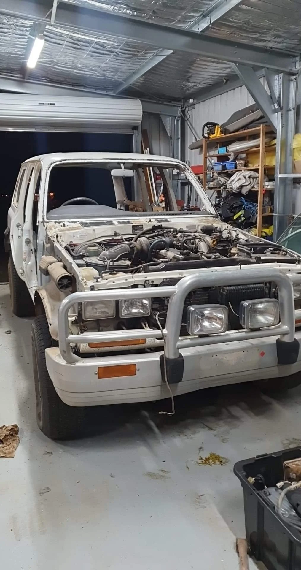

Purchased a 1FZ80 with 1FZFE and part time conversion. He keeps the cab, I get the chassis.
Long overdue update.

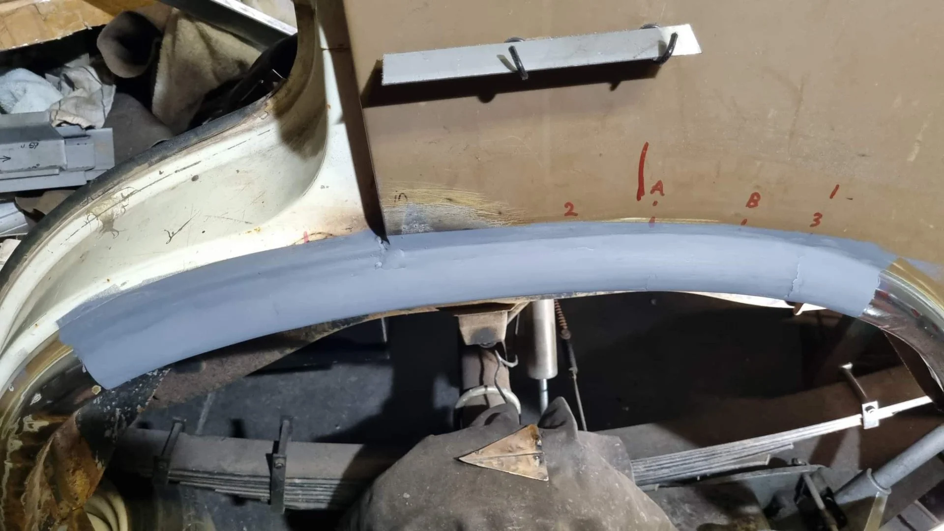

Rear flares.
Cut out the rusty parts of the rear. There was some inner channel sections which were dealt with also.
Mark, measure, cut.
Finally then smoothed off with rust converter and filler.
Also started pulling apart the 80 series donor car. Trying to keep all the wiring neat and labelled as the loom will be transfered as an entire unit.
Did you put the outer metal that cut out back in or make new pieces or filled in the space with filler?
Thanks for walking us through your work here.
All new metal.
Higher up in the thread on this page a jig was set up to roll the new sections into position.
