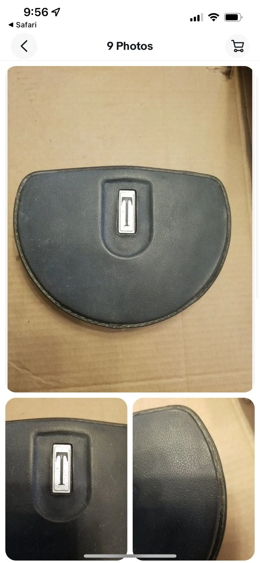

Does anyone know what the horn button on the steering wheel looks like on a 1969? I bought mine with no wheel, I just bought a wheel with no horn button.
I see some have a big button, and then there’s the small one here on an early 40.
The large one is correct for a 69 model, but it's not a horn button, just pad.
Do you know if the early fj40 horn button will fit my 55 wheel? Where’s the horn button?
3 buttons, one in each spoke. I think all 55 years have a horn button in each spoke.

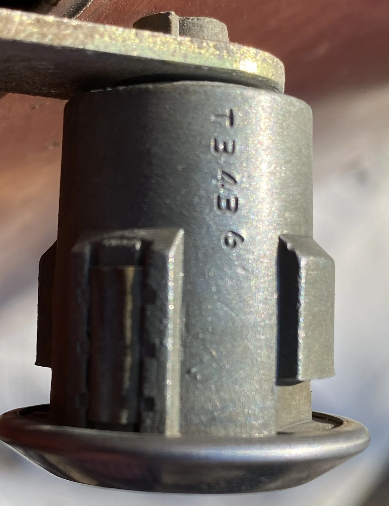

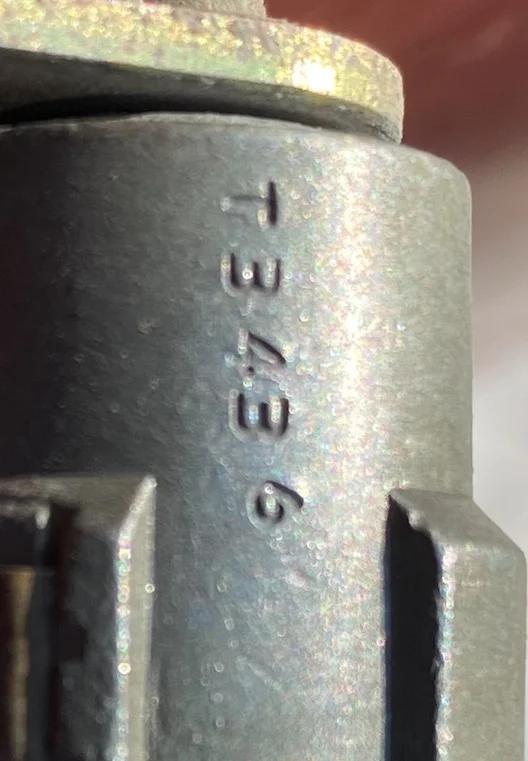

examples of a factory T-SERIES Key code stamped on a FJ55 1967-8/80 passenger side door lock cylinder
- 99% of the time its on the passenger side as it should be
- the other 1% of the time its actually on the drivers side lock cylinder for some odd azz reason ? 🤔
here is what your looking for in a perfect TEq world ......... :cool:
