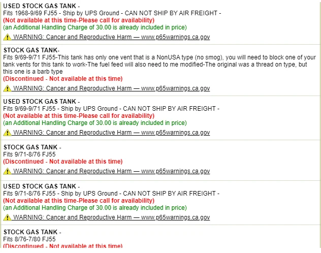

Would the changes in fuel tanks and mounting points be worthy of mentioning?
I would need owners to chime in and tell me changes to the fuel tanks so i can update the list.
There is this:
From this thread: anybody ever put an fj40 fuel tank in an fj55? - https://forum.ih8mud.com/threads/anybody-ever-put-an-fj40-fuel-tank-in-an-fj55.1247738/page-2#post-13767946
I have a 73 and a 77 fuel tank. The 73 rested directly on the frame and the 77 mounted to towers above the frame.
not sure when the design changed.

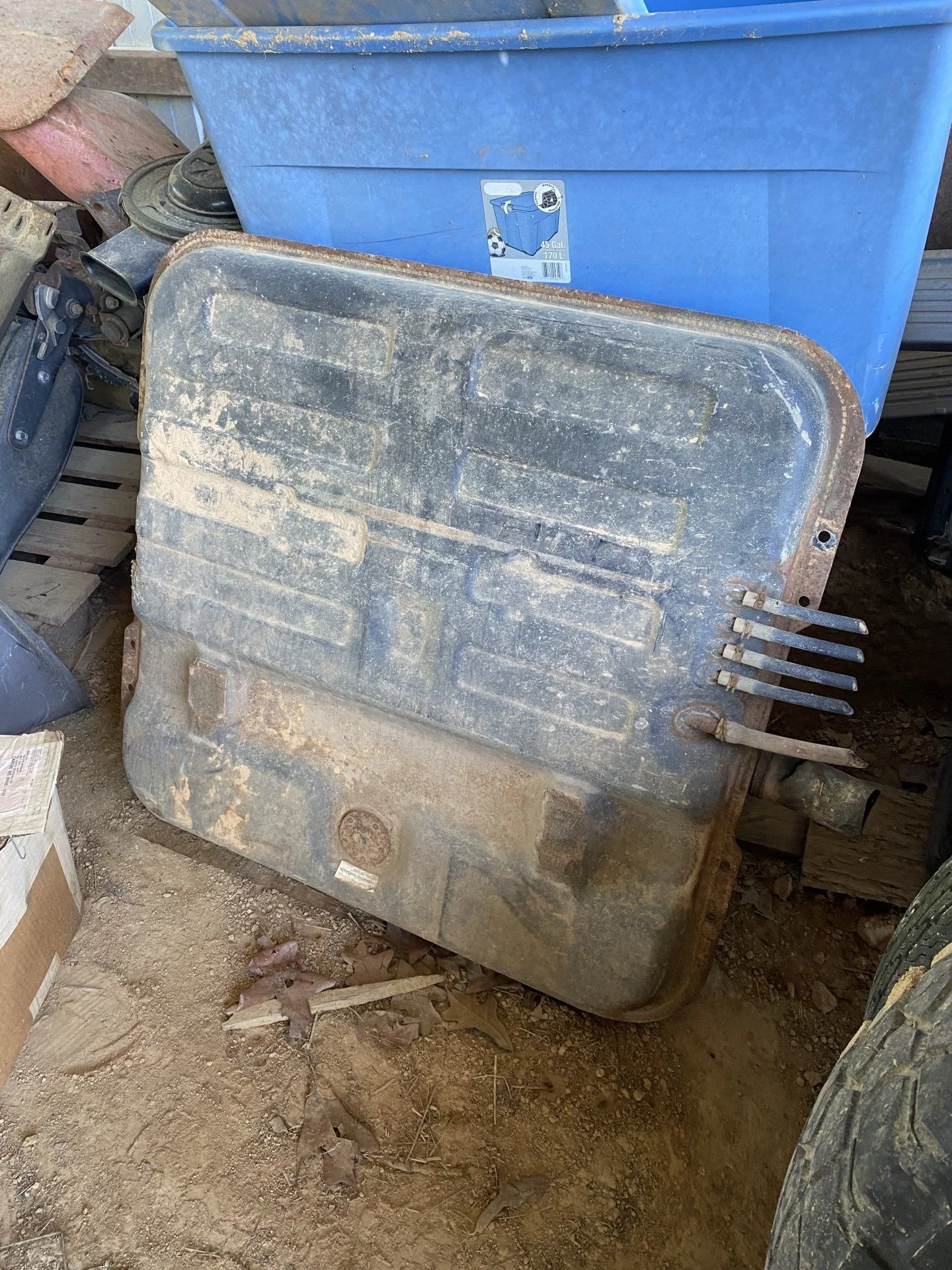

This is the 73 tank. I pulled it 3 or so years ago. I thought it rested on the top of the frame but it could have been the body.
I just know it’s a lot different than the 77 I put the LRA into

What are you doing with that tank now?
The reason I figured out they were different mounts was after I did my LRA tank Georg had a customer buy a tank. They list as 68-80 as the same but they had to source the mounts from the frame like I have to make the tank work on a older 55
Did you put frame mounts on?
My 77 had them. The LRA needs them.
The early truck needed them to make the LRA work so they made some in the end
We’re the bolt holes in the top of the frame already or did you have to drill?
I guess I’m confusing people here.
My 1977 has the risers above the frame. The LRA went right on them.
The 1973 tank I removed from the donor Pig did not have the risers.
Right after I installed my LRA Georg called and had me troubleshoot with a customer how to make his LRA fit his early pig.
Turns out the LRA is designed off the later 55 like mine.
