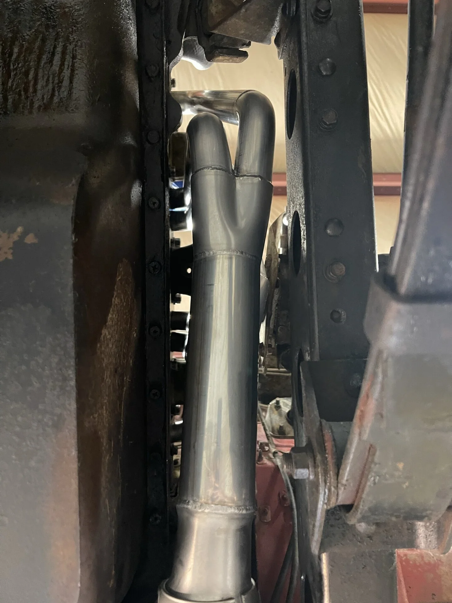

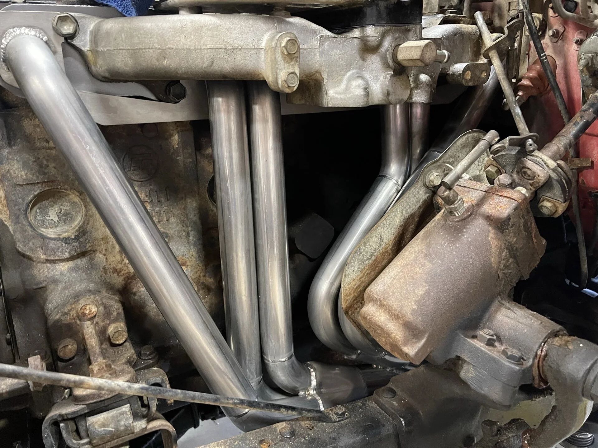

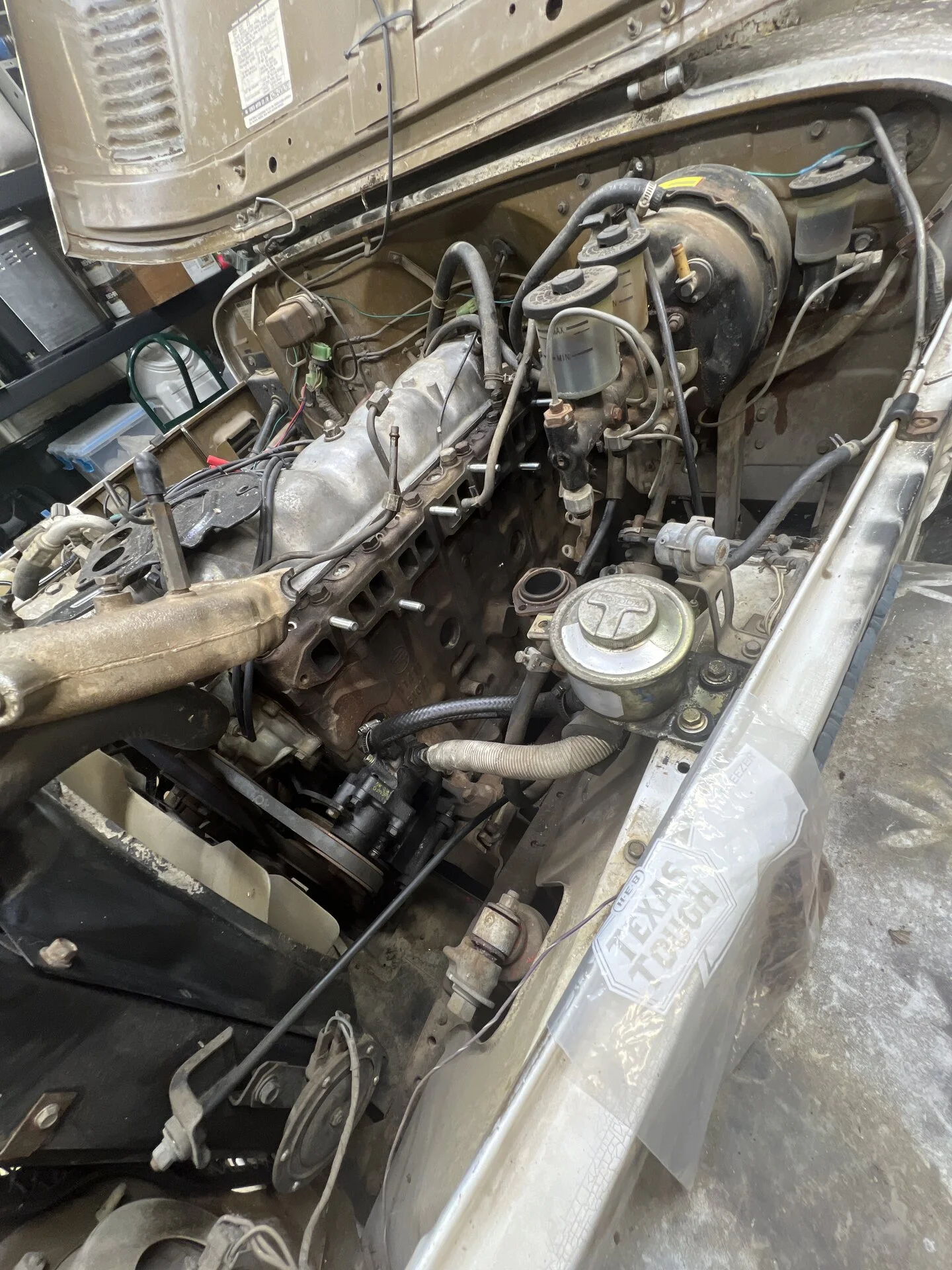

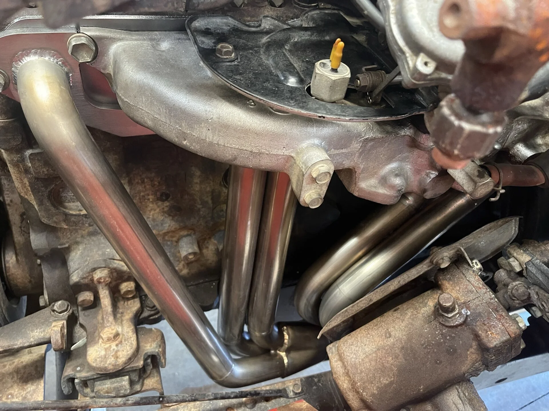

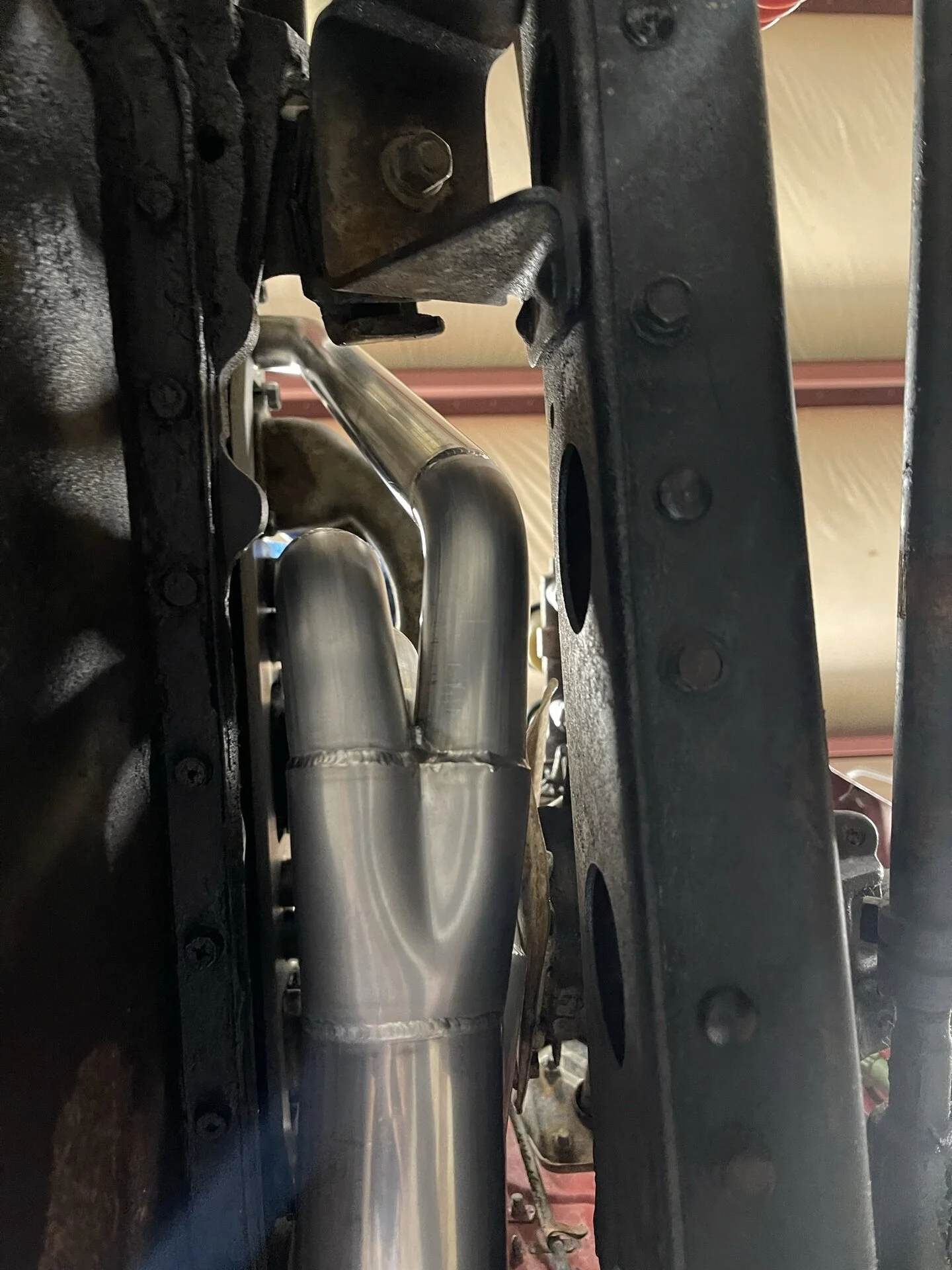

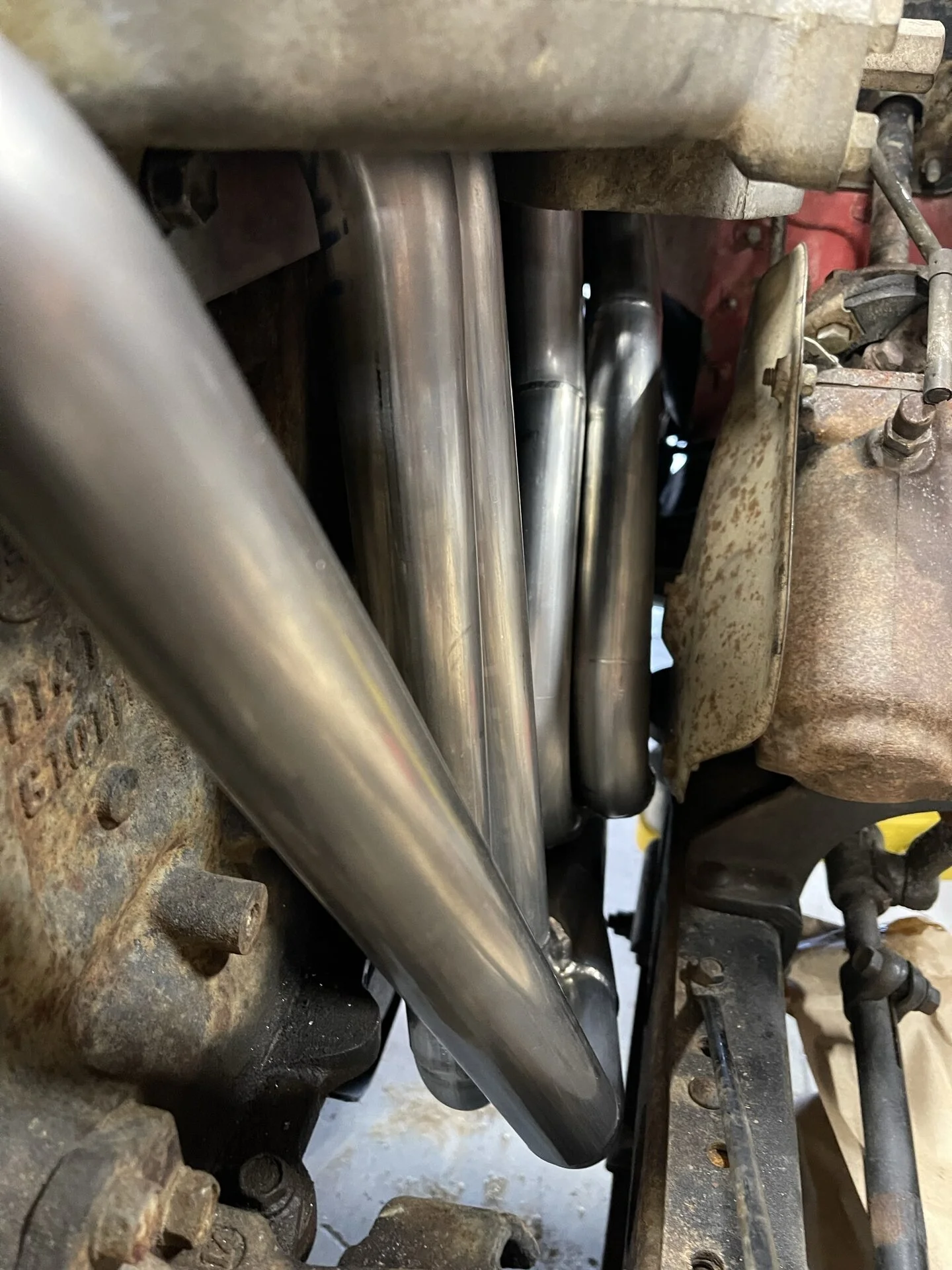

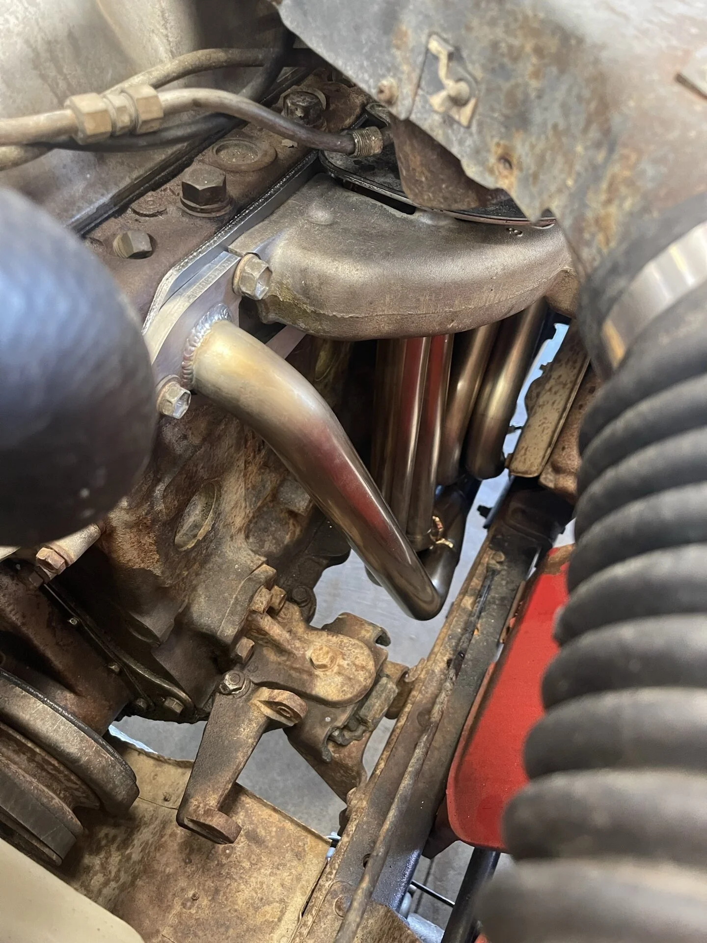

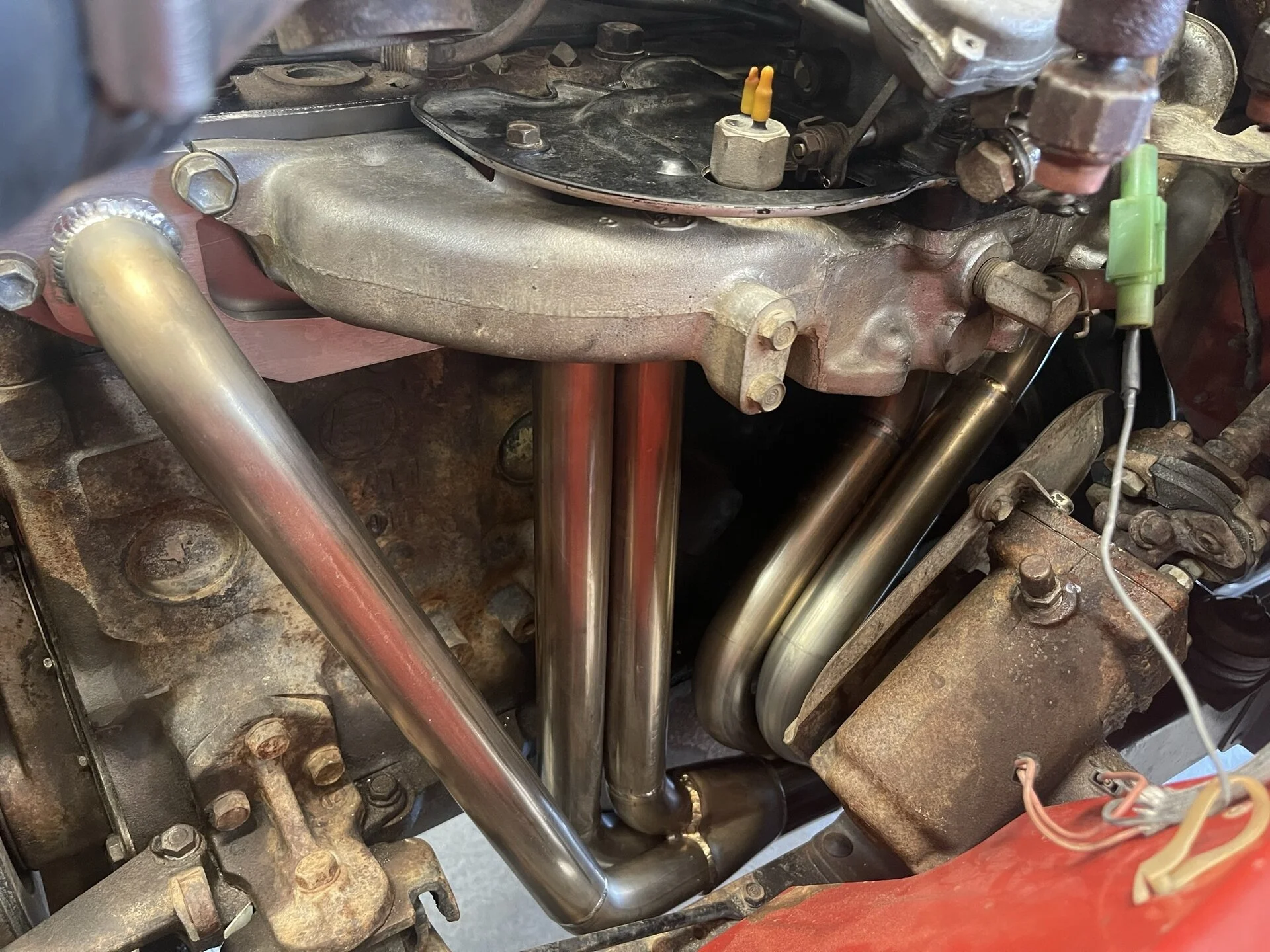

As the saying goes, "All good things are worth waiting for." My 40 was the fortunate recipient of one of the headers "in the wild" as it was used during the design process to assure everything was built correctly and fit perfectly. I was able to see first hand how much effort went into these! My rotted out exhaust ended up being a gift to us all, since Jim decided to build an entire exhaust to go with the header. My '77 doesn't just run better, but it sounds amazing! I have already put it in storage but will record a video of how great the sound is ASAP and post it up. In the meantime, we all love pics here, so here they are! I will post up header pics first and then the exhaust system in the following posts :)
I think the fit can best be described as beautiful!
We did a LOT of work to get the fit to this point.
@Dianna was key in this process when she lent us her 40, and before her @bottombracket .
Thank you both!

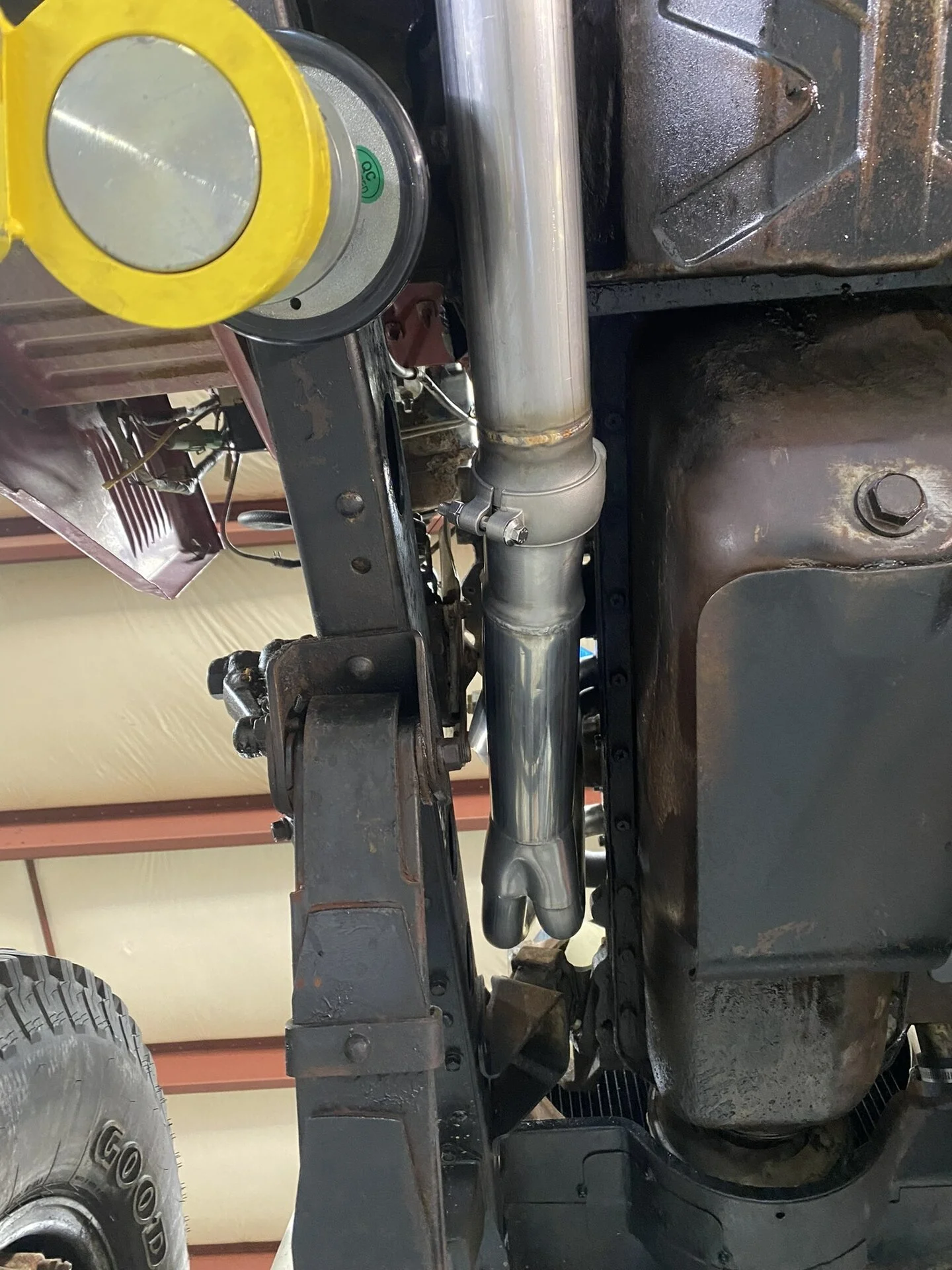

Not seeing a gas tank in the above pics... exhaust kit for '78 and older only, or will there be a post '78 kit as well?
Dianna's 40 is a '77.
I am not as familiar w/ a Square and their differences underneath.
Our first priority will be to get this first batch of headers completed and get everything in place to sell.
If we can locate a Square to try a '78-earlier exhaust on, we will try it out.

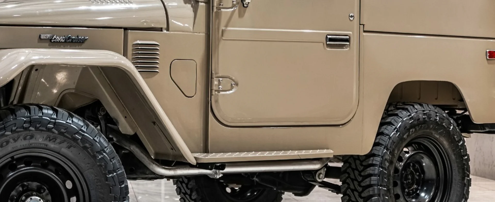

On the later models the exhaust went under the frame rail before the skid plate, along the outside of the frame rail, and then back under the frame rail after the skid plate. It continues over the rear axle and the across the back, where the muffler is located, to exit on the right side.
I was curious about this so just looked at another vendors website who sells a header and found this: Fits 1969 to 12/78 FJ40 without emission controls. Can fit 1979 to 1984 FJ40 and 1980 to 1987 FJ60 vehicles without emission controls, by modifying header pipe to fit your vehicle's exhaust system. Works with column shift linkage and floorshift models. Header will not fit with PTO Winch. If you have a PTO winch, I assume the same would hold true for this header as well. Also interesting to note this might fit 60's as well!

I do not see a cat in that picture, but I am guessing it was the addition of a cat that caused them to route the exhaust outside the frame rails. I am going to further guess that the development work to develop a system that will either accept the original cat, or accommodate a variety of replacement cats is beyond what we want to take on in the near term.
As for PTO winch, there is too much going on there on the exhaust side of the engine bay to run all the header primaries through there unfortunately.

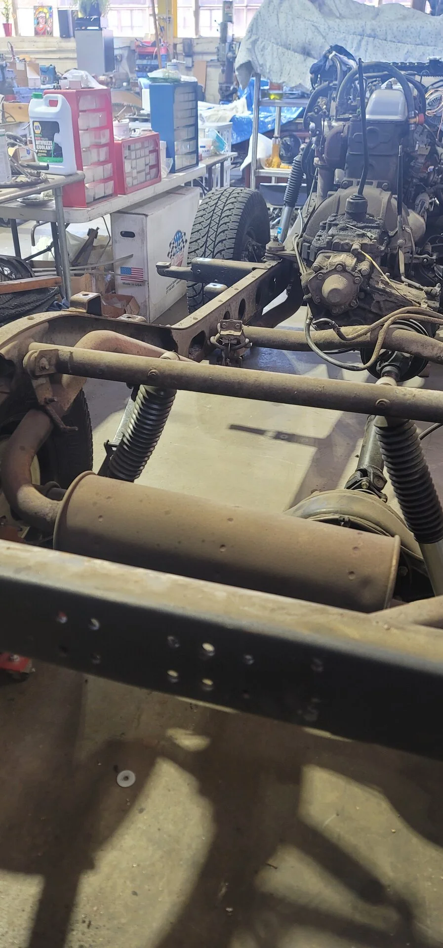

I should mention that my skid plate was cut and BFH-ed prior to this to fit the exhaust above it. You would have to alter your skid plate to install and hopefully you will spend a little more time accomplishing that than my PO did!
Wow, your PO really did some ugly work on the skid plate to run the exhaust.
Our header manufacturer cleaned things up quite nicely!
