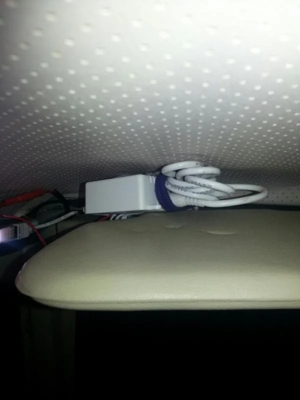

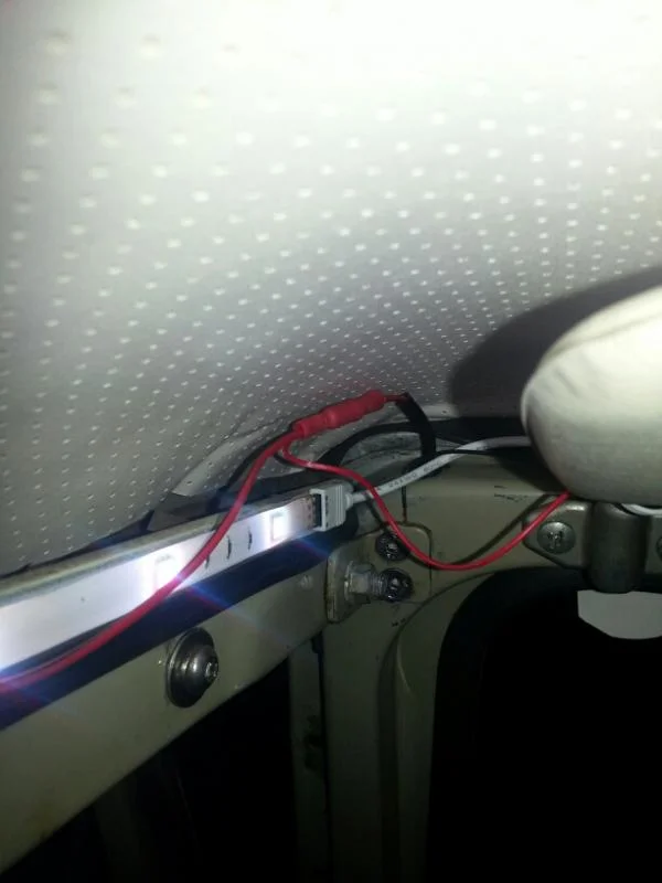

So what about the power conversion to 12V - What are you plugging them into and where are you hiding that big-ass wall wart.
the lights are already 12v. the little box i am guessing you are calling the wall wart, is the brains of the operation (second picture, white box on bottom). i simple cut the 120v plug off, stripped wires back, spliced the red wire into the interior light connection coming out of DS top of windshield, and grounded the black wire to the frame. the little box then can be placed multiple areas depending on what you like. you could tape, velcro, glue it in anyplace. i simple tuck in up on top of my visor. i never use my visor. with alittle time and thinking, and some electrical knowledge the possiblities are endless where you want to put these. i went simple route, i might streamline it this summer. i will get picture soon to explain better.

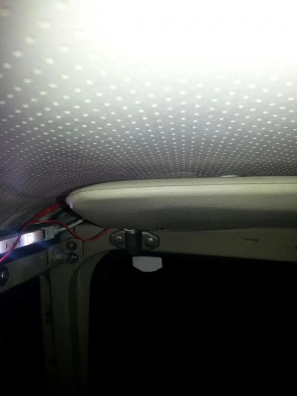

so here is my simple install of the led lights i spoke of earlier. very simple. the lights i got came from costco, and are made by sylvan. the has 4 2' sections that you can piece together up to 8 sections. 8 sections is the perfect amount to go around entire interior of cruiser. it comes with a sticky back tape that adheres directly to the inside rain gutter perfectly.
no to wire in i simply cut of the 120v plug as the led themselves are 12v to start with. i stripped the red and black wires back. i jumpered the red power wire directly into the power wire coming out of the top of windshield on DS that powers interior dome light. i grounded the black wire to the windshield frame screw/bolt. you can see this in the first picture. now the modulator i just tucked up on top of the sun visor and close it. i never use the visor so it is out of the way. you could mount this little box anywhere really. the rest is to stck light strips where you want them and plug them in.
https://forum.ih8mud.com/attachment.php?attachmentid=729207&stc=1&d=1361423615
https://forum.ih8mud.com/attachment.php?attachmentid=729208&stc=1&d=1361423615
https://forum.ih8mud.com/attachment.php?attachmentid=729209&stc=1&d=1361423615

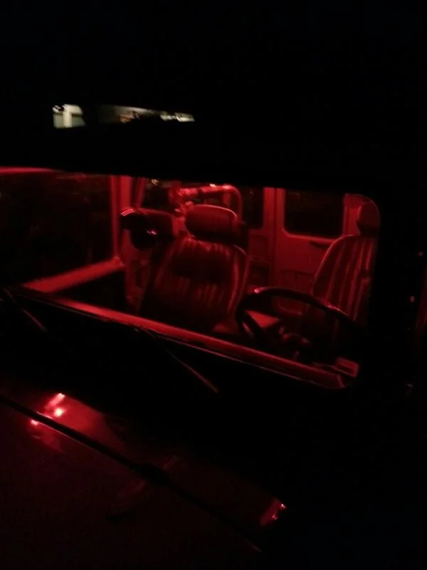

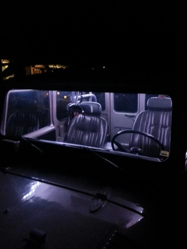

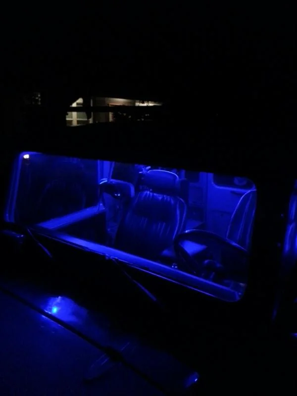

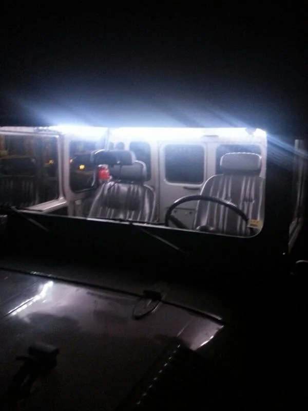

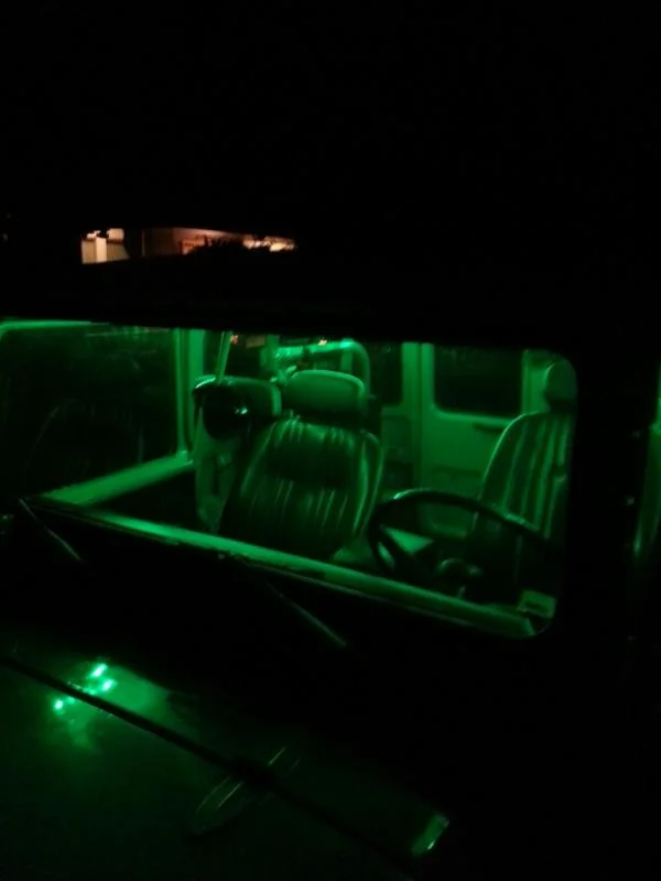

here are pics of the interior with lights on
https://forum.ih8mud.com/attachment.php?attachmentid=729216&stc=1&d=1361424390

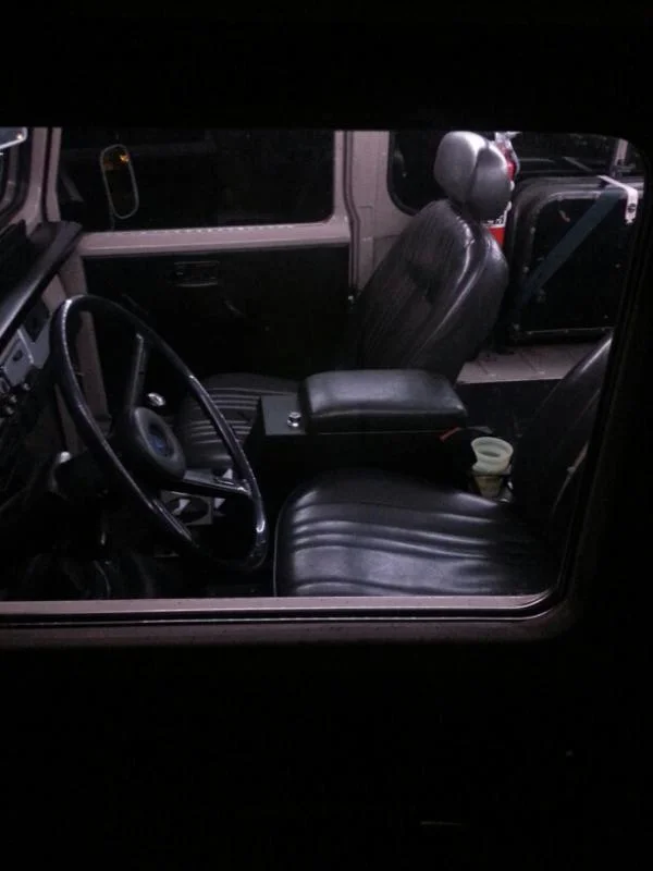

Passenger seat stock location, drivers up and back?
very good eye. yes the passenger seat is stock location. i am 6'10" so some serious modifying needed to be done so i could fit in and drive. here is a link to that mod. everything can be reversed to stock in an hours work.

the led lights actually strobe, flash, blend kinda like a disco ball. my 14 yo son loves it and now calls the 40 "disco bones." according to him, "i am so taking disco bones to prom. no need to even go in to dance."
