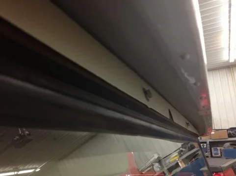

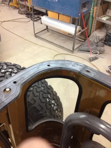

Today I installed my 5th or 6th Headliner, I'm losing track. I took a few photos and looked for a Thread on this topic but didn't really see much. So I will pass on what I have learned and the rest of the Headliner installers can chime in with tips. First I'm going to assume you have the fiberglass cap off (I know there is a thread for this as I wrote part of it) I had my fiberglass cap freshly refurbished but as you can see there is still plenty of old foam to get off.
Part 2
When it comes to TOOLS and getting this old foam residue out, I found this tool below to be the best choice. I've tried Acetone and wire wheels and heat guns and this was the best by far. My body shop friend Michael set me up with this thing and I don't know what they call it but I'm buying one to put on my air tools. PS. Thank god for air tools! I spent about 45 min. to get the cap cleaned up and vacuumed out the debris. A respirator might be a good choice but but I didn't use one.

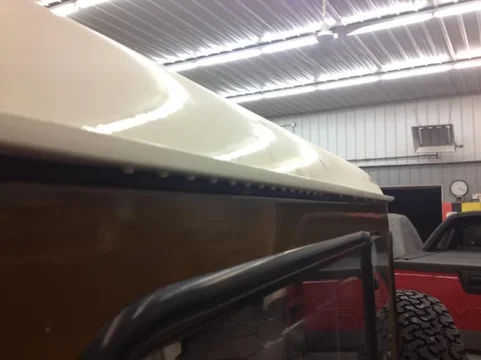

After 10 min or so that should be set. Now it's time to repeat the process in the rear. Again, spray only the flatter surface and leave 6" to 8" on the curves with no adhesive. Once you have good coverage in back, fold the headliner back, working it from the center toward the back of the top.
Part 5

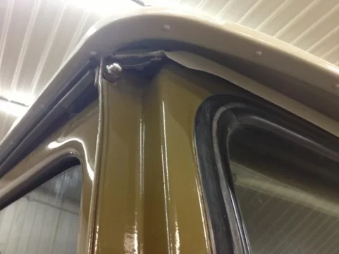

Now you have majority of the headliner down and it's time to start working the edges. I started in the front and sprayed the front lip and folded the headliner over it. Make sure you don't make the mistake of cutting it short here. The headliner goes under the windshield frame. It may take a little time to get the headliner to stick on this portion of the top as it curves up at you and then over to meet the edge that bolts to the windshield frame.
Once the front it stuck you can begin the sides - Pull back the headliner to expose that 6" to 8" strip and spray your adhesive in and work that side. LEAVE THE REAR CORNERS DRY FOR LAST. Keep the scissors handy to cut off what you know you won't need but DON'T CUT TOO MUCH. You can always trim, you can't add it back!
Once both sides are done back to the rear corners you can begin to work the corners and you may experiment a little with cutting a shallow notch here and there for better fit. These would be shallow enough not to be seen. The Headliner is pleated but there always seems to be more material than needed and it wants to bunch up in the corners. Fit it first, once you like how it lays, spray it and work it down. Go slow and trim only what you can afford to. The straight portion of the back will be just like the sides.
It's an art, go slow, think about it and try not to fight it and you should end up with something that looks like this.

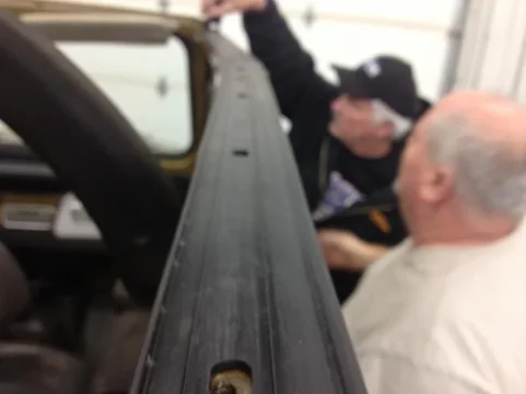

Great job. I need to replace mine and plan to follow your lead. Can one person remove the hardtop without any problems? :confused:
I would not recommend it, unless you have some sort of support from above. I tried mine and had to call the neighbor over as I was starting to bend the drip pan in the middle, if you are careful you might be able to slide off the back after removing all the retaining bolts.
You can certainly unbolt the and get it ready to take off on your own, but when it comes to lifting it off I would have one person on each side of the Cruiser. It's not heavy, it's just big and you don't want to drop it.
