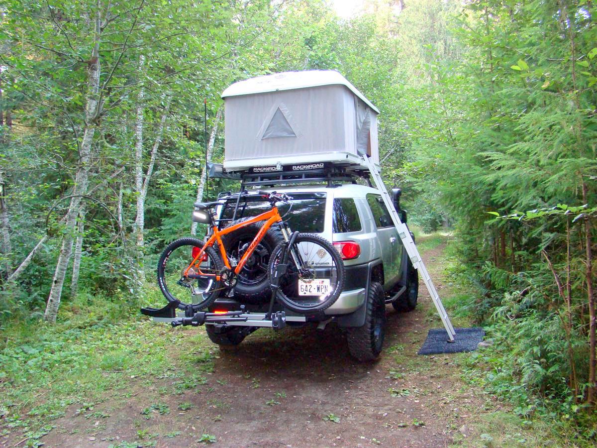

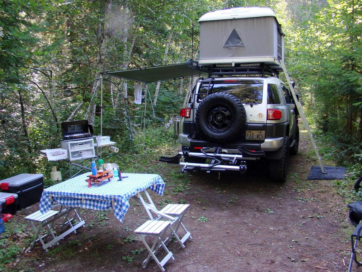

Here are a few pics of how the rig has evolved over the years.
Day I brought it home in the first pic, then the mods came very fast from being excited about this new rig from Toyota.

Corey...love that new bike rack, it completes the look. Will the stock roof rack be any problem with the weight of the tent and the occupants combined? The tent and awning stays on year round? Aren't you worried someone will take it?

Thanks Pat.
I wanted a good bike rack that could take abuse off road, and the salesguy where I bought my mountain bike goes off road on FS roads quite a bit, and he said this was the one to go with.
Stock roof rack can hold 160 lb when moving down the road.
When parked, it can handle 500 to 600 lb.
I do not recommend the stock rack for a roof top tent though, even though that is the way I run mine.
The tent is to far up in the air, and when it is windy out, I can get pushed around a lot on the freeway and have to limit the top speed to around 60.
BajaRack is working on one that makes the tent sit much lower, and that is probably the rack I will go with later on.
