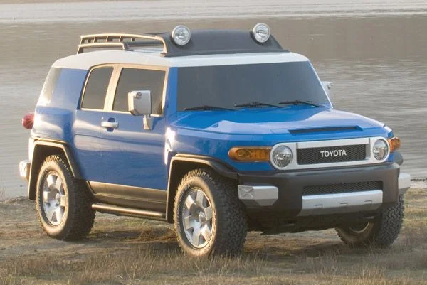

*EDIT AGAIN* Here is a photo I dug up online. It will look like this.
