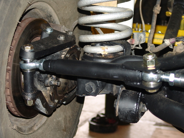

Kyon,
The 4x4 Labs setup takes the tierod from the front of the axle where it can be hit and moves it to the rear. Since 40s and 60 have the steering arms on top of the knuckles, that is where they go when they are moved to the rear. An 80 already has the tierod behind the axle, but the steering arms are on the bottom of the knuckles to let the tie rod clear the anti-sway bar, locker mechanisms, etc. It is pretty well protected back there, even though it is mounted to the bottom of the knuckles. The relay rod from the steering box is another story. It is still out in front of the axle where it can be hit. 4x4Labs, Marlin Crawler, and Slee Offroad all sell beefier relay rods and tie rods to overcome this problem.
