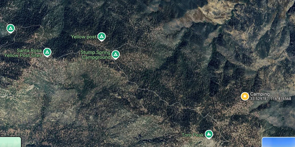

For context, that little star, I believe, is the spot I am thinking of. It's sort of close to Stump Spring Campground.

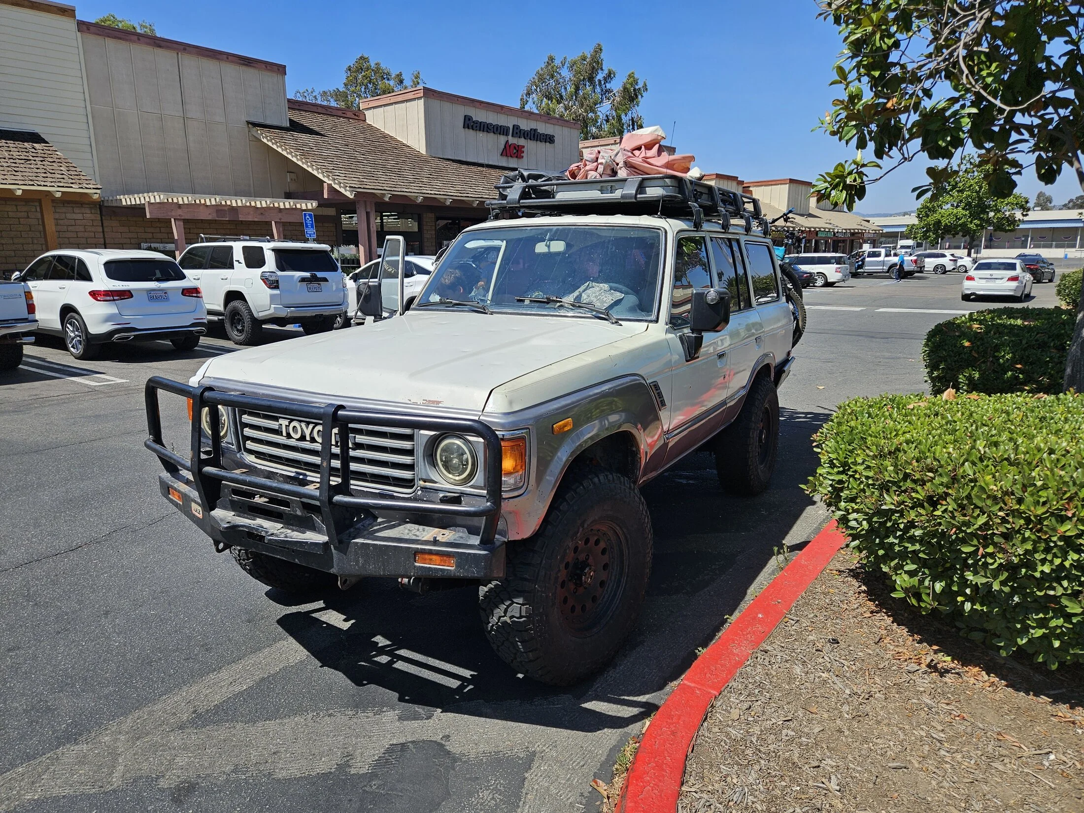

So, I am still planning to get up there Saturday or Sunday to map out a good spot but got tripped up a bit. This weekend I took my oldest to Mt. Laguna to go mountain biking with his friend and family. Wampa, the 60 has come a long way and was ready for its first camping trip. All was going so well. The truck was running great, AC nice and cold, and after 5 years of working on it we were feeling the stoke. I pulled into Albertson's in Ramona for some supplies. When I backed out of the spot I heard a weird noise from the rear of the truck, the brakes went softish, and the truck would not go. As soon as I checked my side view mirror I saw the d-side rear wheel leaving the chat.

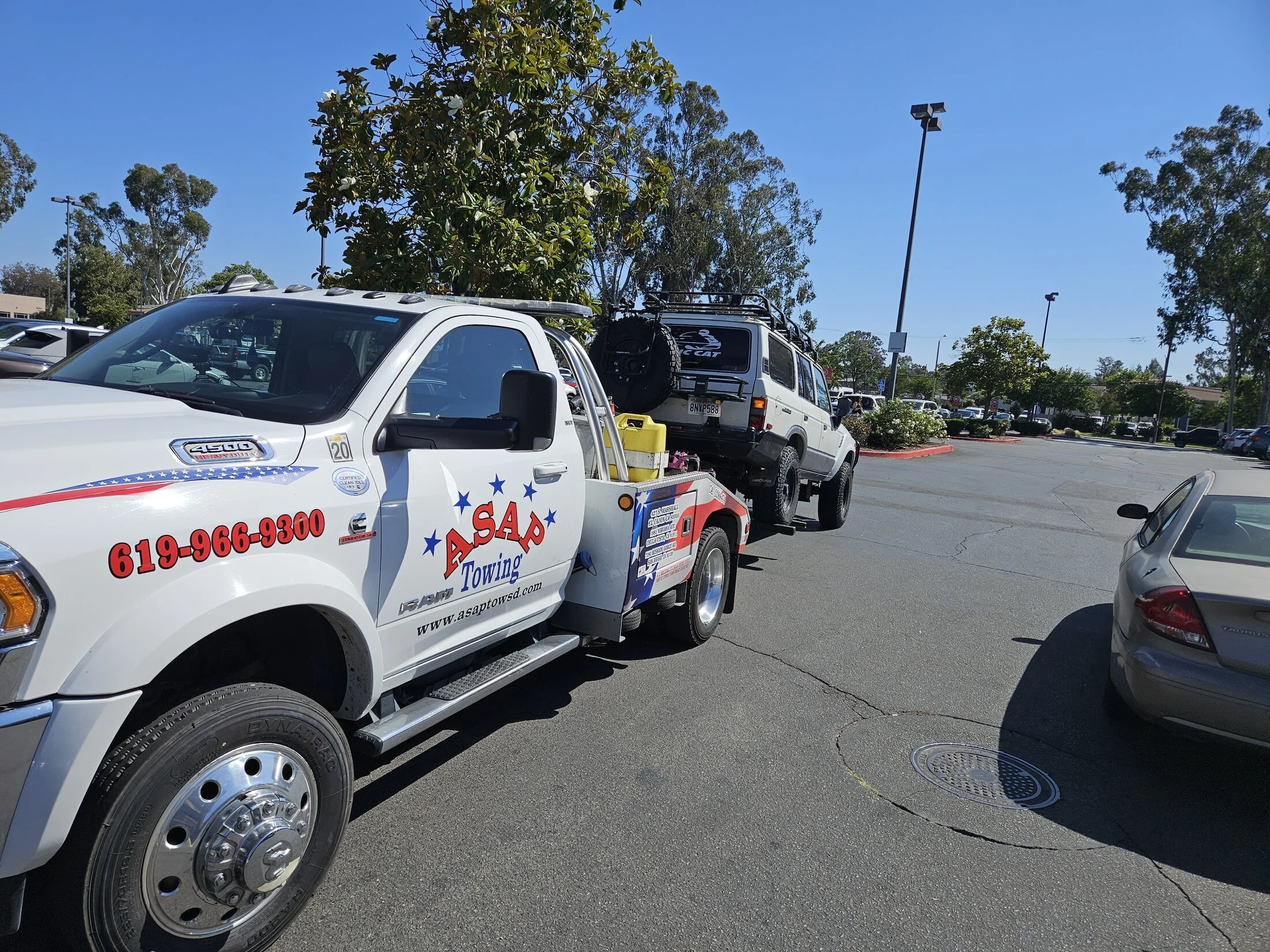

Some good Samaritans helped push to the curb., I called a tow truck, jacked it up, and shove the wheel back in.
My wife showed up with the "backup" Land Cruiser which is Rathtar the 80 that runs quite well. We loaded all the gear up into it. She and my son headed home while I waited for the tow truck. Once home we jumped in Rathtar and headed to Mt. Laguna for a most excellent weekend.

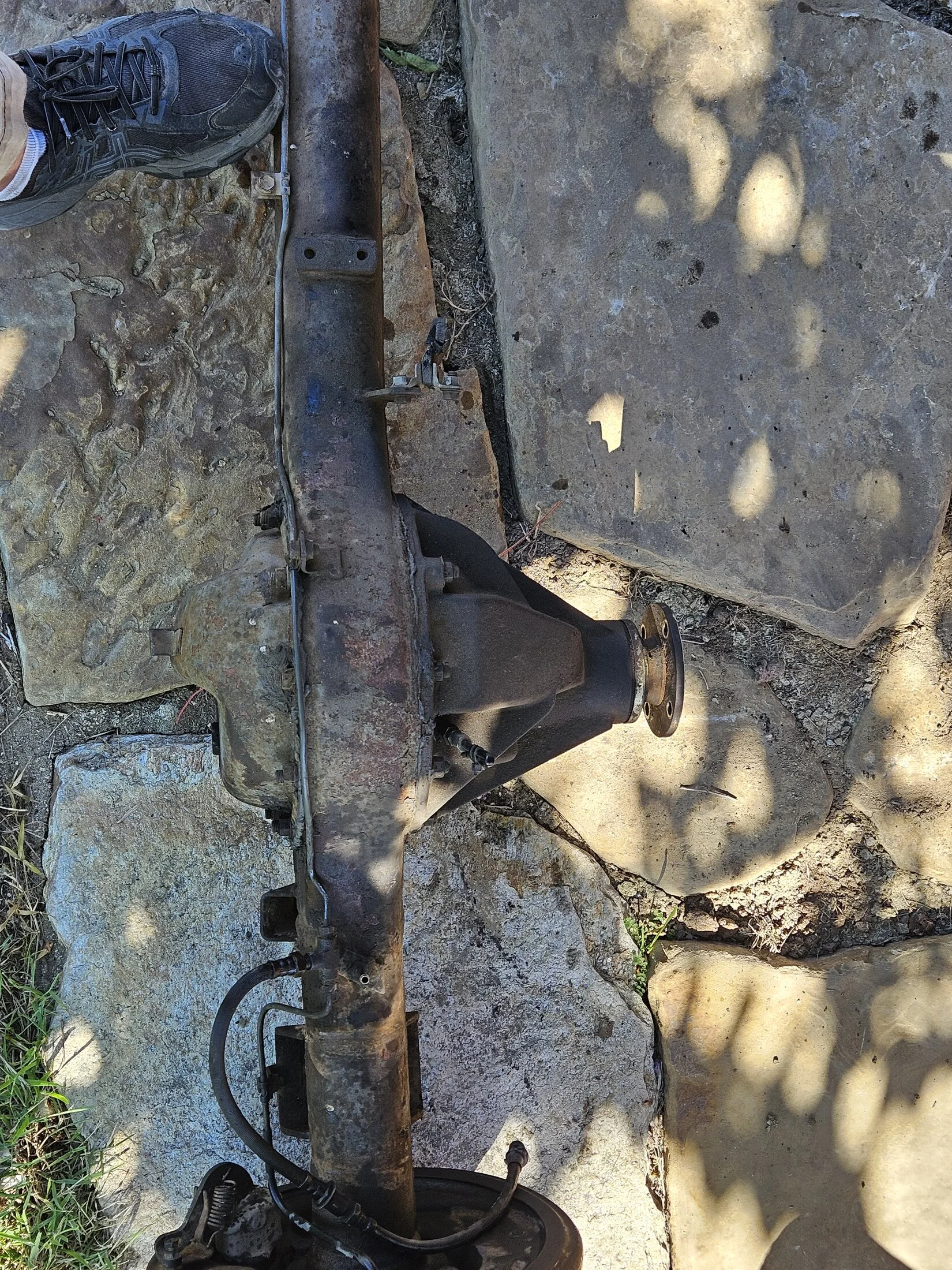

Here is the kicker, this is the SECOND time this truck has ejected that axle. The last time was when it was "Mudhorn" (will explain over beers...) at TheTim's house.... which btw is a much, much better place to breakdown. I got to thinking about what the odds could be and recalled that this axle came from a truck that had been hit in the p-side quarter panel. I suspected that bent the axle. I hypothesized that I was running toed in going forwards but toed out in reverse. I tested this when we got home by driving forwards and sure enough the axle stayed in place. As soon as I backed up it started to walk out. I was able to driving into the back yard. We tore it down and sure enough the axle is bent. Not sure how I missed it but it didn't miss me!
If you look closely you can see the arc.
I have another axle so will mix/match and reinstall. I ordered the bearings, seals, and ubolts to complete the rebuild. I am still targeting heading up there Saturday or Sunday, just depends one parts arrival and how things go. I will update in case anyone wants to join for a quick prerun up there.
