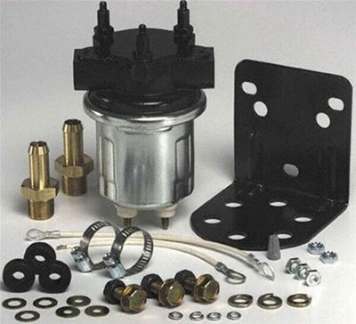

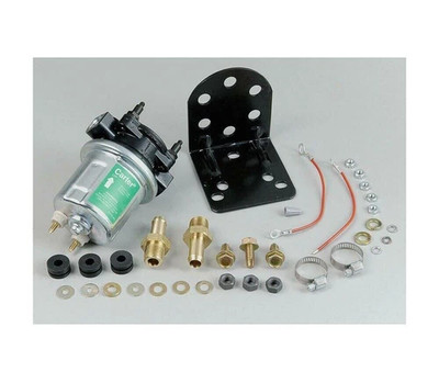

On pump, something along these lines
No worries - have a read of this for some advice about mounting etc, Lift Pumps and Mechanical Diesel Engines - HD Automotive - https://hdautomotive.com.au/blog/2024/02/09/lift-pumps-and-mechanical-diesel-engines/?srsltid=AfmBOoqsu7GIHNNgukdGxA9D9KoB897jEQs3P8UV2T4axllaxpJWgMLc

was looking for one on super cheap does 3-4 psi max
