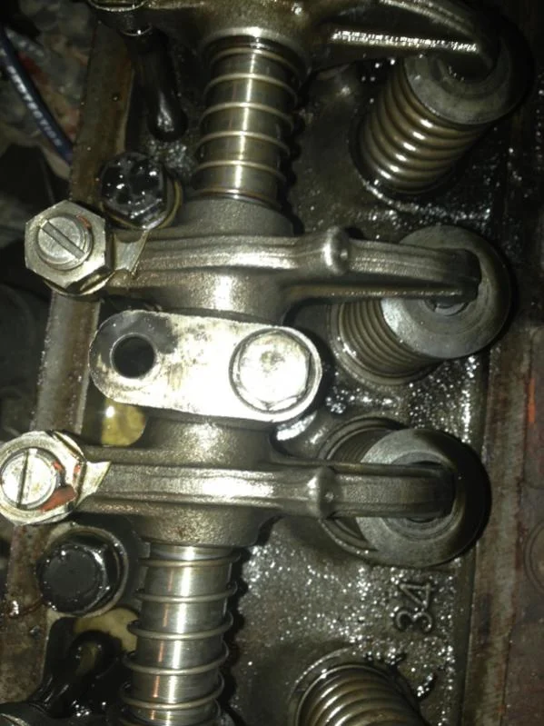

There are 4 nuts and 8 bolts that hold the rocker down, the two 14mm bolts are giving me trouble. They broke free and now just spin(not freely) but won't back out.

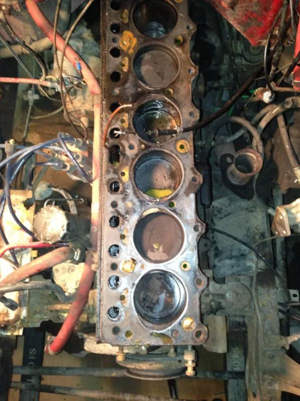

Got them out, only took and hour of prying and cursing. Looks like the threads were crossed. This is what the block and head look like;
I have another project I'm working on and really want to spend as little time on this as possible but I need it running. Also I really want to keep the F but also don't want to completely rebuild it at this time. Any suggestions/thoughts?

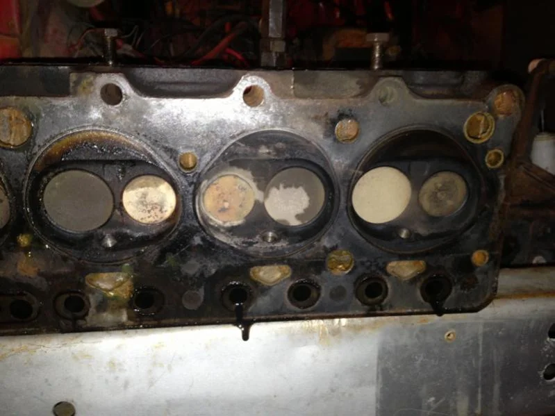

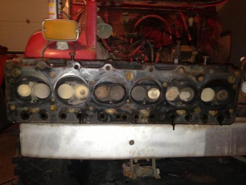

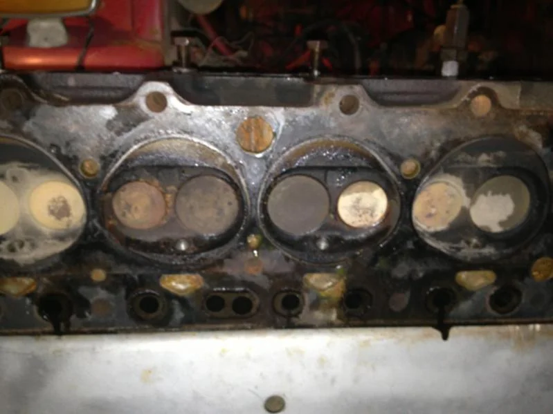

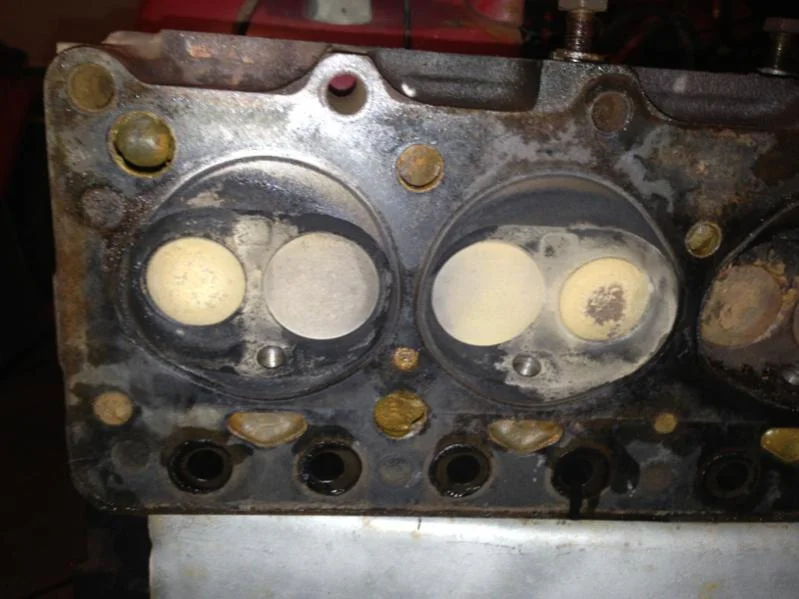

Took my head to Lucito's and it is "scrap". Trying to figure out what my next step is.
