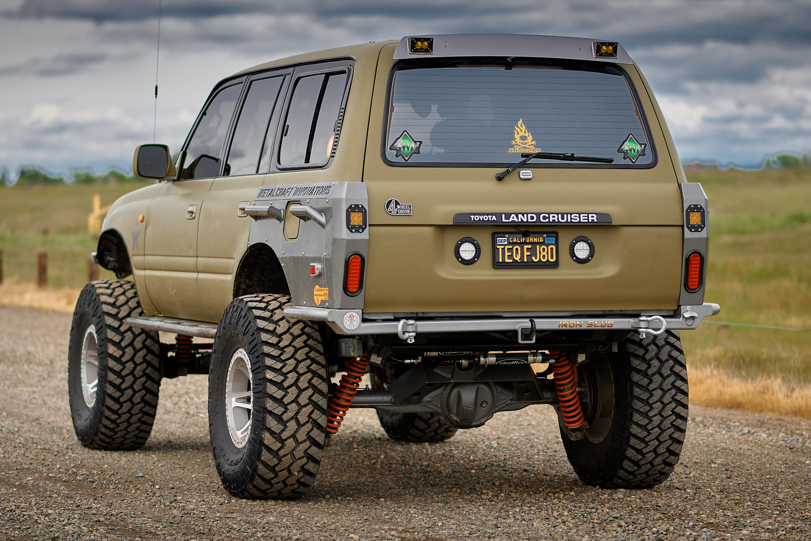

SNOWBOUND CUSTOMS CHASE LIGHT SPOILER
Also installed a new spoiler with integrated chase lights. Very cool new product. The guy was originally making these for 3rd gen 4Rrunners and recently started making them for 80s. Aluminum, come in powder coated black or bare aluminum. I went bare and spray painted it to match the rest of my truck. Spoiler is made for flush mount Baja S2 lights although he recently made an adapter to run some of the cheaper Amazon versions which is cool.
