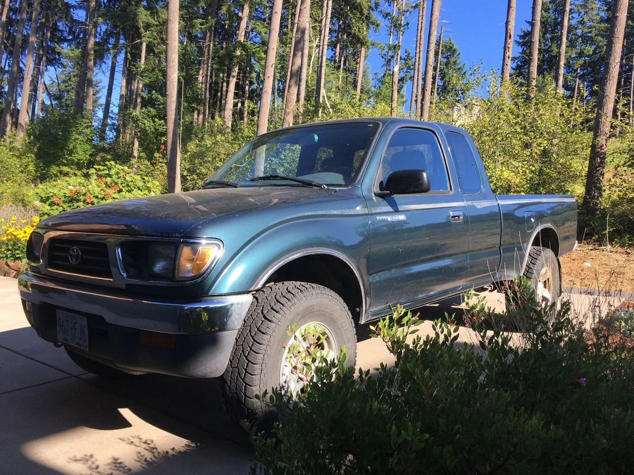

Hi, y'all. I used to hang out a lot in the FJ25 & FJ40 areas, but sold my '64 FJ40 project last year. Recently decided I needed to have a pickup again (after 20+ years without) and so last week I picked up a well-used but well-maintained '96 Tacoma LX 4x4 extended cab. 5ZV-FE and 5 speed, 271,000 miles.
Really in decent shape for its age and mileage. Doesn't need much to be the stock driver truck I'm after.

Here's a pic of the coiled hose in place, followed by a pic of the truck itself (since everyone loves to see the new guy's truck).
