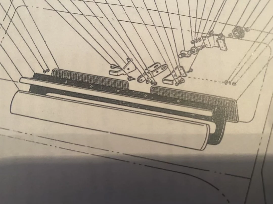

I replaced one on a early welded vent before without undoing the welds. Had to clean out the old rubber from the vent door, then cut the middle out of rubber flap, then stuffed it into the cleaned out metal vent/door.
If i took more time with it, it would come out pretty good ( looks a little sloppy), it was a last minuet idea that works and could be improved upon.
Im wondering if this is how it was supposed to be replace before the vent with the removable back plate was introduced .Looking at the FJ25 parts book, replacement rubber looks to have the middle hollowed out to replace it the way I did.
