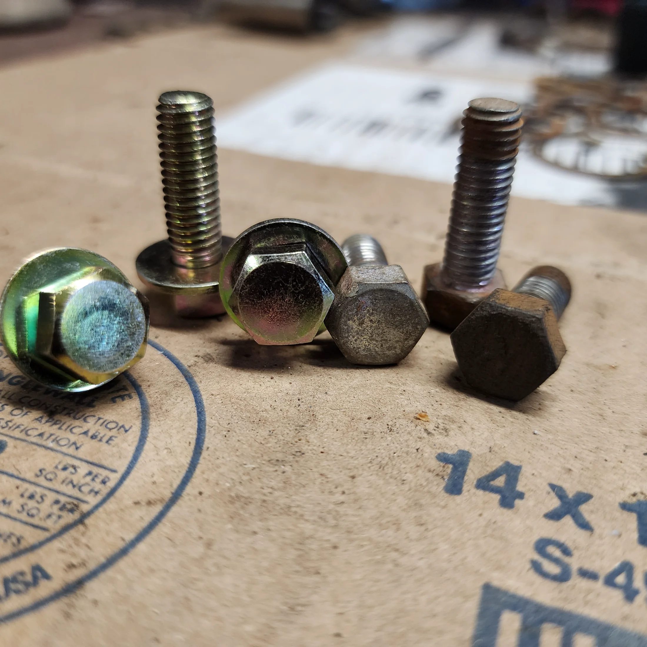

Bump. Has anyone found a catalog, list, spreadsheet, or pdf of the different JIS bolt manufacturers that supplied Toyota over the years? I am considering starting a thread on hardware variants across the years, but have no interest to reinvent the wheel if that information is already out there.
I have a basic sense of the ordering, but not necessarily exact production date changes. So I would ideally start a thread like I did with the choke cables, and have everyone chime in with which varient their rig came with.
I went down a rabbit hole a few years ago when I bought someone's leftover nut and bolt collection from restoring several rigs and started to notice the difference in stampings. I didn't dig up much.
There was this thread but it's all over the place and lacks pics. Nuts and Bolts - https://forum.ih8mud.com/threads/nuts-and-bolts.76927/
