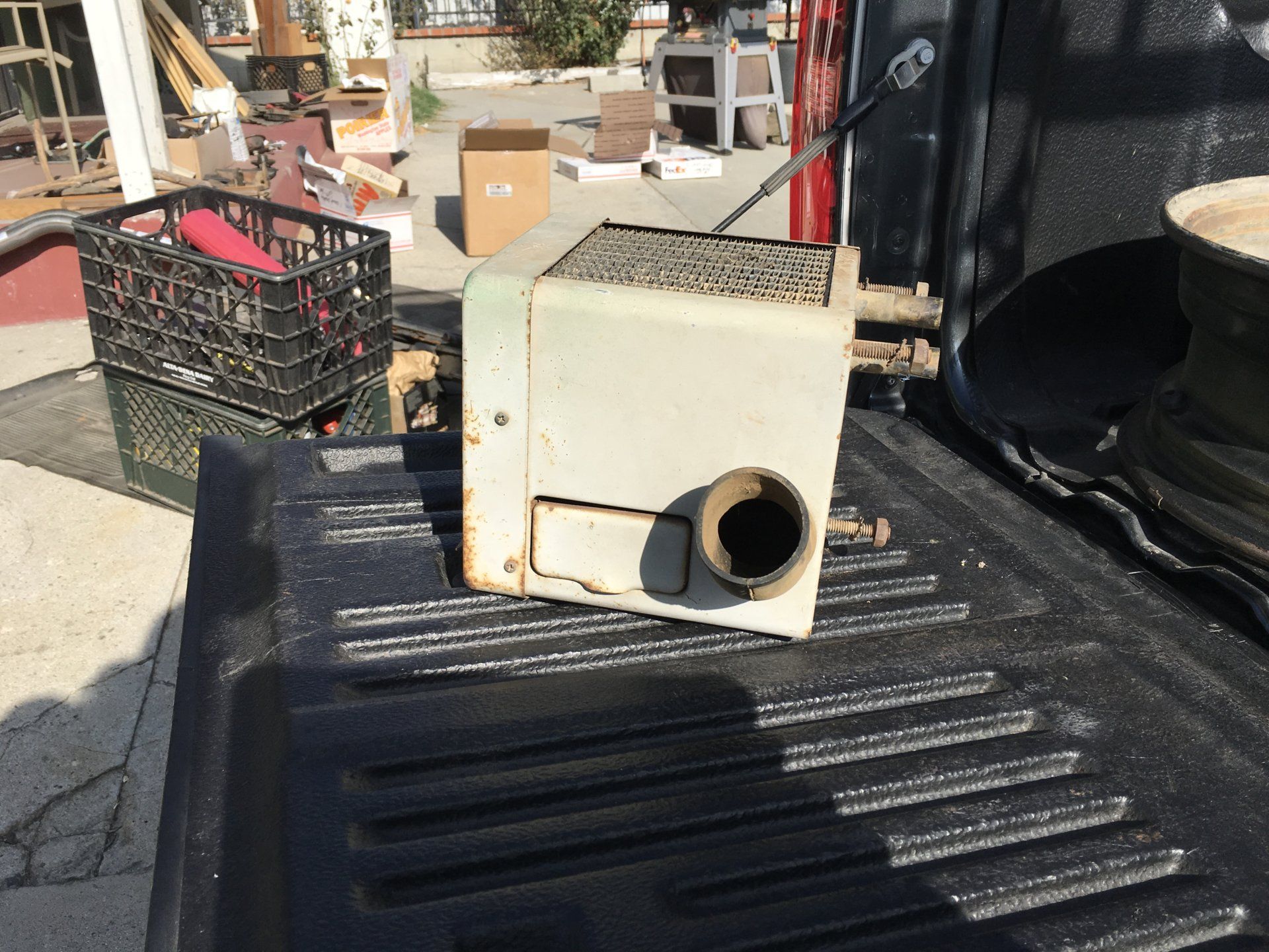

Interesting the different inlet and outlet pipe orientations for the hupps. I specifically was looking for a heater with vertical oriented pipes as that was the orientation of the existing holes. I came across this Hupp at sigfrid’s eBay listing and was sold on its vertical pipe orientation (like Destin’s vs horizontal or at angle like some others I’ve seen). Since the dealer drilled the holes I’m curious as to why there are different pipe orientations unless it has something to do with vehicle specifics (and what?). I think the front plate mod to this is removable, will have to redo the front flip up panel. Not sure of status of sticker or markings. And need to put power to the fan to verify operation.
The pipes in my Hupp are vertically oriented as well, and exit on the far right side of the housing. I’ve seen other vertical pipes exiting the left side. No idea what the differences are.

Starting to refresh my Hupp today. Looks like I need one of the small side vent flaps, and one of the 2 spring clips that hold the flap to the body. Also need to find some sort of cap to plug the 2 defroster outlets, as my '64 FST doesn't have defrosters at all.
Any ideas?

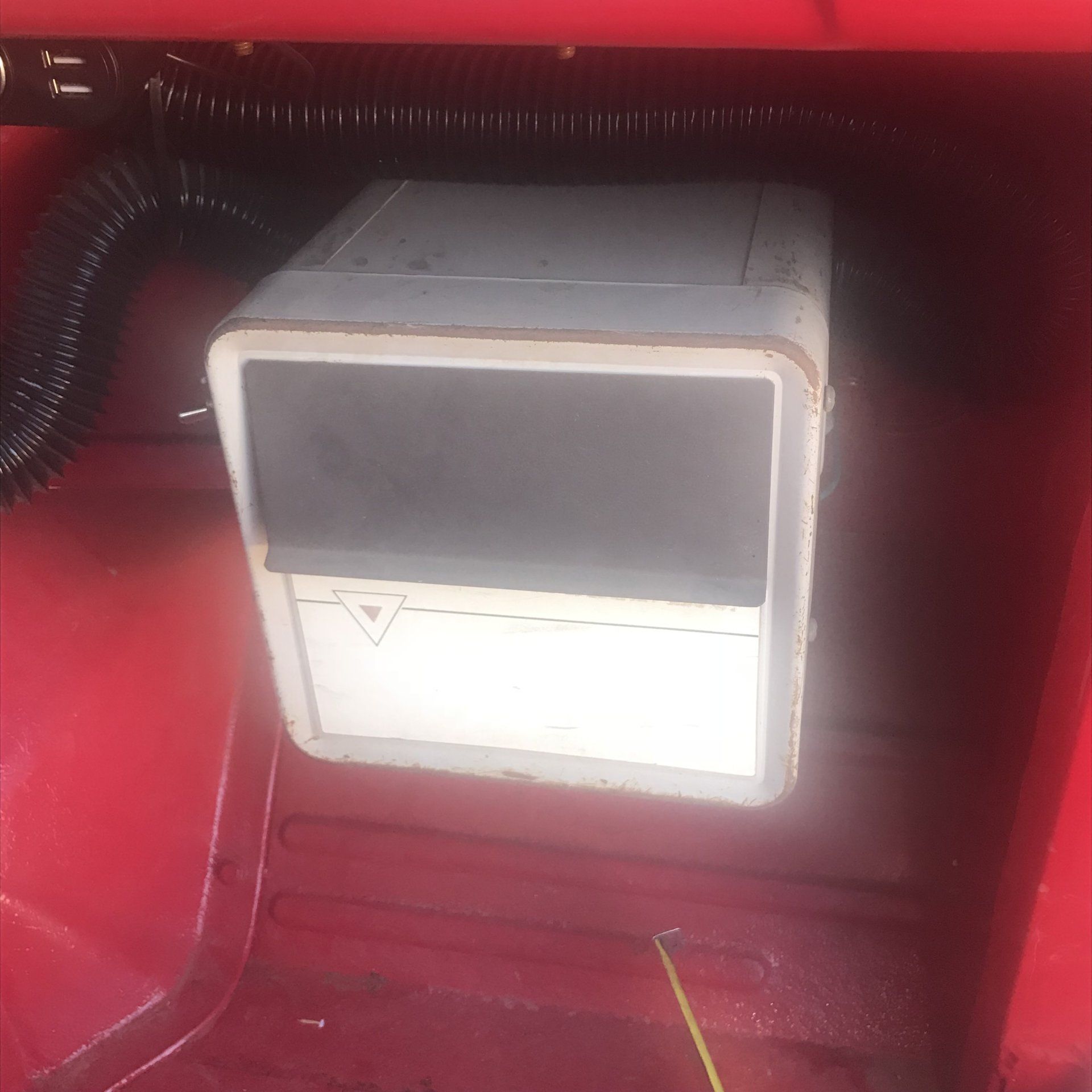

Getting close. Although I'm still missing one side flap. (WTB ad) Case color is a near dead match for what I found when I stripped PO-applied paint from the case and side flap. Looks a bit creamy colored in this picture, real life is much less so. Testor's Model Master, FS 36622 Camouflage Gray. The gray is a matte paint, so I clear coated it.
I've seen pictures of other color schemes (silver case, cream front flap, etc.), but I matched the remains of the original paint on mine for all parts.
