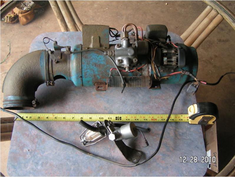

I know this doesn't classify as a box heater but still it Toyota and a heater. Saw this puppy on e-bay. 1965 gas fed heater. From the description it says it's Toyota out of a sports. How cool would that be in a 25/40

Just don't forget to leave it on...it may drain your tank ;)
