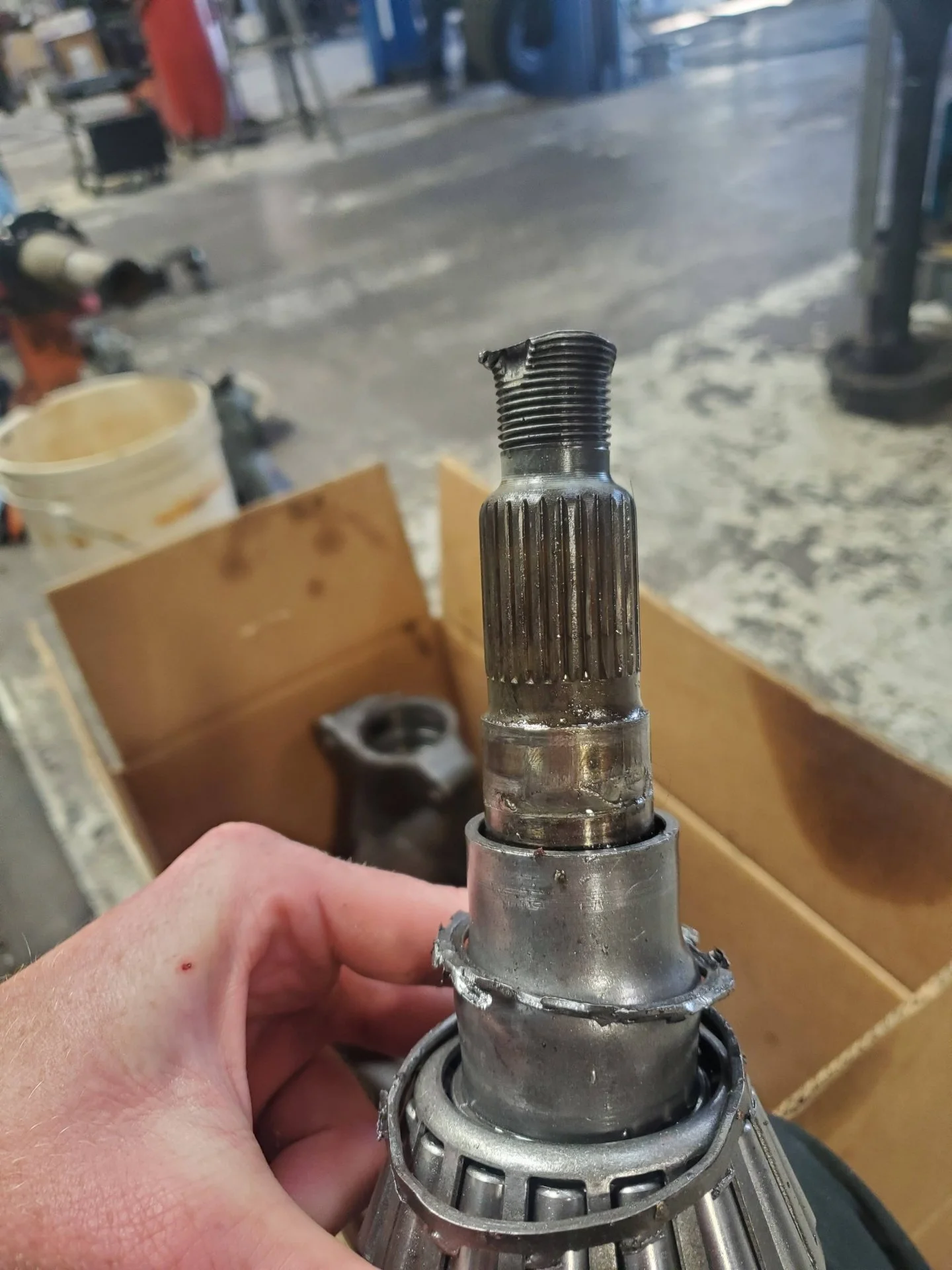

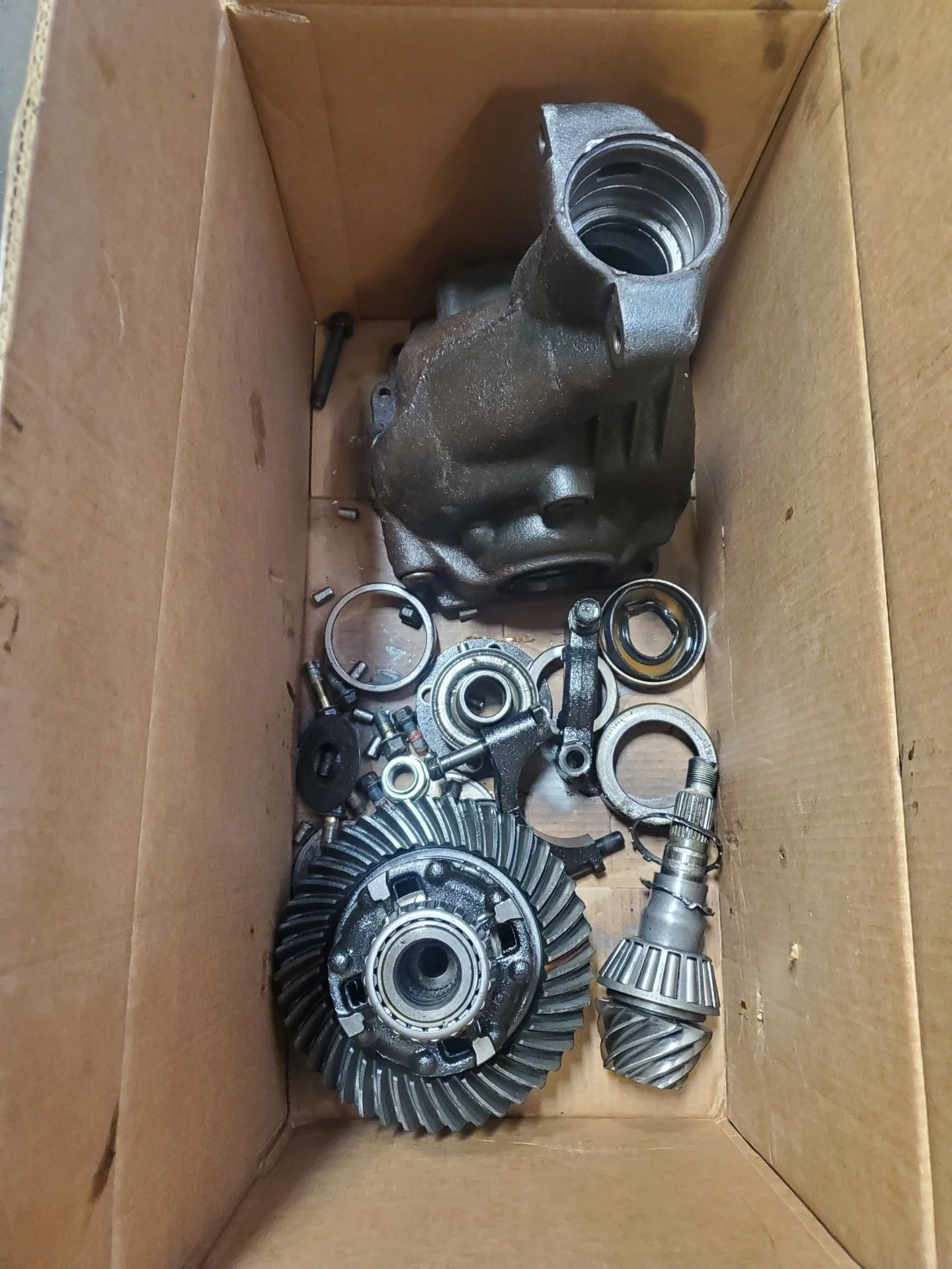

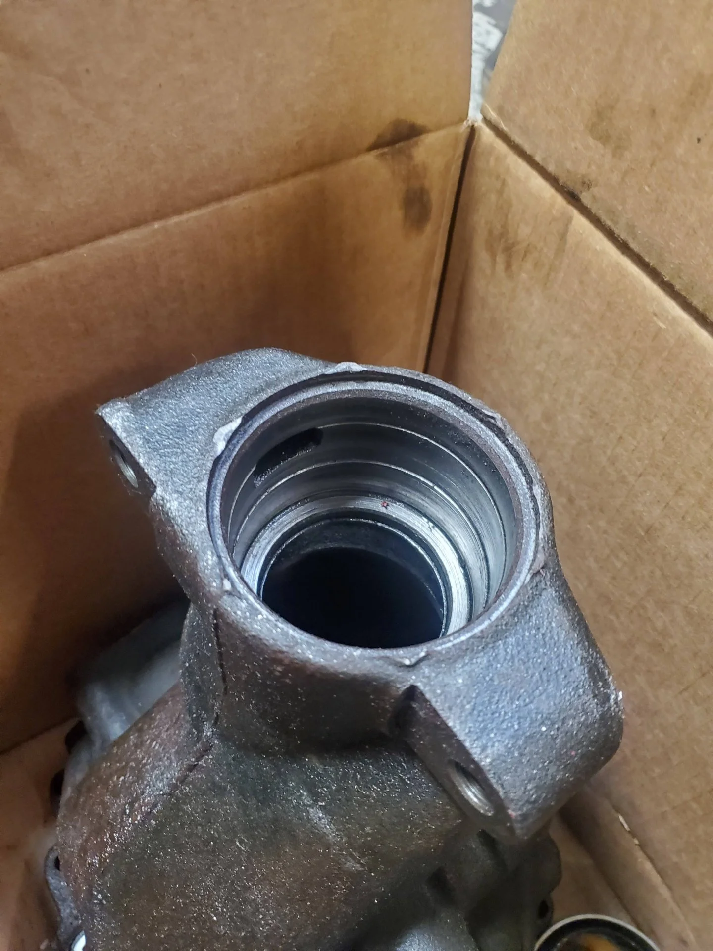

I completely forgot to reply to this thread. So I figure I'll give a little conclusion as to what happened to the best of my ability. I'm not a full gearhead and I got it fixed up by a shop in CO a few months ago.
And I'm sure a lot of people reading this in the future will either be looking how to diagnose and fix theirs, or to see if they can continue to drive with a broken front diff. So to answer those questions:
>I can definitely say I made it out okay with driving on a broken front diff. In fact I calculated I drove at least 800 miles on it, the grinding became less but was certainly still there, still mostly while going down hills and deaccelerating. I'm thinking that maybe had to do with the angle of the car or something. Might have made it worse but, she went.
>I cannot say exactly what was broken in the diff and why it happened. However I suspect that when my CV axle popped out at a joint, and I continued to drive another 30 minutes on it to get out of a blizzard on my way to SLC, the pinion/something else in the diff got screwed up. What I do know is the pinion was loose. And either that or something else was spinning, grinding on the walls of the inside of the housing. I took some pics of it all which I've attached.
(no vital info past this point)

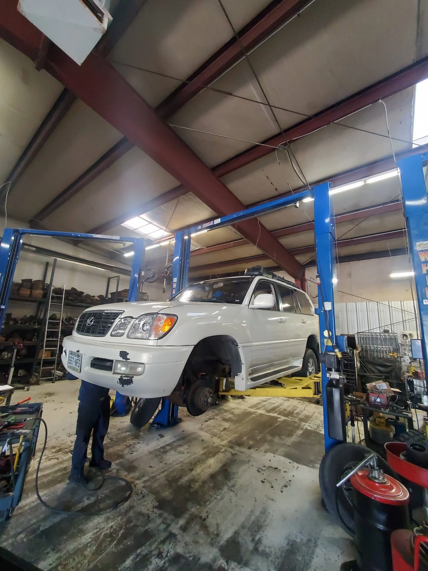

To summarize this s***show of a story , I did about 3 weeks of car camping while it was getting fixed. It took me a few days to find a reliable shop at the end of February in the Denver area, and when I did they diagnosed it as the front diff. So I had them take off the broken front diff and put the axle back in, as far as I understand how it works, so I was able to drive it. They then ordered a "brand new" diff and I spent about a week skiing having a BLAST using RWD up in the snowy mountains waiting for the part to come in. Came back to the shop a week later when the part came in only to find out the box got damaged, or someone had sticky fingers. No new diff. So they reordered and I flew to Cali to see a friend for a week. I flew back only to find out that there was a botched shipping job and nobody actually shipped the reorder. So bam, at least 2 weeks in. I continued to ski for another week or more as the new diff finally shipped over, which was rebuilt on a weekend in Denver and put on the 'ol LX in 1.5 hours on a Monday. At this point it was almost April.
So I was good to go at that point. A solid 2.2k spent getting it fixed ($1176 for the diff, ~$500 for the rebuild, ~$300 for an overhaul kit, and the rest for oil, seals, tax) But it hasn't failed me yet. That very day I got it fixed I started a long haul to the east coast and I drove maybe 1800 miles on it in 2.5 days while towing a trailer with a body of an FJ40. No problems at all.
As for the shop I went to, they are Western Drivetrain in Aurora, CO. Really nice guys and can't recommend them enough. The price ended up being a little more than I was quoted but hey that's just how it goes.
Also I kept the broken front diff if anyone wants to buy the parts off me 😂
