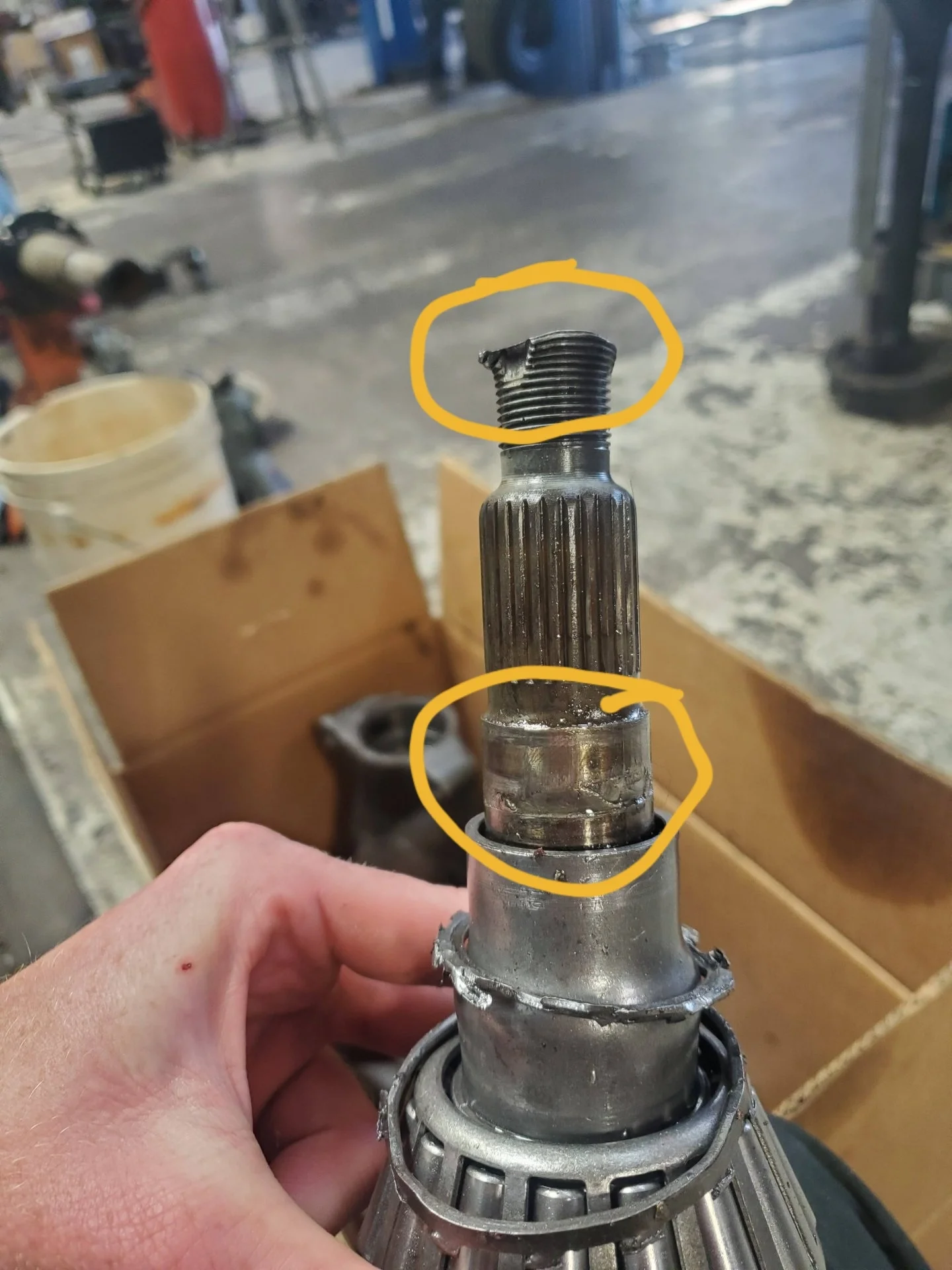

So the pinion bearing became loose or something? Thats weird I always thought when these failed they busted teeth on the ring gear?
Could you provide a few more pics of the inner race and roller bearings of the outer pinion bearing? It looks like the issue was there with the scoring on the pinion and condition of the threads where it looked like it was needed to be airhammered from the housing.
You didn't happen to keep some of the gear oil after failure?
