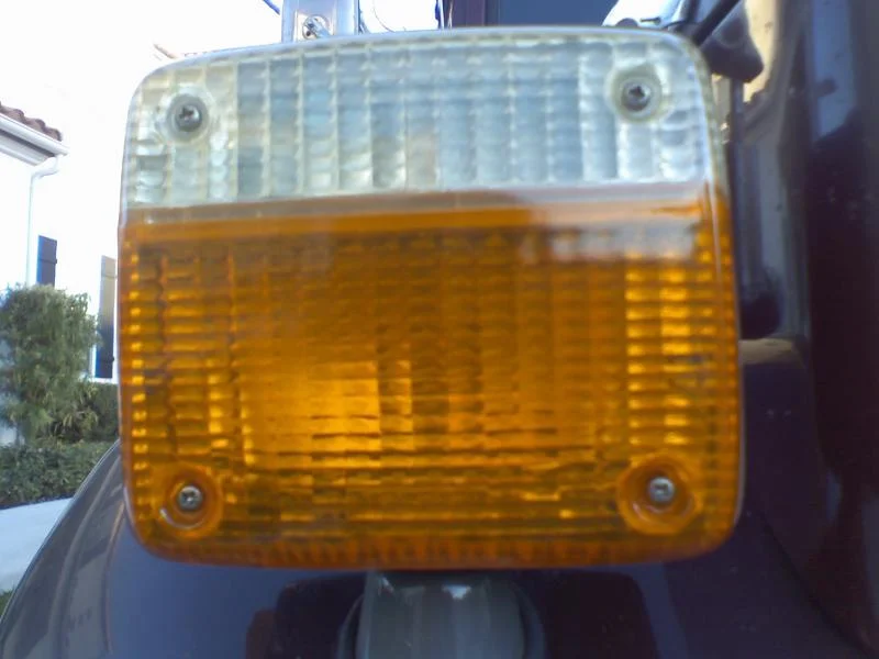

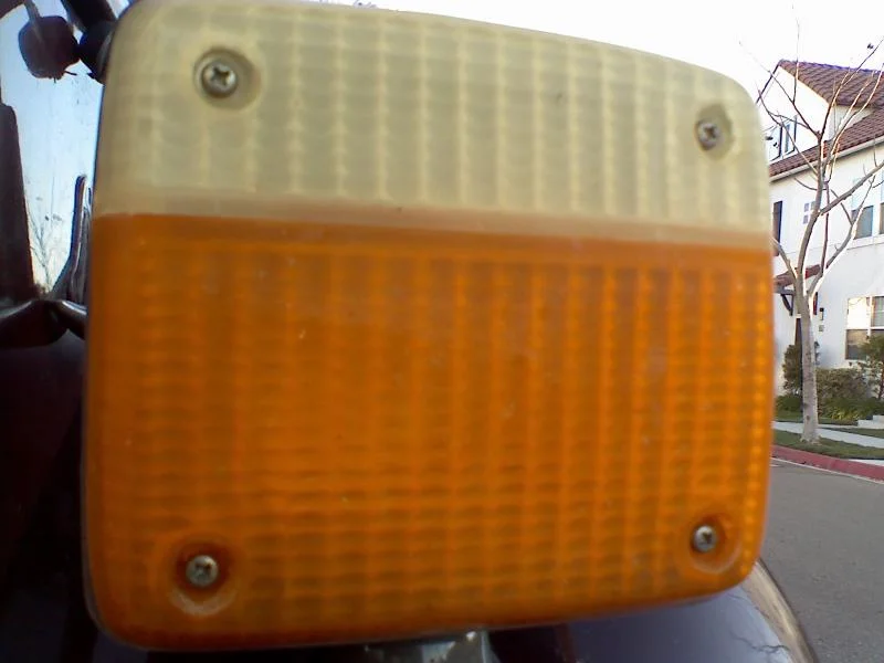

Hello All, I wanted to show off how I fixed my turn/drive lights on my 72 FJ40. Over the years the light covers have began to fade and get a fog over them. I imagine this is normal wear and tear. Anyhow, I got the idea from a friend to wet sand them and cover them in Clear Coat. MAN, the turnout was way better than I expected!!! I could not be more pleased.
2000 grit wet sand with soapy water, a little clear coat paint... and Voilà' Looks like new!

WOW That's a huge difference. Thanks for the post.
Very cool, thanks for sharing!
Although it does add another friggin' thing to my to-do list :eek:
