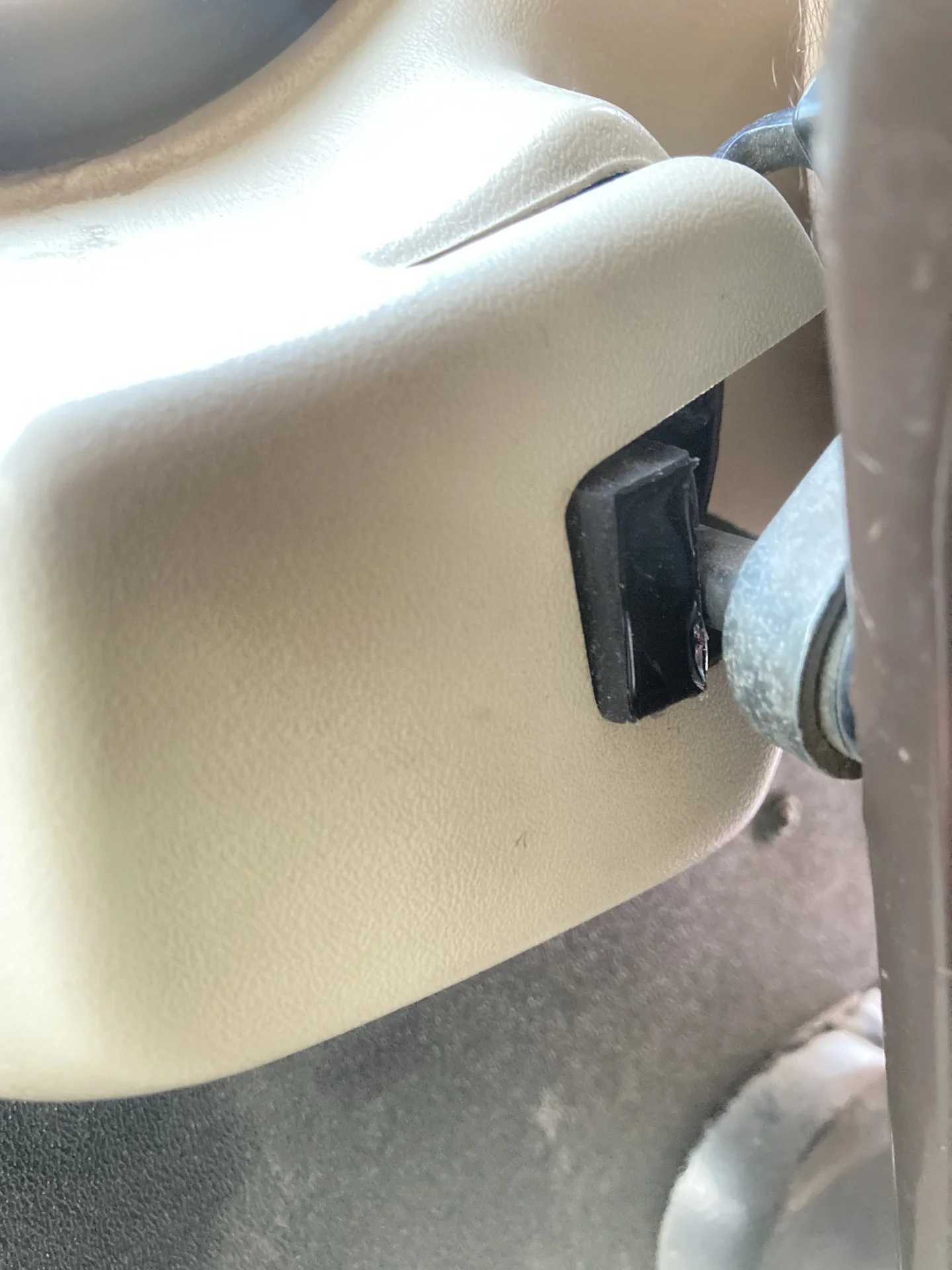

Update: Cast some test rubber pieces. They fit, but it ain't easy. Just like the originals, the slip over a metal prong and two wing pieces bend to fit behind some metal rails. These might be stiffer than the original, which is ok - I want them to last. Anyway, I drove to the grocery store and back earlier and the rear seat was dead quiet. That's what we want, right?
The only two issues I have now are that I'm unhappy with the texture of the surface and I need to scale up my molds for quantity They 100% work as intended but aren't up to my standards in the looks department. I'm going to sleep on that before deciding a next step.

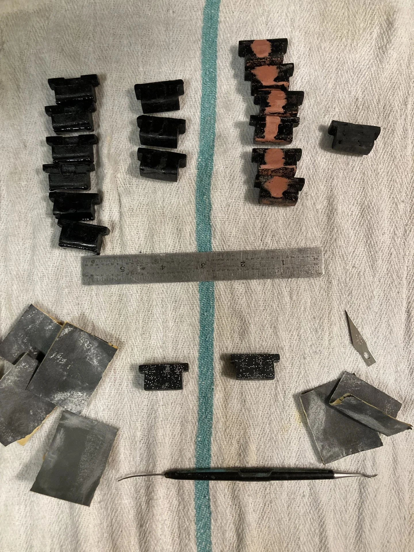

Update: Got a path to production-quality pieces now. I went through all the bumpers and found two that were aesthetically ok. There were even 8 more beyond what's pictures that I threw away already. I spent a couple hours sanding them by hand - the resin cures extremely hard. I think these two are as close to perfect as I can get.
Next I'll mold these two (what generation am I on anyway???) and cast a bunch of hard resin copies. When I have a handful of those - maybe 10-14 - I'll mold all of them at once so I have a single mold that can produce in quantity. The urethan rubber has a de-mold time of 4 hours, so casting a pair at a time wouldn't be very efficient.

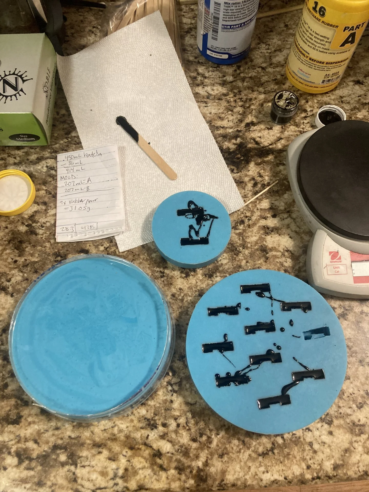

1st commercial batch of the final urethane rubber pieces poured. It looks pretty messy because this stuff has a 6 minute pot life - gotta pour quick.
I've got that 2nd mold ready for more in about 15 minutes.
