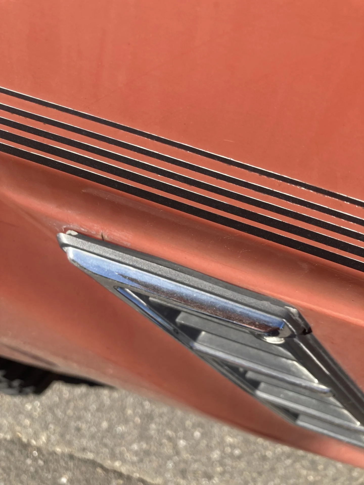

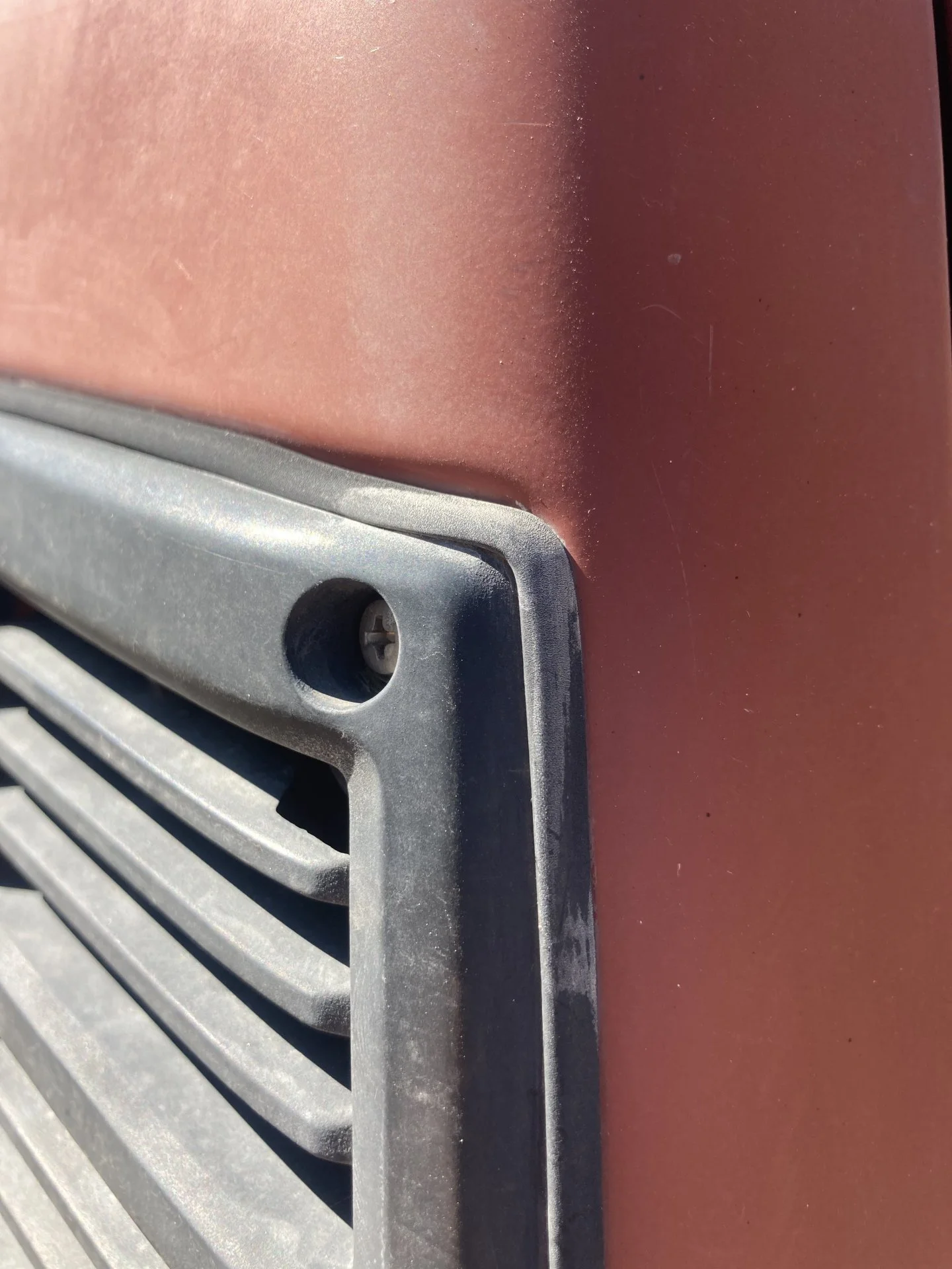

Photos of vent gaskets showing the lip. My rear left isn't so bad, but the front one has shrunk on the left side of the photo, you can see how it's now completely behind the vent.
And yes, my truck has a crappy single-stage repaint that has faded to a color I call "tomato". At least they took the time to put some aftermarket stripes over it 🙄

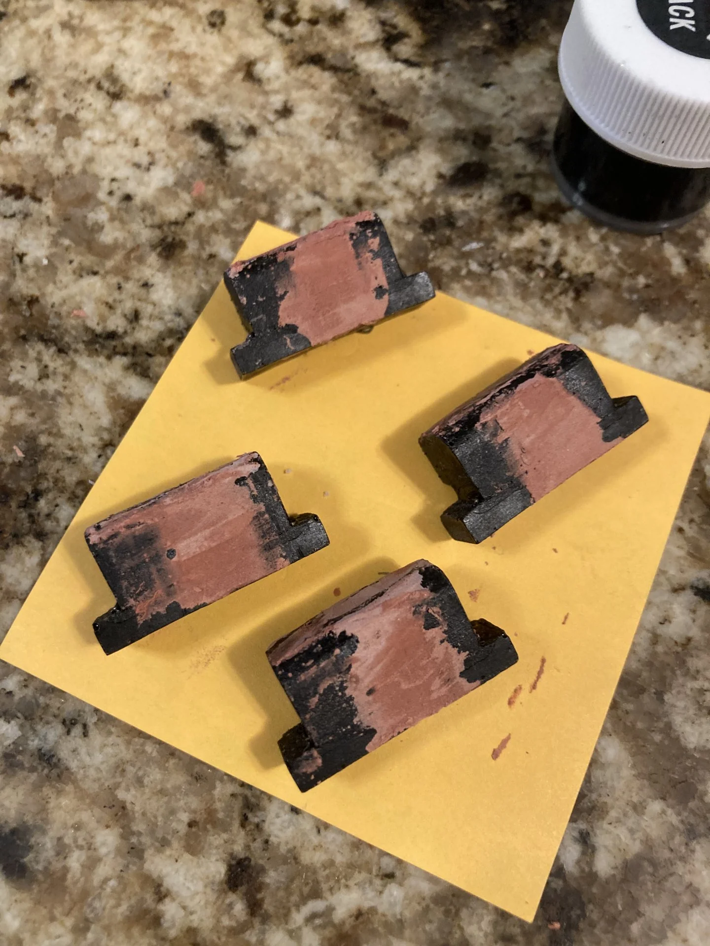

Four 1st gen hard resin clones bondo'd. The originals had a small groove/indentation worn in them from the seat post. These need a final sand yet and I have two more that need bondo from start to finish, but once I have 6 total I'll make a mold of those "corrected" bumpers. From there I can cast 6 more perfect ones, then mold all 12 of them. That will give me a mold I feel comfortable producing with. I will probably cast a pair of urethane rubber bumpers tonight and stick them in my truck for some testing.

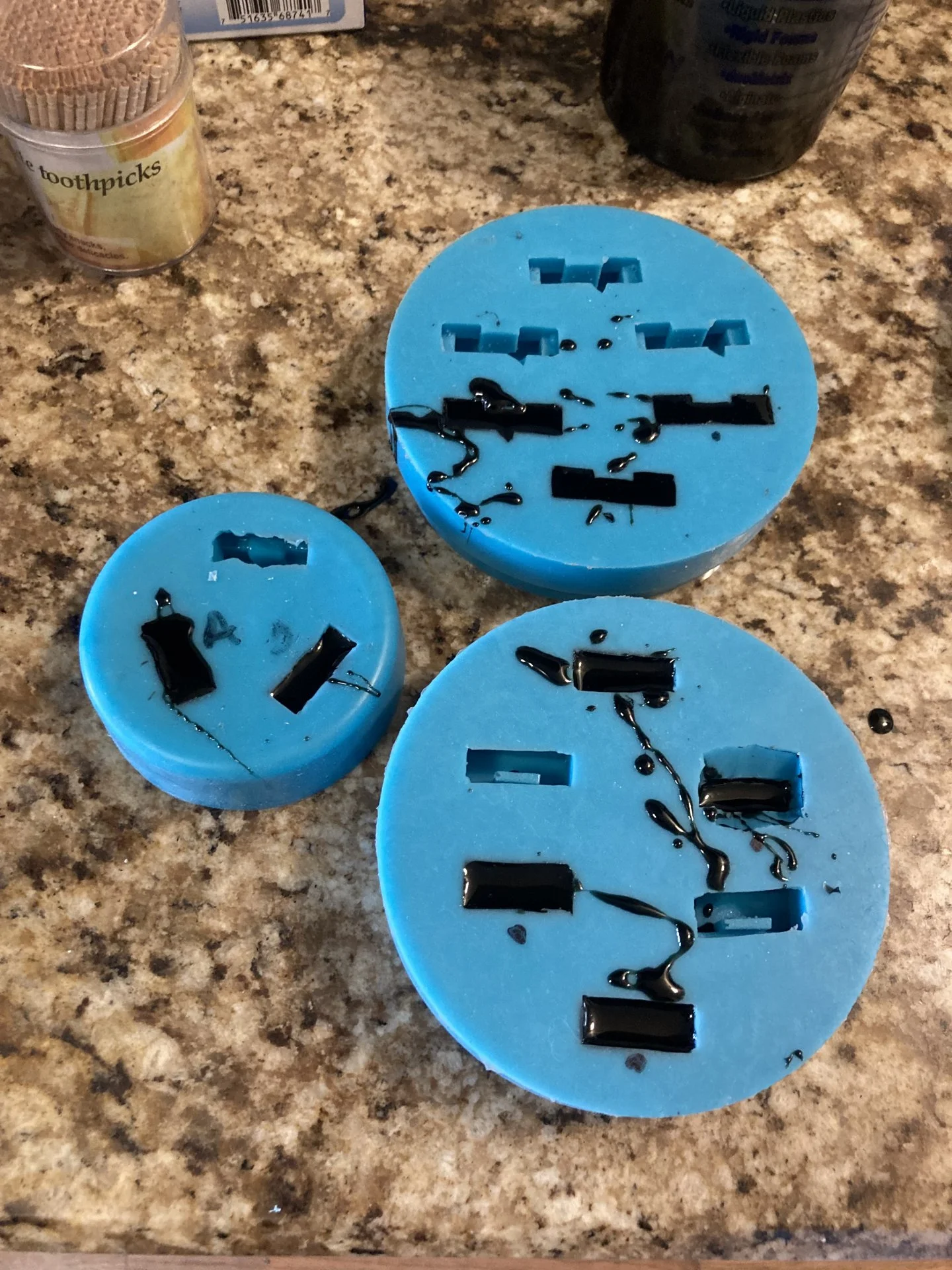

Cast some test pieces of rubber yesterday - one each of the two products I have. One is definitely harder than the other. I think the softer one will wiggle into place better (and it feels almost exactle like the OEM bumper), but it cuts easier with a knife,
so that worries me. I'll throw them in my truck this afternoon and see how they do.
I also poured a small batch of the soft rubber this morning to see how the new molds look. I did a test with the hard resin and you can see imperfections from where the bondo was molded. 99% of folks probably wouldn't care, but I'm a bit of a perfectionist and it bothers me. In a few hours we'll find out if the rubber casts any different than the resin - likely not.
