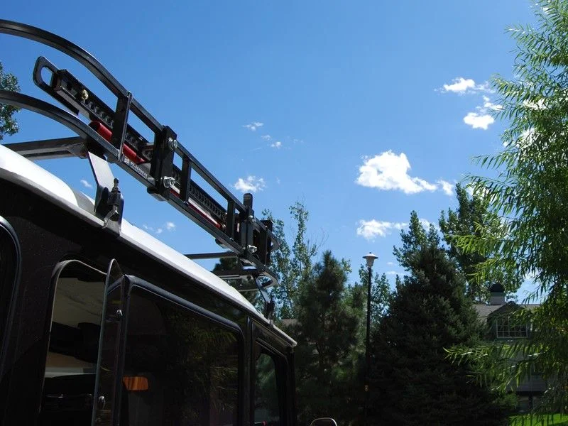

The other day I bought a set of Hi-lift jack mounts to put on my Con-fer rack, the problem is I am in the process of completing the brackets to make them work with my rack and I am not sure where to mount it. I am thinking of putting the jack on the back of the rack but I was thinking that there would be too much weight on the rear. If i was to put it on the side of the rack I wouldnt be able to put an awning on my cruiser because the other side has my shovel mount on it. I know its kind of a lame question but I really don't know where to put it.

inside the rack
If you have a full size rack, and the 60" hi-lift, mount it inside the rack.

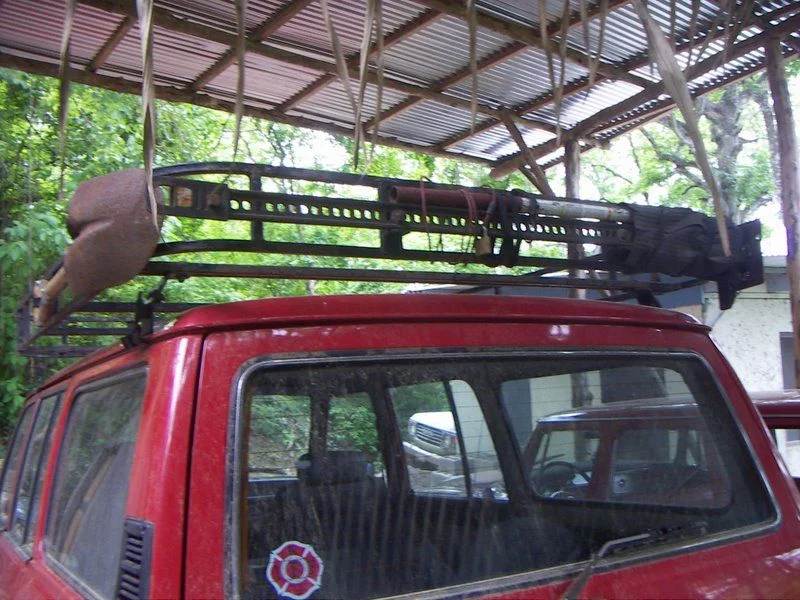

I have a 40 and the 48" and it's mounted on the inside of the rack, foot forward. Just by chance, I put it in that way but while attending a Toyota Trails Team Clinic, I think I remember that's how they recommend mounting a hi-lift on a roof rack, if you can. Makes it a little less likely to catch on stuff..... and in the event the brackets fail, it would typically and hopefully land IN the rack. Not go crashing off your cruiser.
pics of 40.
Thanks Cardinal, I think I'll go with that setup.:cheers:
