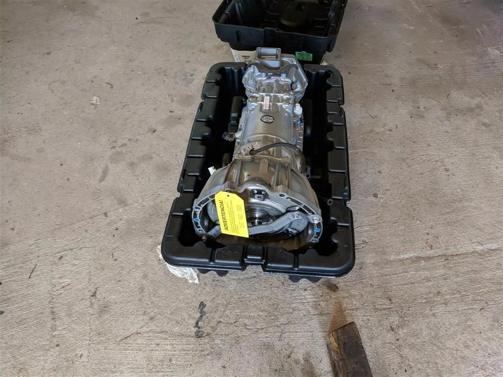

Toyota re-manufactured is complete from front to back including torque converter. Only things to move over are neutral position sensor/shift linkage and transfer case lever which attaches to the top rear of the unit...and a couple of wire clip holders...

That picture is clutch, I've been talking to the dealer about what exactly is needed to get my core charge and was wondering if I could fit the box in my tsx wagon and it looks like it'll be fine. the last open question with them will be if there Toyota paperwork will accept a Lexus vin because. Of course the Toyota dealership 10 miles away is 700 cheaper then the Lexus dealership
