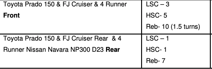

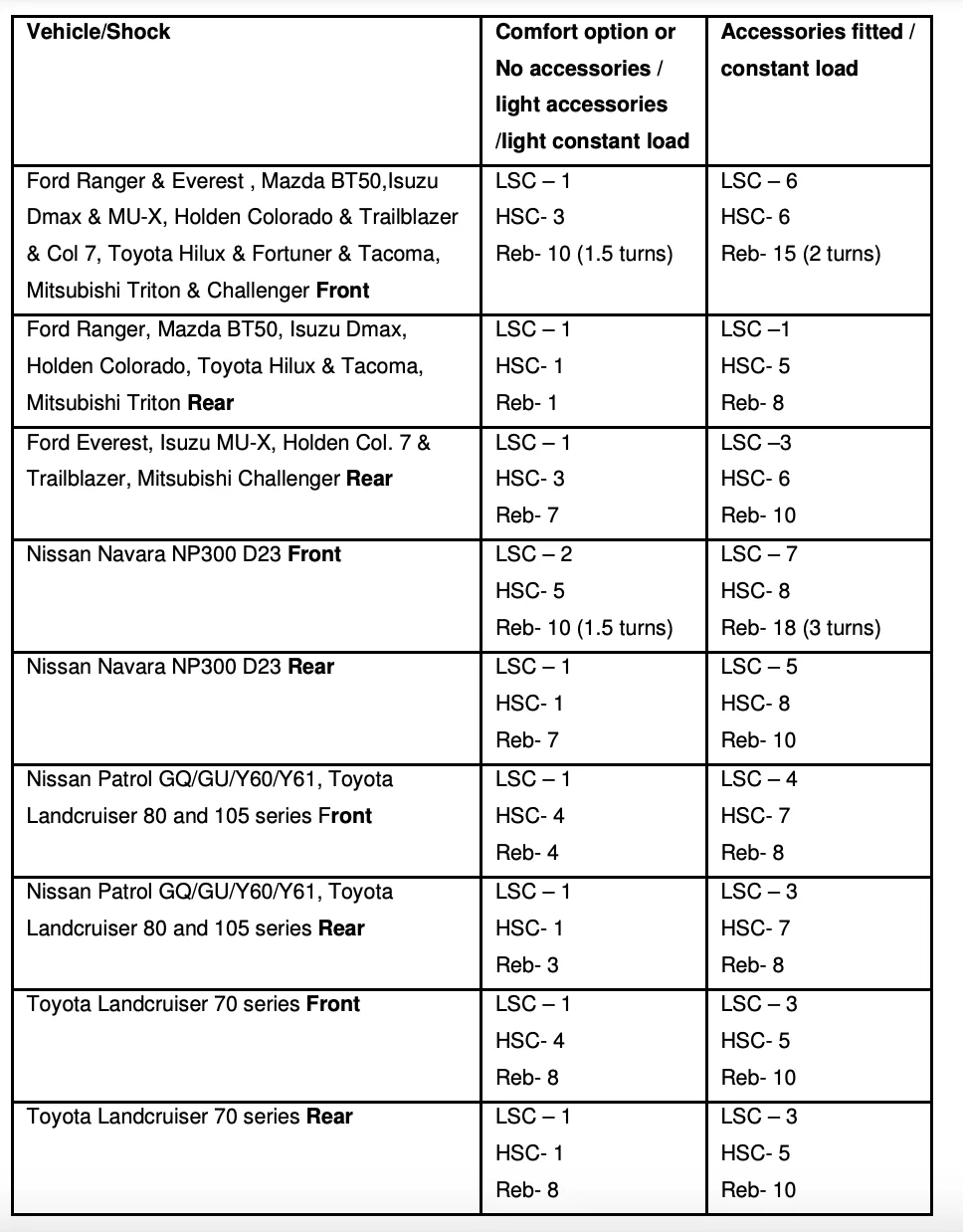

Just installed the MRR over the weekend. What setting is everyone currently running? LSC / HSC / Rebound
-currently no accessories right now
I see some recommendation in Dobinsons instruction: So I would assume below:
I'd start with the Patrol/LC105 settings for a GX out of that list and go from there. Tune rebound based on slow speed bumps (should rise with bump, squat after bump, and return to ride height without overshooting or going for a 2nd/3rd/4th bounce). Tune compression based on your preferences.
Thank you!
I saw the PRADO 150 setup as well so I'll give it a try:
